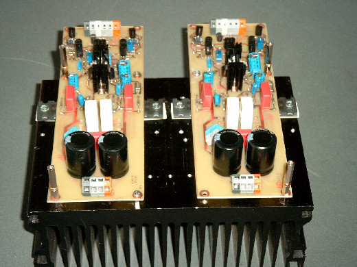

Do I guess well when I assume that the circuit is fully symmetrical ?
How good is load-depandant stability ?

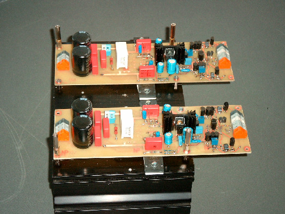

Nice work. For those of you who don't know: Sonny's connectors is really esoteric.😱 😱 😱
It's Wago!
With these connectors you will get almost tube sound. I use them also but model 255 and 256 with levers. You know I'm kidding? But Wago is really good in industrial environment.
Sonny, have you tested yet to use "current gain" in the current mirrors?

i have not tested it on a speaker yet. but into capacitive load i works fine. we will do it later today.
And yes it is symetrical... almost all modern Current feedback design is symetrical.
Sonny

no have not have the time yet. I have raised the degeneration resistor in the mirror from 100R to 221R which gave me lower DC-drift
Sonny, this amplifier looks really nice! 🙂
Did You plan by Yourself?

sonnya said:and the last one.
Well done Sonnya! I like the color coded connectors, they show you really did pay attention to the details. QA people love this, it decreases chances of errors.
Did you already publish the schematics? I might have missed them.

Thanks, it is a lot easer not to make any mistakes.
No i haven't not before all tests have finished. including listening tests..

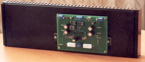

With a 2 * 30VAC / 300VA i get +/-43VDC.
I should be able atleast swing to around 38Vpeak so ...
~90W/8 Ohm...
~160W/4 Ohm..
I changed the compensation caps from 2*47pF -> 2*100pF in the gain node...
After this i was able to remove compensationcaps in the CFP outputstage.
Right now it goes from 1.3Hz to 250KHz (-3dB)...
The DC offset is drifting within +/10mV from the setpoint.
Sound!
The mids and highs are very detailed. Especially on voices and high-hats.

Sonny, have you tested any nasty loads for example 100 nF//8 ohms or even worse 1 uF//8 ohms?
P-A,
if I can reply, I do these tests. Not only values you have mentioned, but also caps of 1.5nF, 6.8nF, 15nF, 33nF and your values (100nF, 1uF) and 3.3uF. It is interesting that some designs may have problems for example with 15nF // 8 Ohms combination. I also recommend to check the stability into dummy loudspeaker load.
I have found very helpful to place Zobel (Boucherot) network of some 4.7 Ohms in series with some 22nF directly to the loudspeaker terminals of the power amplifier.
