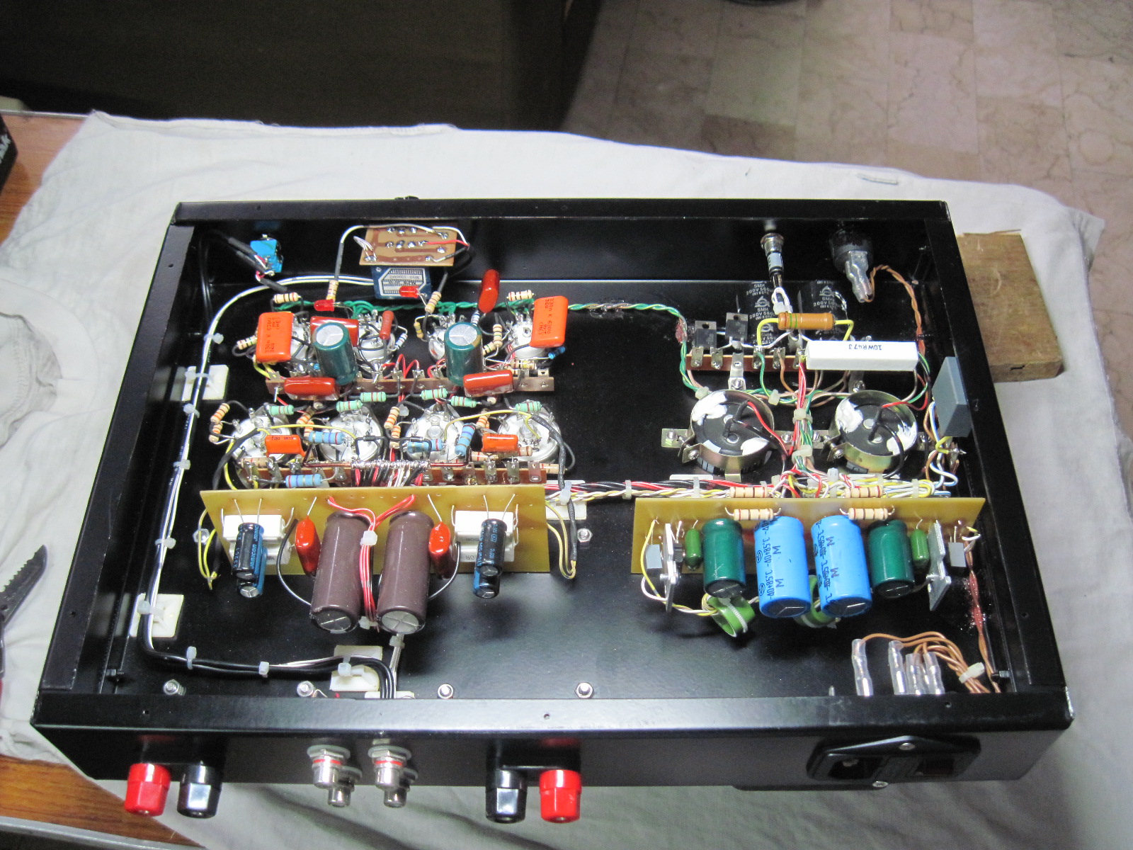

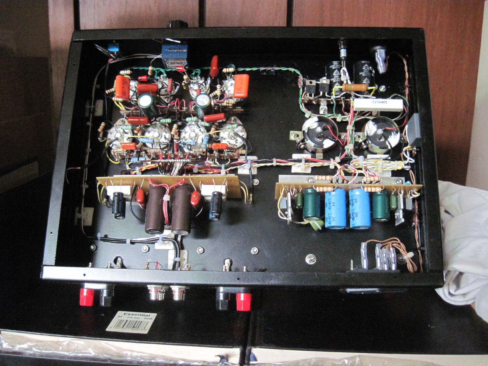

Tony,
Looks great!
And I like your pcb to mount the individual self bias resistors and bypass caps on.
That is what I see in the picture, Right?

yes individual cathodes with individual resistors and bypass caps, 250v plate and 30ma cathodes...on the left hand side of the picture...
the board on the right hand side are dc filament supplies...
