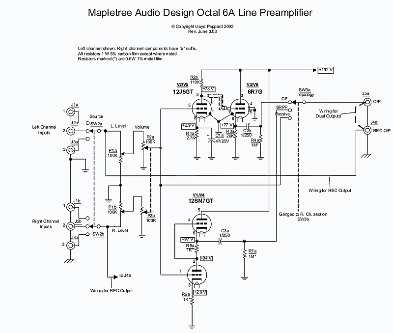

in providing switching between a classic common cathode-cathode follower cascade (CF) and a shunt-regulated push-pull (SRPP) circuit (it also has a passive path) in the one circuit, is there anything about this circuit that would reduce transparency/ transient response etc, over separate CF and SRPP circuits?
Any advice appreciated
If you use a good switch or relays, nothing that you'd hear response wise. Though unless you use a multiple deck rotary (expensive) or relays (cheaper), stereo seperation can suffer.

No, not really, save for some minute capacitive coupling in switch SW3 and sharing a common PS. And also combining the miller input 'C' of the two separate stages, esp the CF coupled stage, minute or not as it may be. Some may have a problem with all those nasty, dirty switches in the signal path. 🙂
Me thinks this was designed to compare CF & SRPP. The passive will have some HF attenuation because of the 100k level and volume pots, depending on their settings and your interconnects of course!
Wayne
