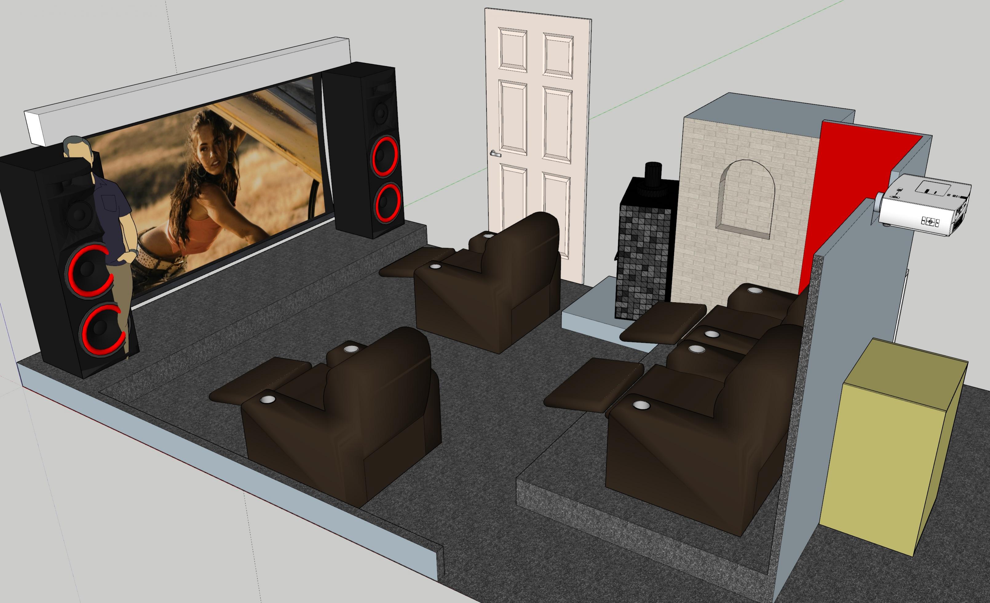

Good questions! And sorry for my maybe bad english.
The purpose is mainly to be the sub in a home movie system.
Front speakers will be my Cerwin Vega 1215´s so i´m thinking the 189sc will continue to dig where the 1215:s no longer perform their best. Maybe only below ~100-150Hz, how does that sound?
How big would a tapped horn have to be?
See my sketch for the room. I have space behind the wall..

What F3 would you want and how much sensitivity are you looking for? That will dictate enclosure size.
What would be best suitable with the spec?
Placement would be as the sketch, behind the wall.
I´m thinking of a crossover frequency between the 189SC and the Front 1215 at maybe 100Hz. The 1215 goes from 24Hz alone, but i want to let the 189SC take care of that..
So F3 "as low as possible" would be nice i guess?

Of COURSE that would be nice. The problem is that you can't dictate one spec like that. F3 can be shifted very low, but then the problem is both enclosure volume and sensitivity take a nose dive, as well as possibly mechanical power-handling (all things equal, halving the F3 necessitates 4x the excursion from the driver, relatively speaking). Specify one actual F3 number, and set a limit for the other one (either maximum enclosure size OR minimum acceptable 2.83V sensitivity), and then the remaining variable will be accounted for as a compromise, and I am more than willing to help. Otherwise it's a waste of my and your time.
I haven´t made any measurements of the room characteristics. The "only" things i have is the data in this thread from the 189SC, the spec of the 1215, and thought of where i want to cross over. And a wish to build a box for the 189SC that digs "as deep as practically possible".
Theroretically there is no maximum enclosure size since there is a whole room behind the wall that i´m going to build.
But if the numbers, ideas or data than what i have said in this thread so if that is not enough for some examples or ideas we´ll let it go and i´ll just go trial and error! 🙂
