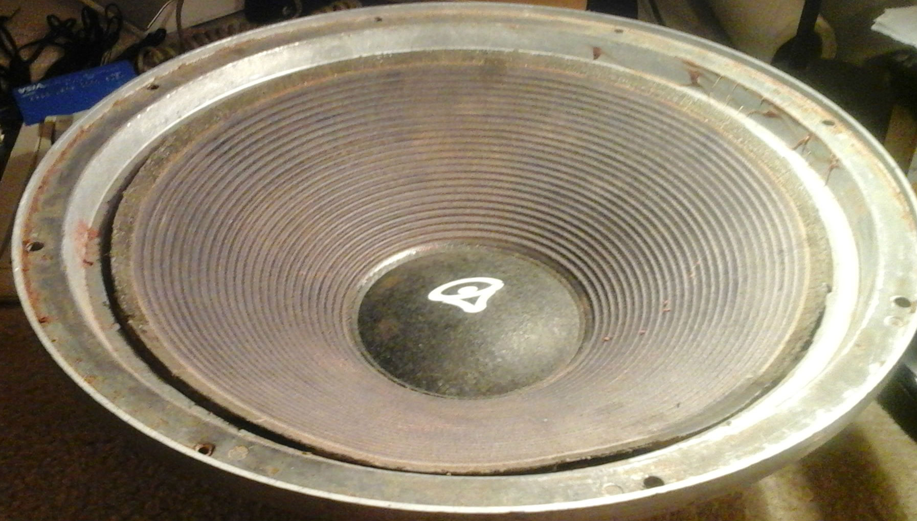

I have a Cerwin Vega 15 ATW speaker and before re-foaming it, I find that the cone SNAPS to the bottom. The other one does not, and the re-foaming went very good.
I can lift it up, but when I let it go, it Snaps completely to the bottom, as if the magnet is pulling it hard. The other one did not do this and stayed centered.
Any suggestions before I buy a re-coning Kit.

this still doesnt explain why it "snaps down" however.

I did the other speaker, I refoamed it. It the other speaker came out just fine, but it did not act at all like this one. It is like there is a ferrous piece of metal is attached to the cone. I do not see any damage to the speaker.
There are three screw on the back of the magnet, would removing them possible shed some light on the voice coil and such?
