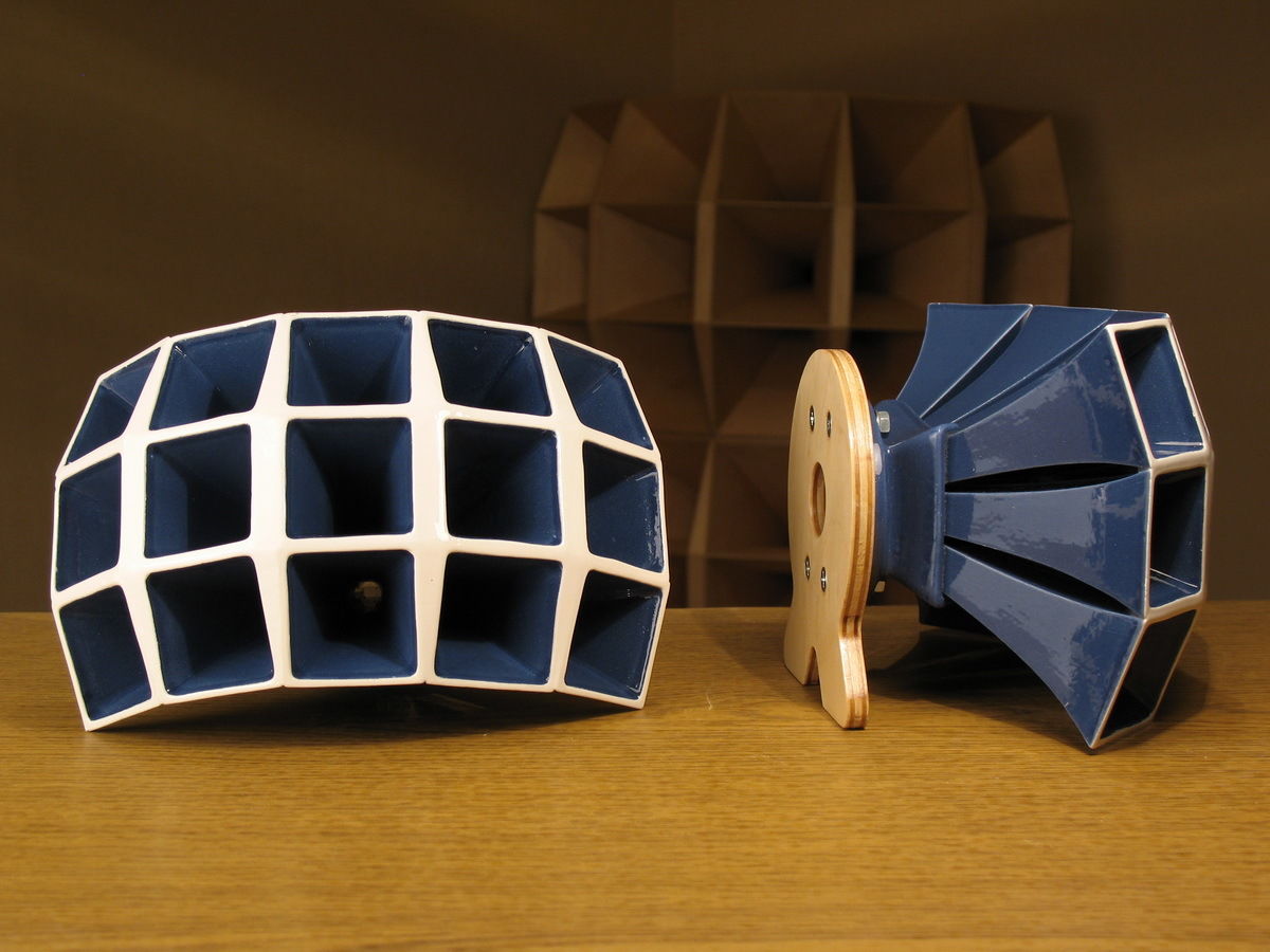

Recently I bought these ceramic multicell horns, they come with the specification of
Cutoff frequency 1600Hz
and Xover 3200Hz
They can be connected to with 1” compression drivers.
I am brand new at this I appreciate all the help.
Which compressor driver best fit this horns(frequency response should have) and what is the best working point.
Thanks for the help

That is way cool. A ceramic-China bisque like multicellular horn!
Where did you buy this?
Pick your favorite 1in 2/3-bolt flange mount Cd - just about any can be crossed that high up no problem.
I have a PRV D280Ti and like it very much. Great smooth sound and well priced.

I Thanks for replying!
I bought them on ebay.
Cutoff frequency at 1600Hz it means the lower part of the frequency response
as it said to be Xover at 3200Hz is the region where the horn best responds
am I seeing this correctly?

The best xover frequency may depend on your woofer. If you have a low frequency driver that will play high enough, a 3200 hz crossover might be a good idea because it will put the crossover outside of the vocal range.
If the low frequency driver dies before 1600hz, push the crossover down. It depends on the overall setup.
I think the best approach is the first, Get a cone driver that is almost a full range by itself, then use the horn to extend the HF past what the cone can do, as a great tweeter. This approach doesn't require much calculation and filter technology if the drivers are really good to start out with.
A single cap floating the tweeter in up high above a full range 12" or similar can sound really fine and this is a common DIY arrangement.

Typically, if a horn extends to a certain frequency, in this case 1600Hz, a good practice is to set the XO at least an octave above so you get a smooth response in the stop band.
With steep XO's (4th order and higher) you can get much closer, like 2kHz even. But it also depends on how high up your mid or woofer is going.

In fact, I do not have a woofer yet but,
I'm looking for a two-way system high efficiency speakers
Any suggestions for a good full range 12” driver.
With a 1600 Hz cutoff/3200 Hz XO 2nd order, a ~6" wide BW mid-bass driver with a ~127 Hz Fs and usable to >6400 Hz would be my choice.
You could try an 8"/~87 Hz Fs, 2200 Hz/4th XO, but may sound too harsh at higher power or even damage the HF's diaphragm.

I will build a 3-way system, but must be effective above 98..dB
for the middle range I'll opt for the Fostex D1405.
But for the Woofer I need a good suggestion in the range of 10” to 12” 98..dB 50Hz to 3500Hz...

3,500 for a hi efficiecy woofer is asking alot. What about a fostex 8" ff or fe207? Then use a sub or 4 way.

I think you're right 3,500 is probably asking too much, as I will use the compression driver from Fostex D1405, I can come down as low as 845Hz.
Is any good hi efficiency woofer that I can use for this range let's say, 50Hz to 1kHz?
I liked if possible to keep a 3 Way configuration
