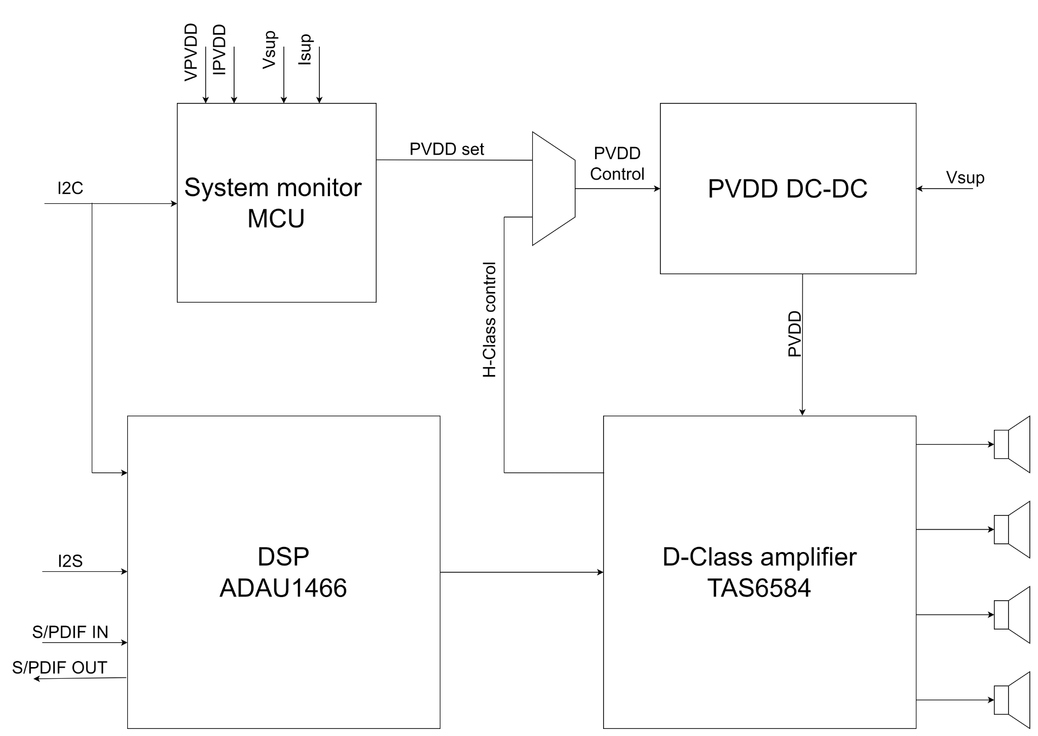

Structure of Centure 24:
The structure of new version is quite similar to previous one: there is DC-DC for output stages, a DSP chip and MCU to control and monitor the system. The main difference is in more advanced diagnostic and monitoring of the sysem, thanks to TAS6584. Also since TAS6584 implement H-Class control together with the DC-DC, this fetature is also available and can be enabled/disabled via software. Here is demo from TI: https://www.ti.com/video/6287333584001

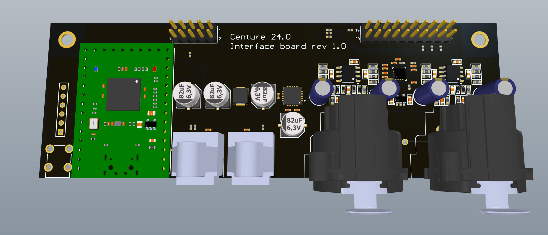

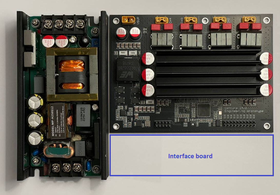

This time the module designed such that it can be also used as the plate amp: all the interfaces (S/PDIF, I2S, I2C) are routed to headers and supposed to be connected to interface board (which is not ready yet):
The amplifier has 4 channels which can be configured as 4xBTL, 2XBTL + PBTL or 2xPBTL. So it allows fleaxible configuration for multiway systems. The nominal output power would be around 200W for all channels combined, the peak power of course would be higher. Not all measurements are done, only up to 100W/channel.

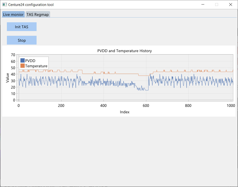

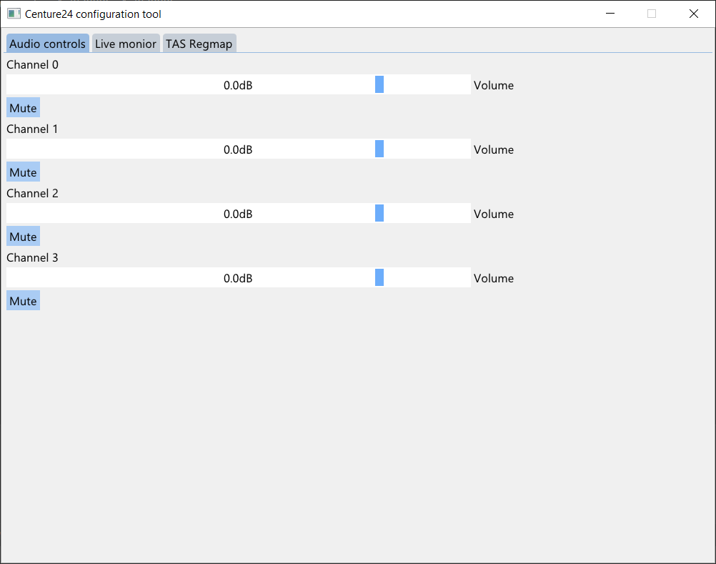

There is also software development going on which is based on the York interface (thread on DIYaudio: https://www.diyaudio.com/community/...tichannel-input-output-interface-york.413504/)
Live monitor of Class-H operation:
