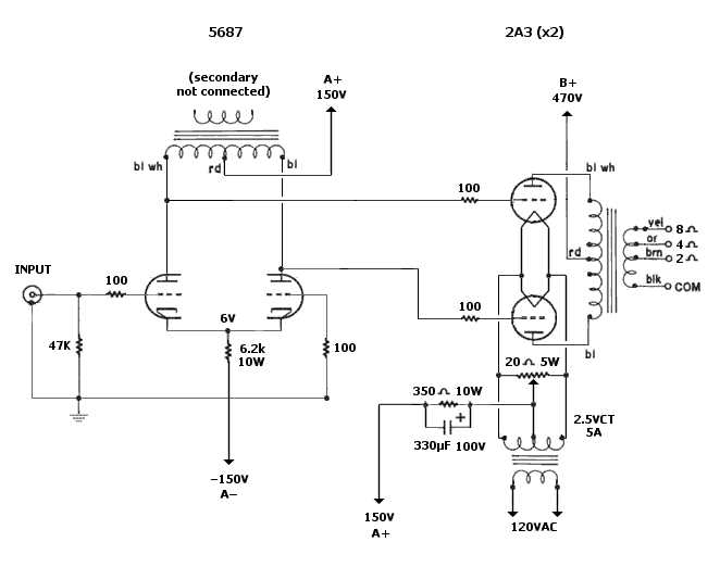

There used to be a choke made by Tango, the TC-160-15W (http://www.tubebooks.org/file_downloads/tango_tamura/Tango_TC-160-15W.pdf), which had a winding inductance of 160H at 15mA, with a center-tap. Some folks liked to use it as a push-pull plate choke, as the plate load for a long-tailed pair phase splitter/driver stage. The idea was to be able to DC-couple the LTP plates to the output stage grids. The plate choke doesn't drop much voltage, so the plate voltage to the LTP stage is very close to the cathode voltage of the output stage. A stacked power supply can then be used with a cathode bias resistor to develop the bias for the outputs.
But I never had nearly enough money to buy one of those back when they were available.
Instead of the pricey Tango choke, I used a mystery-model push-pull OPT that was designed for PP EL84's, in the plates of an LTP using 5687 (later changed to a 6N6P). This stage drives a pair of 2A3. The amp works very well, sounds nice. If I use a 12BH7A instead, I notice that the bass response is lost. Obviously the plate resistance of the 12BH7A is too high for the primary inductance of my mystery OPT-as-plate-choke. But the bass extension measures well when used with a 5687, so the primary inductance has to be 30H or so. I'd like to improve on that.
So, I have a question. If I wanted to use an OPT as a poor man's center-tapped plate choke, what specifications would I look for? Highest primary impedance possible? All other things (like bandwidth at a certain signal level) being equal, does a 16k:4 ohm OPT have higher primary inductance than a 10k:4 ohm OPT? I suspect the answer will be complicated, but I'm hoping it's a simple 'higher Z primary = higher L primary for the same secondary (and load) Z at the same signal levels.'

It says that for the LL1667 the max standing current for full bandwidth is 15mA. That's comparable to the Tango TC-160-15W. Does that mean a max of 15mA out-of-balance current is allowed, or that the plate current for the two triodes used would have to be no more than 7.5mA each?
That would be max unbalanced current in P-P.
I'm using one for SE. The datasheet doesn't show it, but there's also a 5mA version (I'm using that with ~3-4mA SE). Gapped for 5mA, it has some absurdly high inductance (700H!) and very wide bandwidth.
Pete
There's also a "PP" version of the LL1667, which has a higher inductance yet, but will require better balance (about 2.5mA) even than the 5mA gapped version. I normally stock the PP, 5mA, and 15mA versions, but don't have the 5mA at the moment.

I wonder... It seems to me that using a tube with higher rp and mu, like 12AT7 for example, you'll have less plate current, maybe about 2 or 3mA per triode. At that kind of plate current drawn through the CT choke, how much imbalance can there possibly be?
The choke would need higher inductance to get the same f3 at low frequency, but the upside would be the higher gain possible from the higher mu/higher rp tube.
So, how much standing current from imbalance can something like a 12AT7 possibly cause in the coils of the CT plate choke?
If each triode is only drawing 3mA, then the max offset is one tube conducting 6mA and the other 0mA. That would only happen if there was a wiring mistake or one triode was dead, so it's not really a concern. I would imagine that dual triodes with a mismatch of 2mA in one and 4mA in the other under identical bias conditions might be a worse case.
