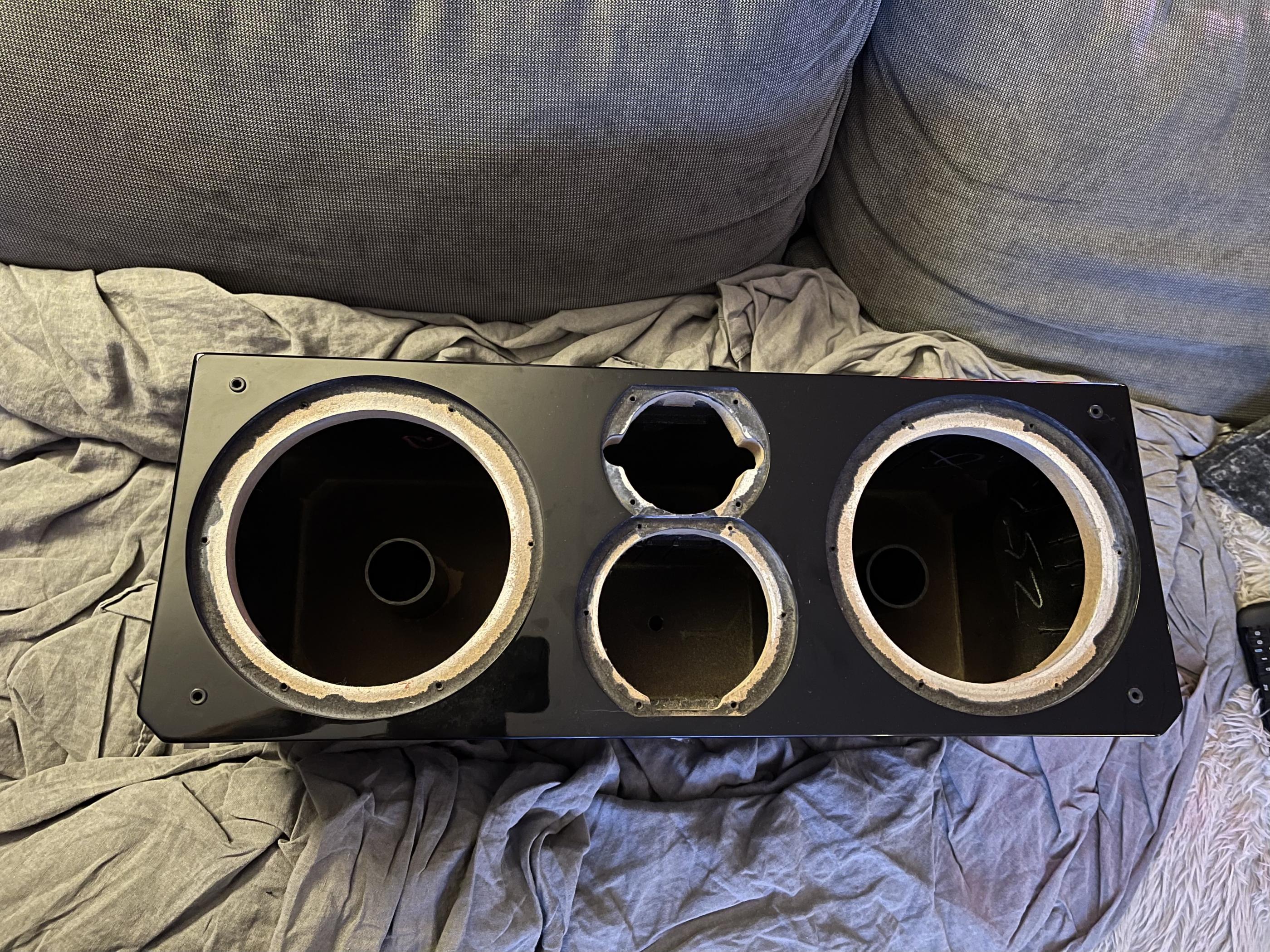

I have this center and was curious if I could run one woofer as a mid and the far other side woofer as the woofer. Crossed to a larger planar or ribbon tweeter 8” or under.
This current center used the same 6.5”
Woofers, a 4” midrange and a metal dome tweeter.
Has anyone ever made a center channel with one one of the woofers running the mids?
Would this work better then the current setup? I really wanted a better tweeter and these woofers are pretty cable of both bass and midrange.
The midrange is this same speaker but the 4” version.

You can do a 2.5-way. I did actually make a TM 2-way centre once. With the grille in place you couldn't tell what it was. That said, the layout in the pic is optimal. With the 4" mid the requirements for the tweeter can be relaxed because you can then use a higher crossover point than what you'd need with a 6.5".
