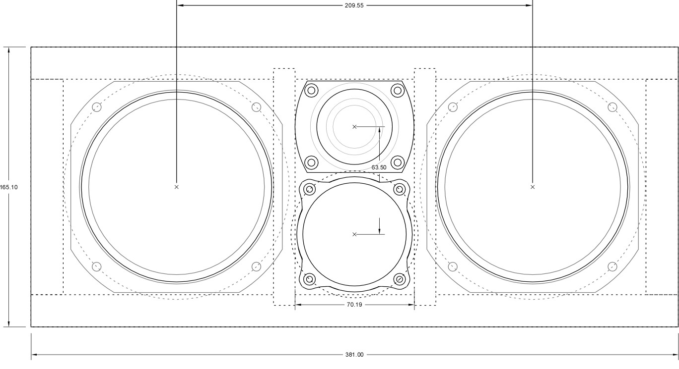

I'm about to test a bit myself with the TEBM46 for my center speaker, but I would like the resulting speaker to be symmetrical. This will also be personal taste, but I dislike center speakers that are super tall. So I'll be combining it with one or two DSA135-8 and matching PR.
I have two of those I considered using. I also have two peerless woofers rated at the same sensitivity.
So would it be safe to assume by adding a second woofer, one effectively ignores the baffle step loss? I wager there is more to it though, but it seems safe to take two 87db woofers, lose 6db to baffle loss, gain 6db from adding a second and end up back at 87db? I believe the philharmonitor bmr woofer is 88db.
I did consider keeping it simple and just having the BMR cover everything above whatever the woofers are doing, but the driver doesn't render the top end well IMO. I have an assortment of tweeters that would do a better job there and maintain close proximity to the mid. My current plan is to use the two peerless 6.5" woofers, tebm46, and a dayton td20f.

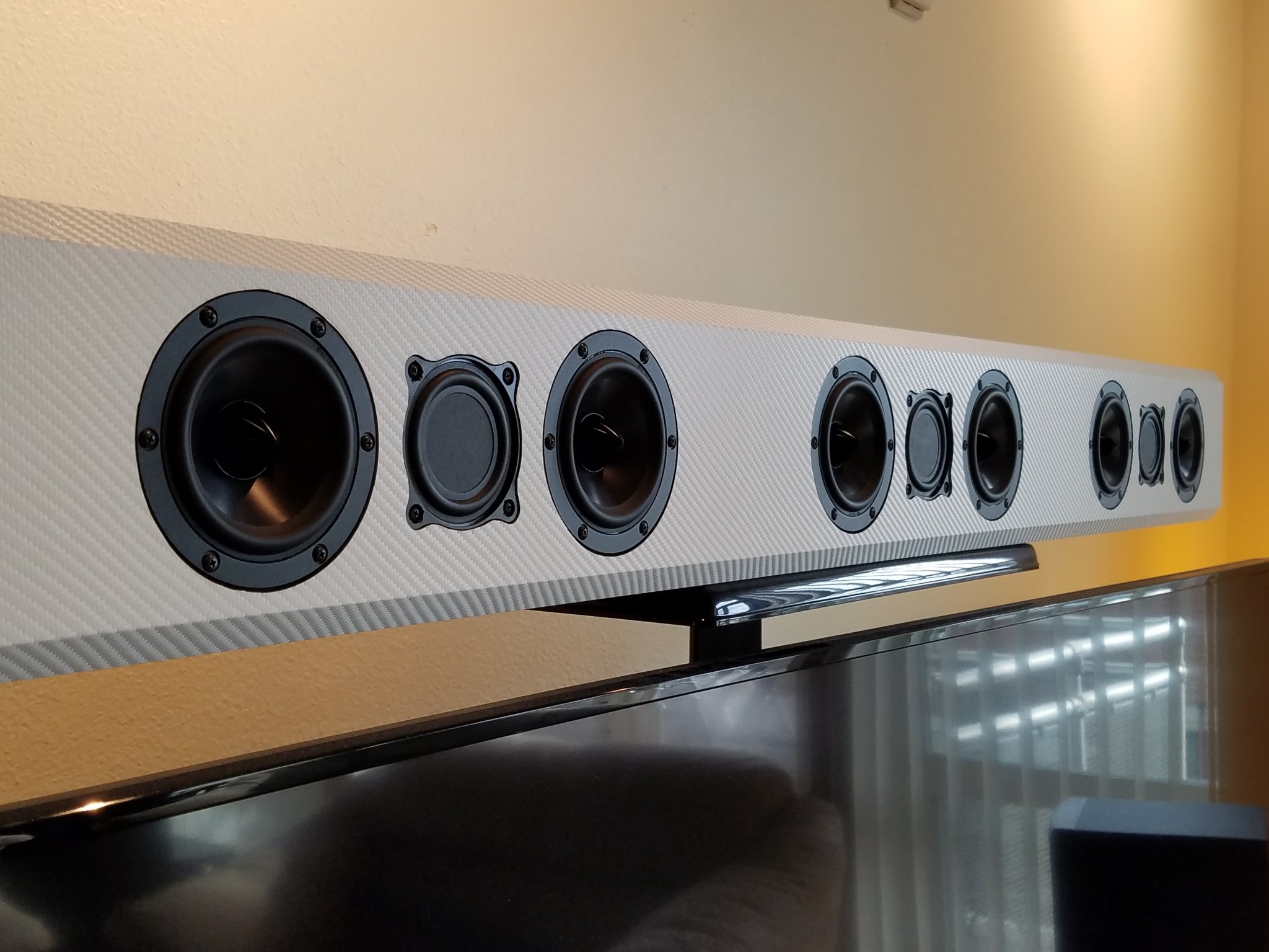

A pair of Dayton RS100-4 in series are a perfect match for the TEBM46 for center channel use. I attempted this as WMW, but as the OP found, the TEBM46 just doesn't have well-behaved treble. So I abandoned the project which was a bummer because I was working with someone on it. One note about my usage, I assumed the bar would be placed directly above or below a TV, and so I designed both a typical freeair version, and one where I placed a piece of cardboard the size of 55" TV below the speaker when measuring it. The latter obviously needed little baffle step correction, and it sounded right in listening compared to full BSC would sounds chesty.
