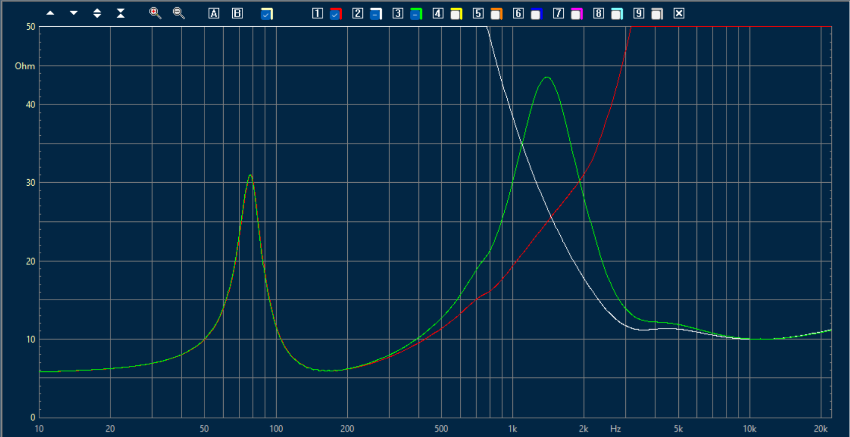

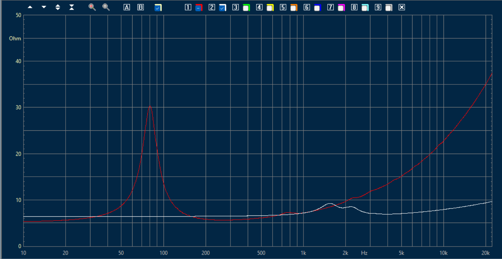

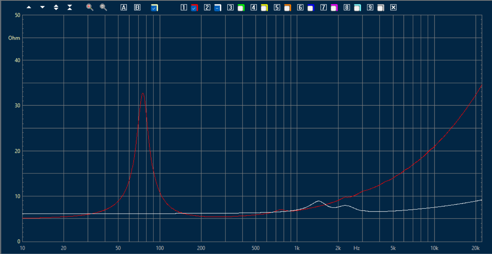

Some measurements of the speakers with and without crossover:
Celestion SL6s Spkr A impedance no xover red=woofer white=tweeter
Celestion SL6s Spkr B impedance no xover red=woofer white=tweeter

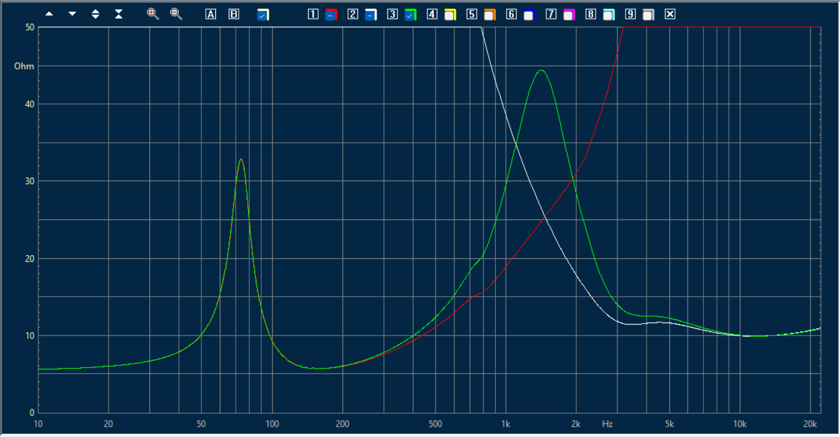

Celestion SL6s Spkr A impedance+xover red=woofer white=tweeter green=speaker.png
Celestion SL6s Spkr B impedance+xover red=woofer white=tweeter green=speaker.png

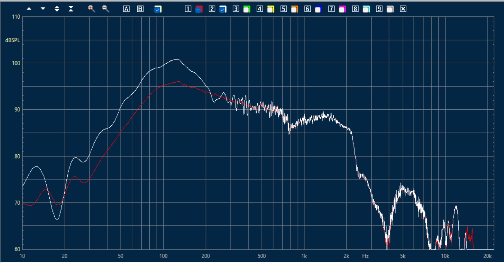

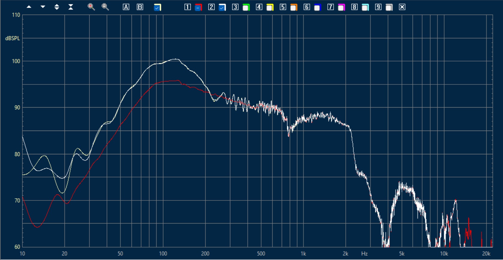

Low frequency nearfield measurement
Red = Mic in baffle plane
White = Mic nearfield, few mm from cone
Celestion SL6s A Low freq resp nearfield & baffle plane
Celestion SL6s B Low freq resp nearfield & baffle plane

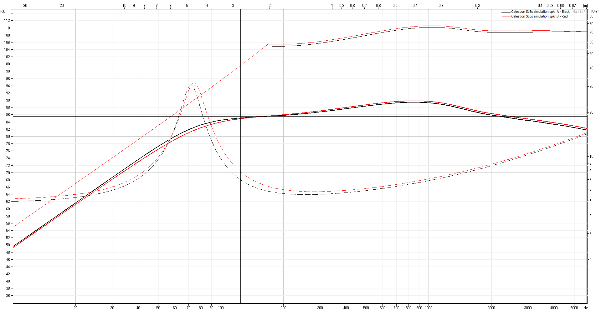

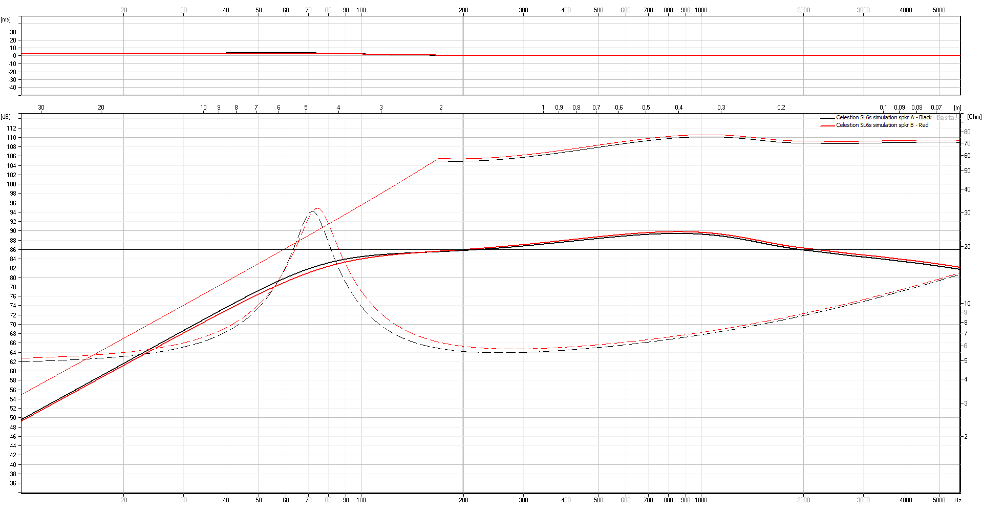

Simulations with Basta:
I made a set of simulations based on the measured woofer data, including the baffle response.
  • Closed box 10,9 liter
  • Damping fill 80%
  • Baffle 20x37cm
Basta simulation - spkr A&B freq response-impedance-max output with xover
Basta simulation - spkr A&B freq response-impedance-max output no xover

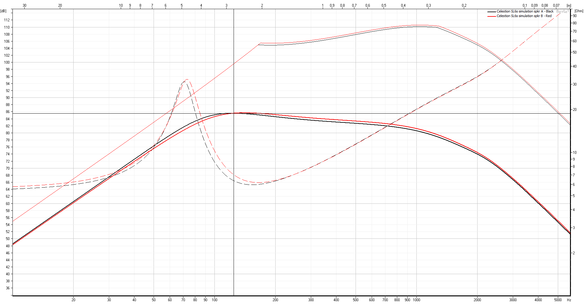

Basta spkr A&B freq response-impedance-max output-no xover - show group delay.png
Basta simulation - spkr A&B freq response-impedance-max output no xover - show group delay

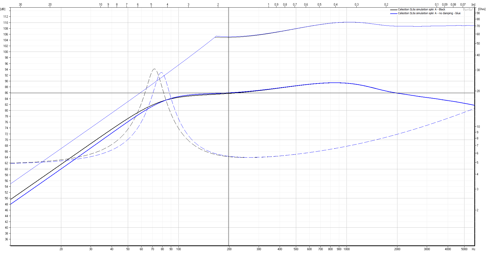

Basta spkr A freq response-impedance-max output-no xover - show effect of damping.png
Basta simulation - spkr A&B freq response-impedance-max output no xover - show effect of damping

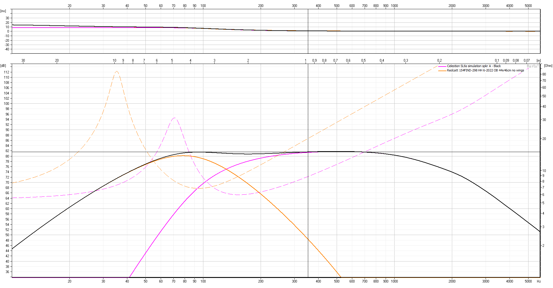

And just for fun a simulation of the Celstions with the OB sub (see Part I). Probably more a fantasy than a realistic simulation, but it shows that the combination is at least possible.
The OB sun woofer is a Redcatt 154FINDX8-298 15" woofer with TS data from the German Hobby Hifi magazine. Crossover is @120Hz, 24dB/oct Linkwitz-Riley.
