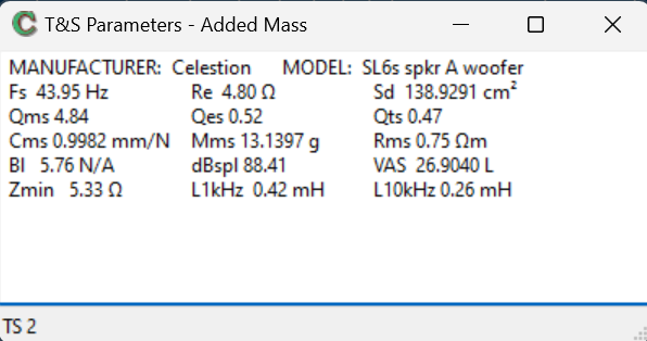

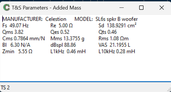

TS parameters of the Celestion SL6s woofers

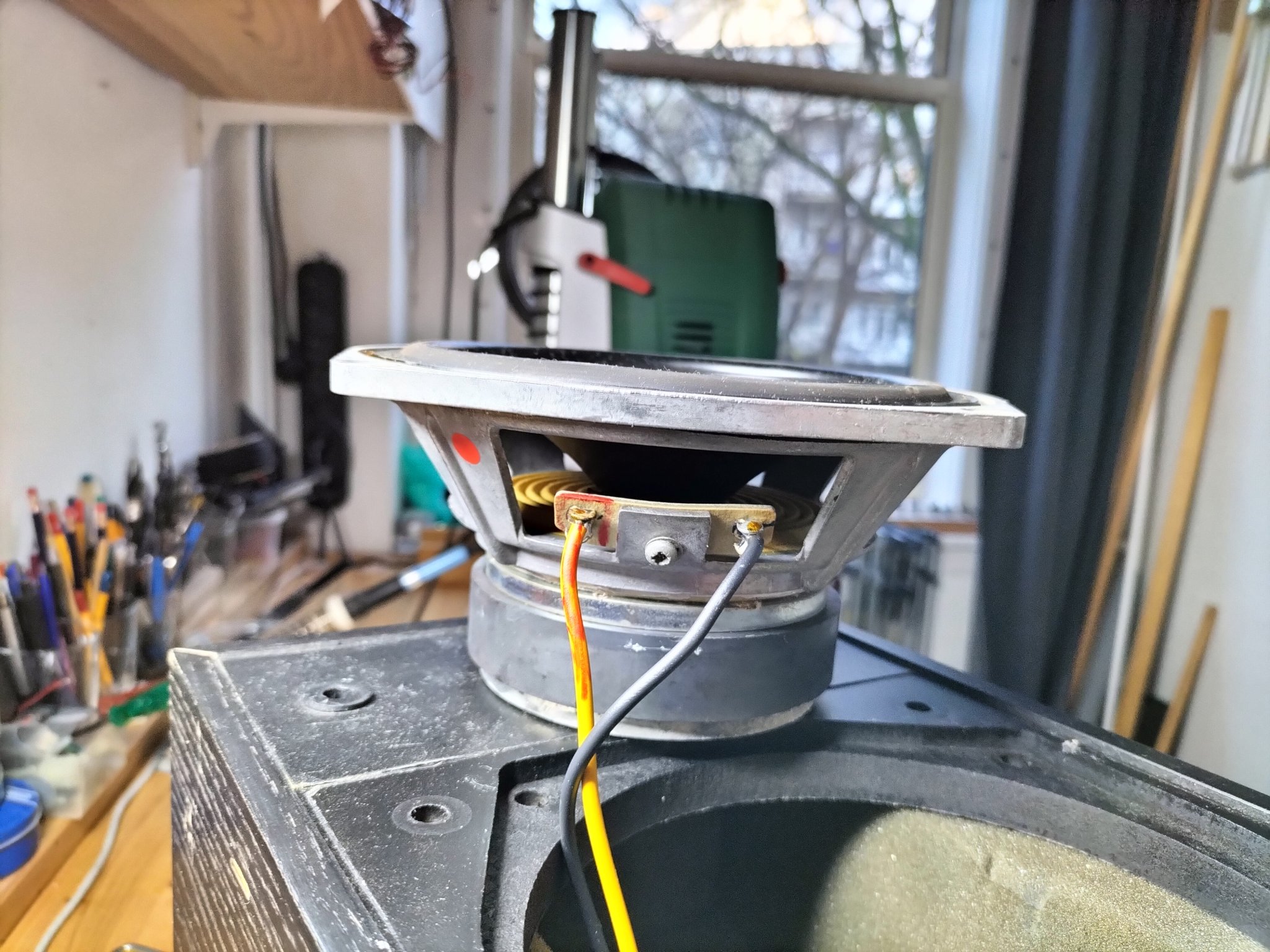

I measured the woofer driver TS parameters with the Clio Pocket. Before I did that I run the drivers for about 36hrs on a 15Hz signal at close to maximum excursion. Just out of curiosity I measured the impedance and TS parameters before and after burn in.
There is some difference between the two woofers, but what do you expect. They are about 40 years old.

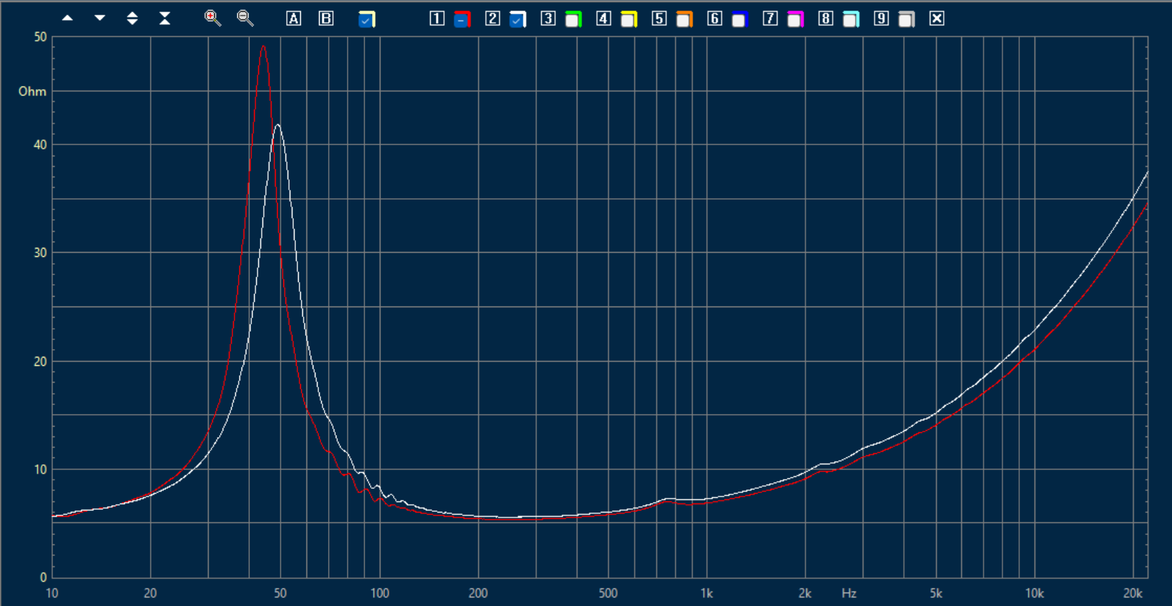

Impedance woofers A&B
Spkr B (only) woofer impedance response red=1volt white=3,46volt.

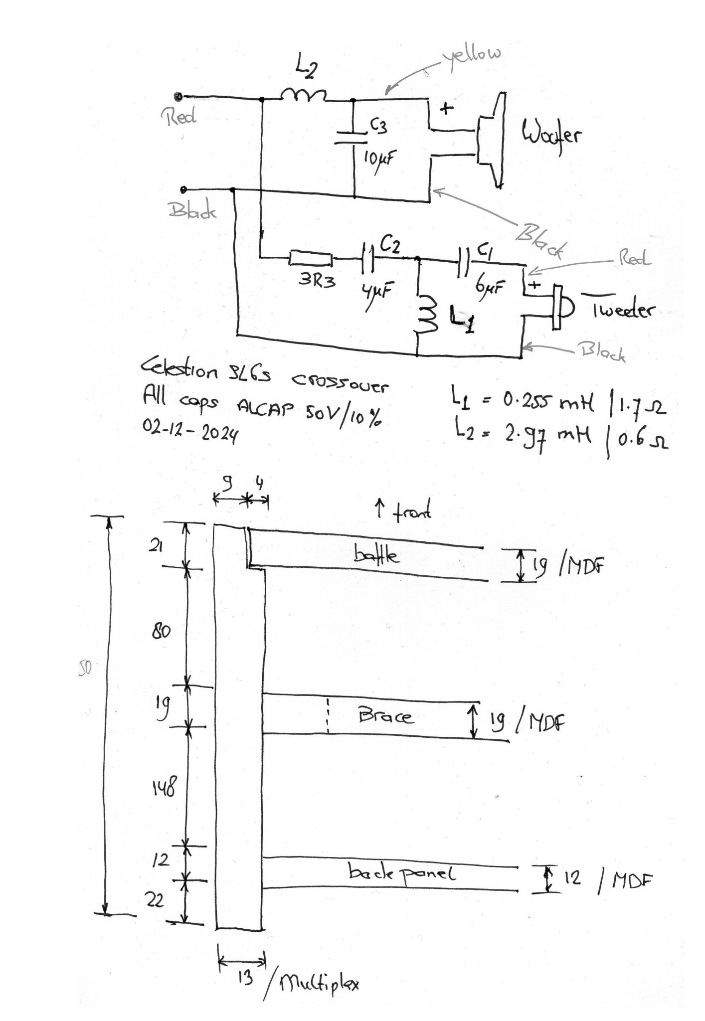

The cabinets
Outside measurements (HxWxD) 376mm x 201mm x 250
Inside measurements (HxWxD) 351mm x 174mm x 195mm
- Baffle thickness 19mm (HDF/MDF)
- Backpanel thickness 12mm (HDF/MDF)
- Sidepanels thickness 13mm multiplex
- Internal brace 19mm (HDF/MDF)
Internal volume of cabinet 1,95 x 1,74 x 3,51 -1 = 10,9 ltr (0,5 ltr for the drivers).
The cabinet is simple, made form a combination of MDF (HDF?) and multiplex. The construction is very rigid, and heavy for such a small cabinet. Note the back panel, which is mounted 22mm inside the cabinet. This is done in order to better supress cabinet resonances.
Cabinet sketch and crossover schematic

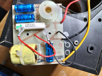

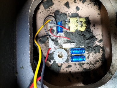

The crossover mounted on the inside backpanel, and some of the pulverized damping material.
The crossover

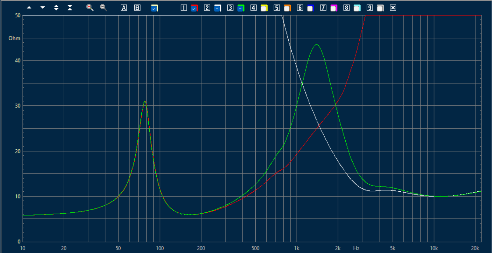

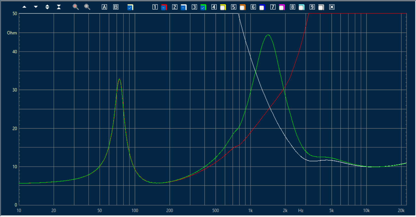

The crossover is simple, with a 12dB/oct lowpass for the woofer and a 18dB/oct highpass for the tweeter. Tweeter and woofer are connected in phase. The crossover is asymmetrical, which will influence the (vertical) polar diagram.
All capacitors are originally (as shown here) Alcaps. I checked the capacitor values.

Not bad for 40 year old capacitors. I still repaced them with Visaton 10µF MKM, and MCaps.

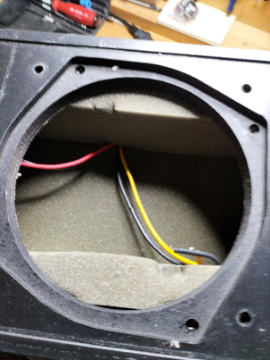

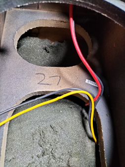

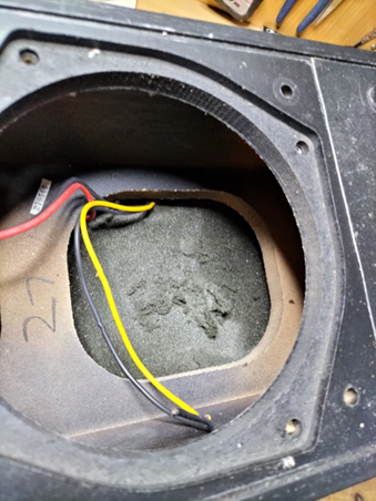

Cabinet damping
The cabinet is almost completely filled with damping material. There are three layers of two types of foam stacked from the backpanel up to the back of the woofer magnet. On top of that there are pieces of foam along the sides up to the baffle. The three top layers of foam, like the green type in the picture below, are in good condition, the bottom layer (of a different type, see the grey foam in the picture below) was essentially reduced to dust, and fell apart when I touched it. This foam layer had to be replaced. It is a sort of reticulated foam, widely used as packaging material, and for water filters.

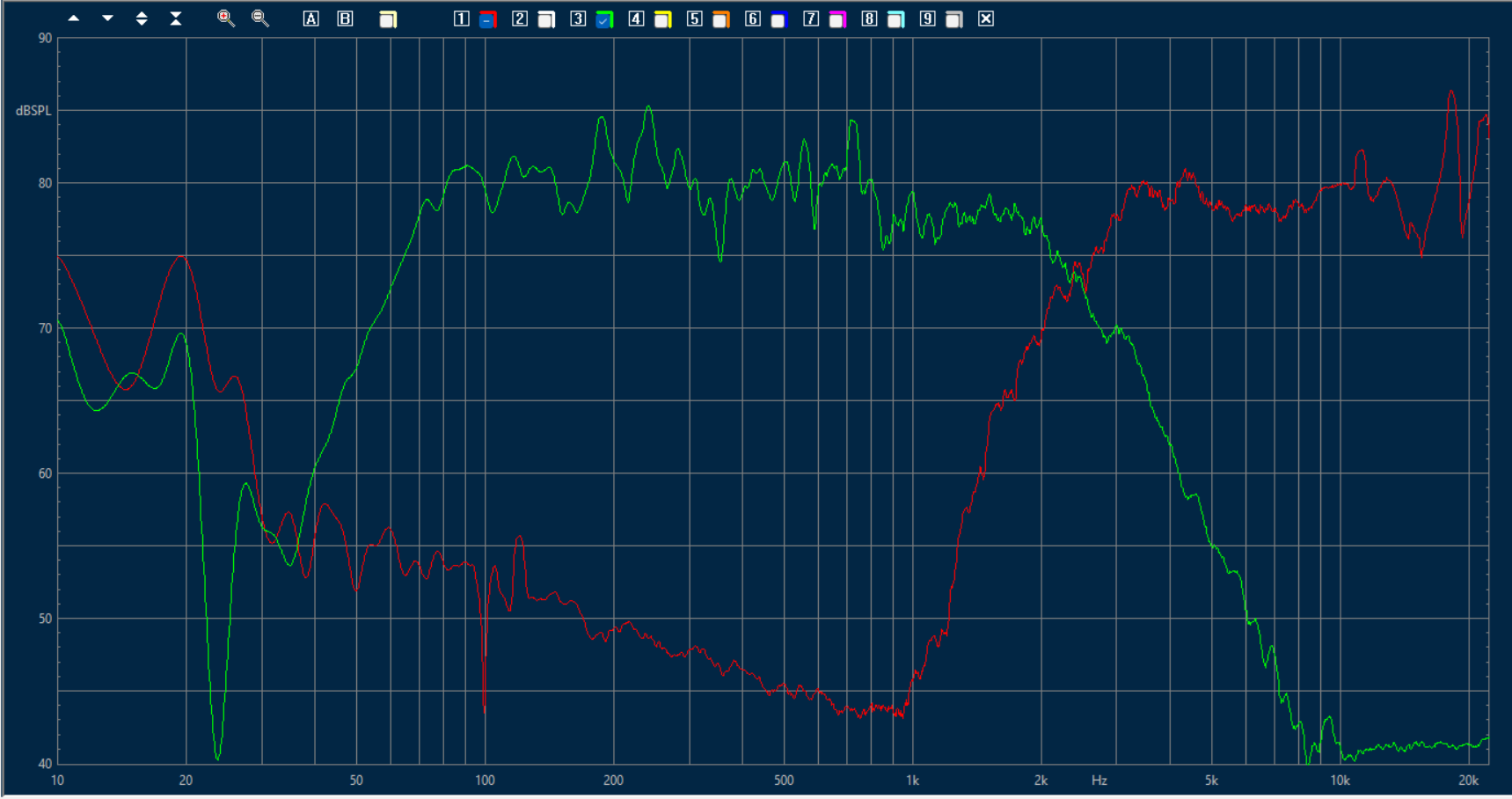

Celestion SL6s Spkr A impedance no xover red=woofer white=tweeter.png108.9 KB · Views: 15
Celestion SL6s Spkr B impedance no xover red=woofer white=tweeter.png109.7 KB · Views: 14

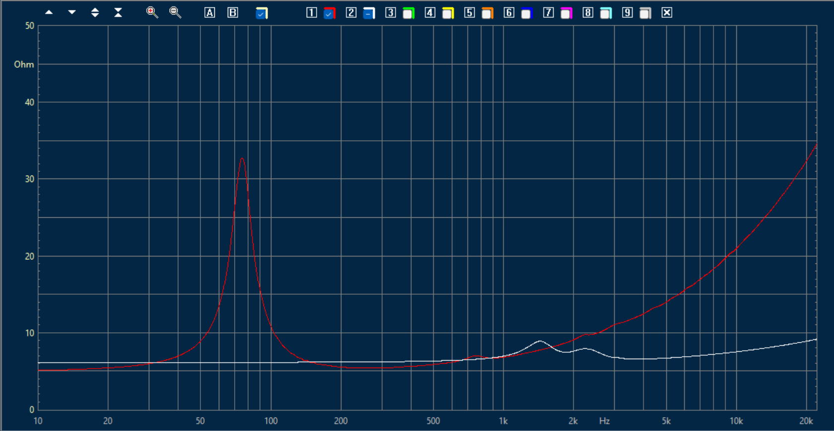

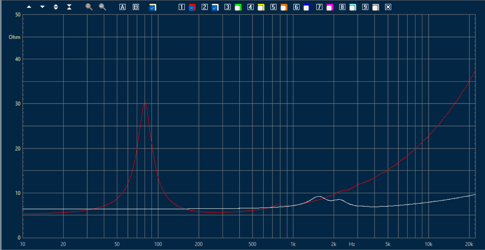

Celestion SL6s Spkr A impedance+xover red=woofer white=tweeter green=speaker.png131.7 KB · Views: 18
Celestion SL6s Spkr B impedance+xover red=woofer white=tweeter green=speaker.png131.7 KB · Views: 18
