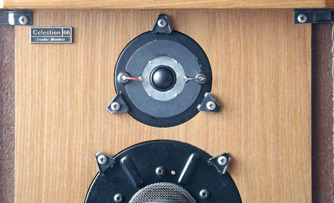

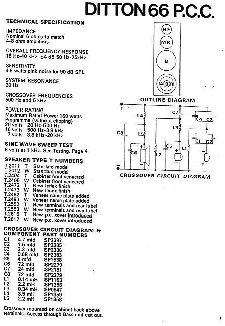

I have a pai of Celestion Studio 66 Monitors for which I need a replacement pair of tweeters. The original HF2000's have been replaced by a cheap pair of 'Realistic' pair of tweeters which sound absolutely terrible. Is there anybody with a positive experience of replacing the HF2000's. Including any possible tweaks to the crossovers etc. I really love these speakers and only want to have them sounding as good as possible. The midrange and woofers are the originals and in good working order. I have read many articles on the web which do provide conflicting information.😕

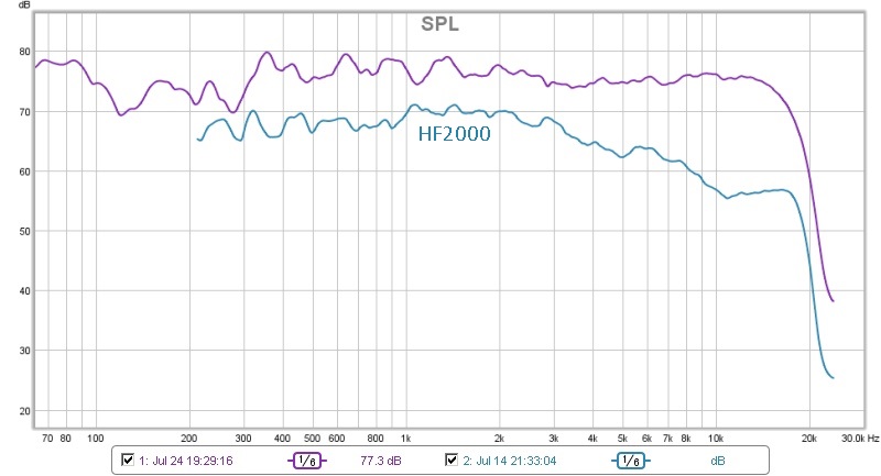

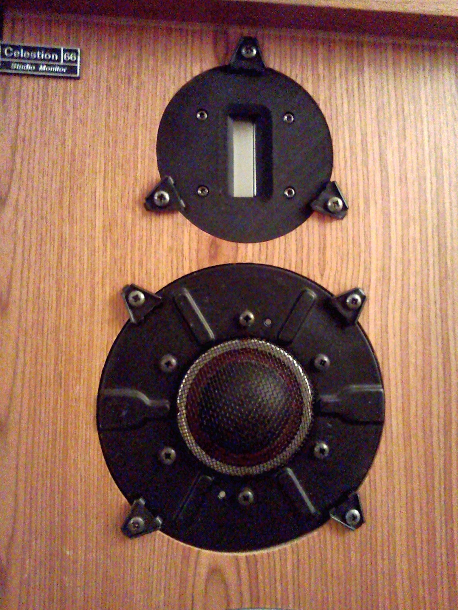

I have one good and one repaired HF2000 for cost of shipping. I used the Fountek NeoX 1.0 as replacements and 3D printed a new mounting flange. Before and after frequency response graph attached. The Fountek graph is in purple. The cabinet hole needed to be enlarged in the North/South directions to clear the new tweeter. I can send the 3D Solidworks model for the flange if interested. Connecting in opposite phase from the HF2000 gave the best response according to measurements.

wow, Can you desribe sonic differences between hf2000 and fountek in those dittons 66?
I personaly tried EMIT K from infinity , Hiquphon OWI (OW1), and Seas 19TFF1, and being honnest none of them performed as good as oryginal.
Can you also share your xover for fiuntek in those dittons?
Best Regards
I've had the chance to live with the Founteks for awhile and am pleased overall. When I first listened after changing out the HF2000s, the difference between the smooth, forgiving reproduction of a domed tweeter to the more aggressive attack from the Fountek ribbon was obvious. I also noticed an improved sound-stage that didn't depend on a narrow selection of seating positions. I am using the factory crossover design and component values and got lucky as to how well the output levels matched between the midrange and new tweeter. I have however, remade the PCB to separate the woofer for bi-amp configuration and to replace the factory telephone wire and slip-on connections (seen in another post). Thanks for the interest.
