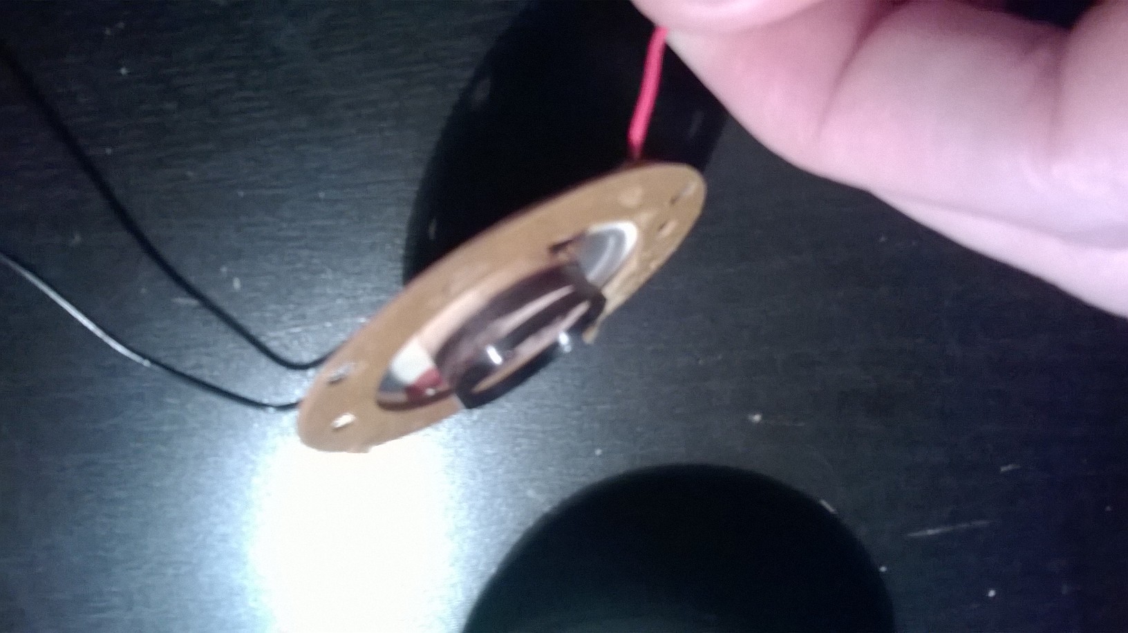

It measures 3,7 ohm, it works but at a lower volume than the other one. Just opened and closed it, now it distorts like if something doesn't move freely inside.
Forgiving my naive explanation, could someone help me to fix it?
Thank you.
Its a long time since I took apart a HF1300, but you may have to centre the voice coil in the magnetic gap. Perhaps use some white noise for this. Did the voice coil look OK? Mine were obviously burnt.

So, I guess that you must have had it apart. As I mentioned, was a long time ago I took apart a HF1300, but the screws on the front are the way in. If you Google Celeston HF1300 and look at images, you should see the construction.
Found the problem... Checked for continuity and it's ok. Any chance to save the voicecoil?

Does the tweeter work ok after you replaced the coil? I changed the VC on my HF1300 last night. My original VC was totally ruined so I bought a new VC from AudioParts. Cut away the remains of the old one and glued the new one in place. I had to unwind the VC due to too high ohm. I unwinded it down to 3,8 ohm. I will test it tonight.
