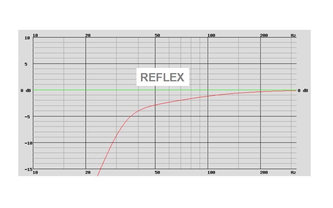

I recently purchased a single celestion FTR15-4080HDX for a song. I realize it is probably not the best driver for a sub, but my intent is modest.
One other reason for purchasing this model celestion is that I intend to build an enclosure which will double as either a small table or bench (the idea of filling a room with numerous pieces of furniture does not appeal to me). Internal dimensions of the enclosure must not exceed 33 W x 19 H x 13 D (inches), or its equivalent volume. (The tuning freq shall be 40 Hz. I prefer a single, dual-flared port.)
I may consider purchasing one more driver for use in the same build (i.e., incorporating two drivers as oppose to one), for an enclosure not exceeding the above noted volume [if deemed possible]).
I have queried the internet to exhaustion for a design using this driver, to no avail. I also played with an app on my tablet, but, considering I have never construted a sub, I am skeptical as to the efficacy of such an app.
Perhaps the minds at diyAudio can enlighten me, seeing that to some, calculations for such an endeavor are comfortably shot from the hip.
I purchased an FFT app for my tablet, which though crude, may provide an adequate measurement of the completed sub. Or not.
Celestion FTR15-4080HDX
As a test project you can do a reflex 90Liter (net) tuned to 35Hz but expect -10dB@30Hz.
Dimensions for the 2 ports (each) are: Length 28.92cm = 11 25⁄64in, Diameter 9.4cm = 3 45⁄64in (internal). Volume for double ports tubes is about 4.25Liters plus 4L for the 15" driver.
I will compare your suggestion with the app on my craptablet, though from what I recall, the measurements should be quite similar. Thank you.

After reviewing the calculations generated by the android app, 90L appears to be optimum (the volume quoted by 'Inductor'. The sealed is as you stated, (approximately 50L), though sealed shows a roll-off earlier than I would desire. If passive radiators were inexpensive, I would attempt such a design, but the ones I found suitable cost more than the driver.
90L vented for this driver it shall be.
Thank you.

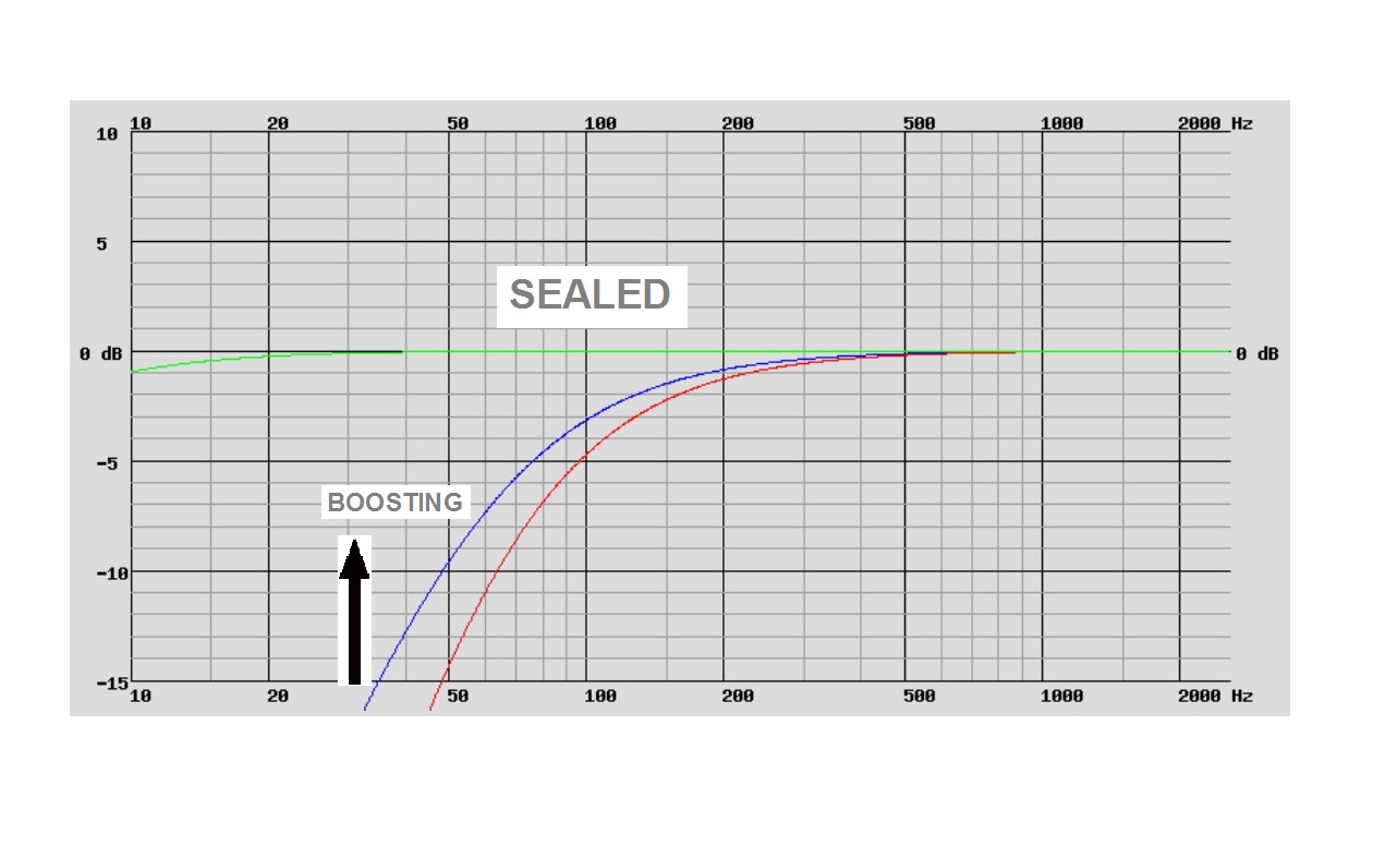

Easy enough. The vented power handlng will drop like
a stone below the relatively high tuning frequency,
whilst a simply EQ'd (first order) sealed has no
similar bottom limit, it will go much lower in room.
The EQ of sealed gives you room integration adjustment.
Fact is the 40Hz Fs driver won't go low without EQ.
It has enough Xmax to go low at decent levels,
or indecently loud with no real low bass vented, but
this needs an active high pass filter to be a reality.
rgds, sreten.

Although all of my notes are solely academic (sans the few pairs of loudspeakers I constructed long ago), I agree with sreten--the bass extension/rolloff provided by a sealed design is preferable to the drop in response a bass reflex design offers for a driver covering the same span. That said, other factors aside from a preference in response may determine the selection of the enclosure (many drivers are optimum for sealed or ported, but often not both).
For example, the celestion driver I am for which I await receipt should provide acceptable response from 40Hz to 120Hz, but NOT any frequency below, 40Hz. I am forced to sacrifice 20Hz to 40Hz due to the driver (a sacrifice I am comfortable with, since I found the driver on a substantial discount and my intention is modest). I could attempt to FORCE the driver to operate to 40Hz in a sealed enclosure, but that would probably not render desirable results.
I prefer to yield to logic.
