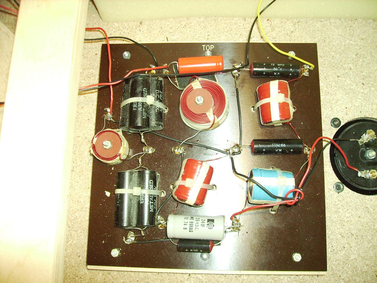

I bought some 44's, loved them for an evening, went to replace the silly speaker terminals in the morning, and found a chanel had gone. A very faint and distorted sound is all thats coming through. I've tested the speaker cones and they are all fine, the signal from the amp is good also. My only guess is that, as they were left unused for some time, that a capacitor has gone. I would love to replace them all anyway, but I am no tec' head, and I am on a tight budget.
I desperately need some advice about what sort/make of capacitor I can look to replace the old ones with. There are some replacement crossovers on e-bay, but I think it might be unwise to replace the boards with another set of old caps.
Could I take the capacitor specs to RS, and just replace them directly with modern units, not designed with the audiophile in mind?
Would be most grateful for any help - have no hi-fi - going mental.
Make sure that you get non-polarised caps (sometimes called bipolar) and match the capacitance and working voltage.
What are the markings on the old cap?
BTW, how did you test the speaker cones?
edit: it may be prudent to test the caps. If the cap has indeed gone high impedance then you should be able to measure a higher AC voltage across it compared to the good speaker when playing music. Do you have a meter? I've spent too much money doing the "trial-and-error" fault finding technique.

I have a meter. To test a cap, do I place the terminals across the cap? Will AC voltage be consistent, or vary with music? I ask because whenever I've tried to multimeter music signals, my reading jumps around like it's gone mad. I don't really know how to use it properly.

I tested the speakers individually bu introducing direct feed from the amp at low volume. All responded. Secondly I ran the positive from the primary conection point on the cross over, then traced backwards from the primary negative connection. This produced a selection of music at different frequencies from individual cones/tweeter. Common sense seemed to indicate that the first cap had gone, but I couldn't make sense of wyh that only produced sound from one speaker when I took it out of the loop.

It's very likely that a 20yr old cap has dried up and gone high impedance and yes, modern electrolytics are much better (must be non-polarized of course.) But what's the evidence of that here? I don't advocate replacing any components just because, especially if there's a few non-invasive tests you can do to test your assumption, it could save time.
Where is the suspect cap in the circuit (across the woofer, in series with tweeter?) and how does the AC voltage compare between the good and bad speaker. Because a cap passes AC, there should be little or no measurable AC voltage across it (unless you got a deep bass music passage). If it has gone high impedance you will see lot's of bouncing around with occasional large numbers as you described.

Here is a pic' of the cross over. All of the solder seems to be good and there is no visual hint as to any fault. Might there be another reason for the failure?

That orange electrolytic on the top looks a bit out of place. Do you think someones worked on it before?
Do you have access to some kind of signal generator? If not, there's apps for the PC that will create tones of different frequencies as .wav files. You could put together a CD with different tones on to help debug.
Taking voltage measurements across the caps with different frequency tones should reveal the problem. 80Hz, 800Hz and 3KHz will work. If you trace out the components and connections you should be able to reverse engineer the schematic.

You could test all the caps in this with a 9V battery & a meter. Depending on the meter resistance (which should be huge) all the caps should hold up a DC charge for several minutes if they truly are still caps.
Disconnect the speakers and hook up a 9V battery to all the terminal pairs in turn. Watch each cap discharge in both polarity.

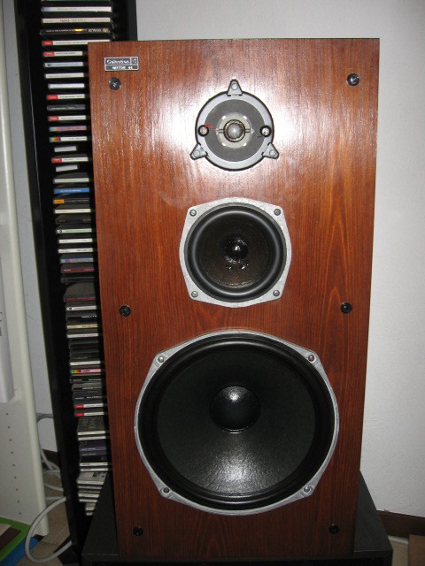

rebuilding celestion ditton 44
hi,sorry for my little english and long time for your question ,i have rebuilt a pair of ditton 44 find in trash ,i have repair the cabinet with many damage with new wall wood and new veneer and repair one midrange with a little cable interrupt and totally recap the crossover (after 40 years old the capacitor very bad value) if you dont have resolving your problems post me if is all well good listening and regards Osvaldo

total rebuild celestion ditton 44
hi,sorry for my little english ,i have find in trash a pair of this cabinet very damage, water destroyed down of box scratch terrible and a little frame destroyed and one tweeter brokken i have cut the bottom and replacement and cut little frame front and to fill every hole smoothing all,after new veener wood and buffing wax new tweeter buy in ENGLAND 60 euro damned and recap crossover 30 day of work but now ihave a new pair of this thanks and regards Osvaldo if you wont i can post a photo of this in a forum or to you
