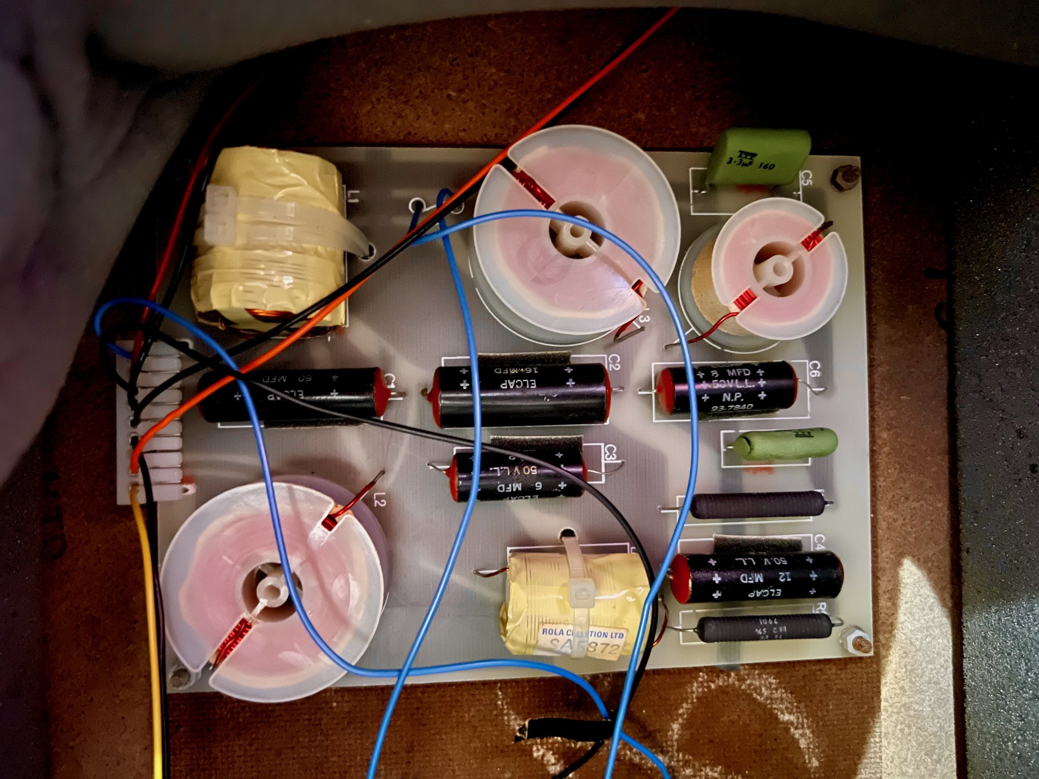

Thank you guys! I managed to pry out the tweeter, and later on the bass as well. Like we all suspected the seal gasket had turn to a sticky mess.
Now I just need to recap the crossover!
If the crossover incorporates bipolar electrolytic capacitors, I recommend you replace them with new, fresh electrolytic ones - and not plastic film types.
Doing so helps ensure that the speakers return to sounding as they were originally intended to sound.
However, you may wish to experiment!

You must mean the white receptacle on the left.
I'm not familiar with it. It looks like the wires may have been terminated in metal 'spades' which have been slid into the slots in the receptacle from the right. They may have then locked in position, so can't be slid back out. Try to do so and see wot's wot.
P.S. I would replace those unreliable ELCAP NP electrolytics with modern equivalents. You may not find the exact equivalent values, but if you can stay within plus or minus 10% of each original value you will be OK.
List the microfarad values required if you need advice on replacements.
