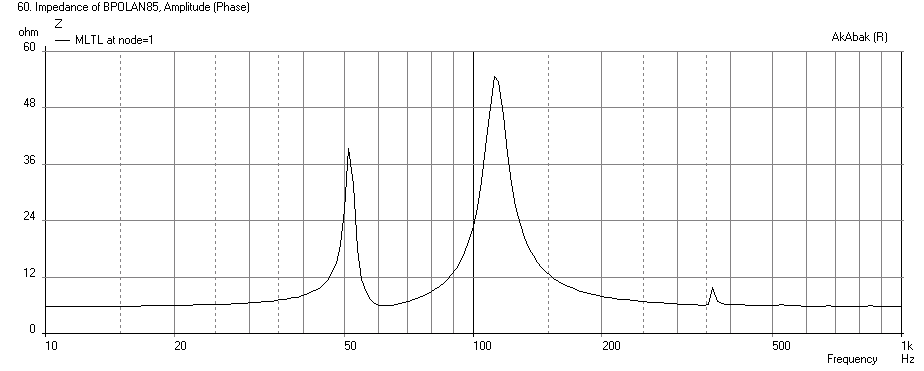

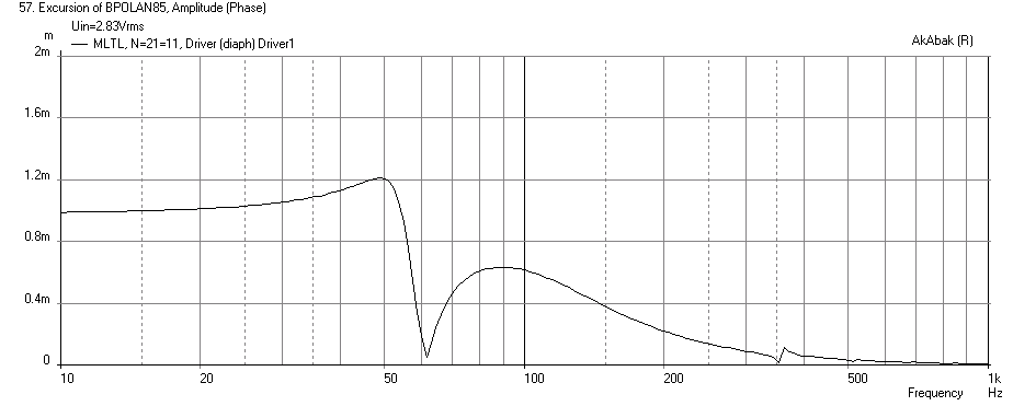

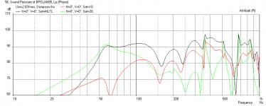

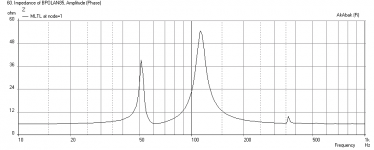

At first I was very excited to see this driver as it has some pretty good performance, but the $43 price is too high in my opinion for what it is as the parameters are actually a lot like the discontinued buyout Tang Band W3-881si ($10). The parameters are so similar that I could just drop them into a MLTL designed for the 881si and it sim'd pretty well. I did some tweaking to optimize it for bass extension and a flat bass shelf in the freq response. As long as the referenced design was going to use qnty 4 drivers, I would recommend putting 2 front firing and 2 rear firing for a bipole and you will not have any BSC issues to deal with. Below is the sim for a bipole MLTL design as follows:
4.5 in wide x 7.0 in deep x 40 in tall, with drivers mounted at 17 in from top (the middle line btwn drivers mounted as close as possible together), bottom firing 2.0 in x 5.0 in rectangular vent x 3.5 in long, with 4 in tall legs for the bass to escape. Stuff upper 2/3rds of chamber with polyfill at about 0.5 lb/cu ft. Wire drivers parallel/series for 8 ohms total. This is very similar to the build by Ryani here: http://www.diyaudio.com/forums/full-range/234535-tangband-w3-881-mltl-build.html
He had very good success with the 881si's, and I think these will sound similar. You get more cone excursion with these drivers so they should be able to get louder. The MLTL will get down to about 55 Hz and the efficiency achieved with 4 drivers is very high.
First plot is freq response at 1 m, 1 watt, with speaker 60 in away from wall, second plot is driver cone excursion, third is impedance. The sim does not have stuffing so with it in place, the dips and peaks should really be smoothed out.

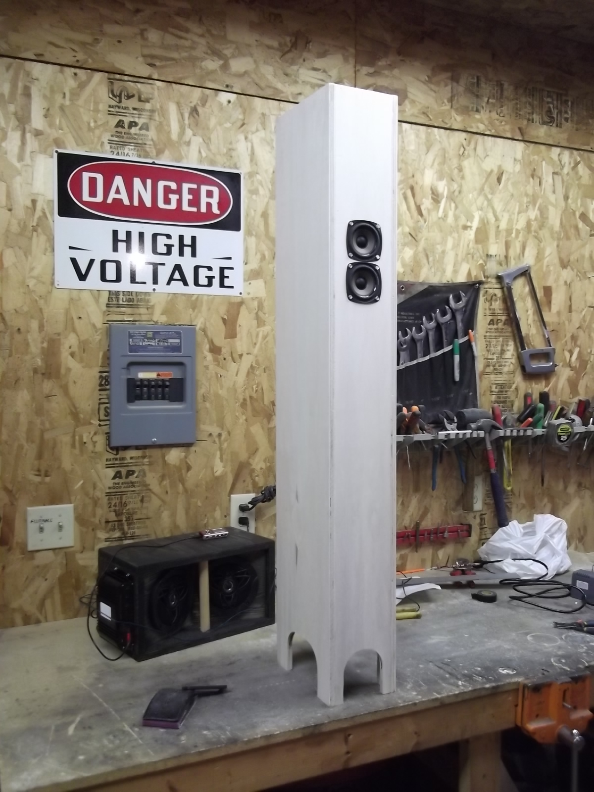

I built a "test mule" and the Parts Express design works quite well. These really project some nice detail...especially acoustics. I have tried it in two different applications...one complimenting a pair of 2 ways, the other with my Alpair 7s. I love what these do. The parts are coming in for the second one and will most likely run them in parallel with my Alpairs on my main system.
