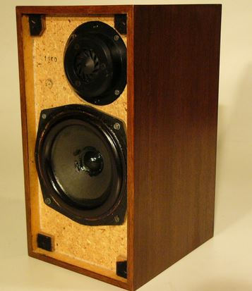

Hi Everyone,
I just got lucky and picked a pair of ancient Celestion 10 loudspeakers off a roadside pickup.
The problem is no crossovers inside, the speakers are in as new condition. No scratches or marks, even the Tygan grilles are perfect. It looks as though these had the X/O removed and then put away for storage, maybe the owner planned to upgrade the X/O, who knows?

I expect you're struggling to post an image if you are new here. 🙂
Are these Celestion Ditton 10 speakers with the famous old Celestion HF1300 tweeter, and maybe a 5 or 6" paper bass?
I think this can be done. The Ditton 15 used that tweeter on a second order cap (4.7uF?) and coil tweeter crossover, with just a coil on the bass. So we can have a stab at this.
I was looking at that midbass... it looks suspiciously like the same 150mm unit used in the Celestion Ditton 44 as a pure mid!

Express yourself. I can design a 5" bass plus tweeter crossover in about 5 minutes! 😀
It's not hard. Maybe not quite a clone of the Celestion Ditton 10, if that is what it is, but reasonable. 4 element second order plus tweeter attenuation, I'd say. 😱

Thanks for getting back to me, been a bit busy with hospital. The tweeter is indeed the old HF1300, the paper cone bass/mid is very similar if not the same as the 44 mid. The little five incher sounds good running full range I have tried them using my DEQX and the result quite superb for an oldie. The DEQX and my Sonoras' are a bit of overkill though.
A simple XO would be very nice, I'll run them off my old VM integrated.

Aw Peter, I hope you are now in good health! I was wondering, AS I OFTEN DO, if I was talking to myself here...😱
I like to get a feel for a project, because I don't do hack work. So I read Troels Gravesen on the HF1300 tweeter:
Spendor BC1
And I thought the Vifa PL14WJ must be pretty similar to the Celestion 5" paper mid looking at the simpler MTM circuit: Vifa PL14WJ-
I'm thinking we just give the bass 2mH and 6.2uF. 3kHz crossover. The tweeter might normally get a series resistor around 10R and 22R shunted across it. 3.3uF and 0.3mH. But I really don't know. 4.7uF and 0.2mH can work too.
HW 2/70 NG - 8 Ohm
Visaton's crossover is actually better suited to a 4 ohm bass.
I want to know the DC resistance of the tweeter, since it might be a 16 ohm jobbie, around 12R resistance with a multimeter. Might as well measure the midbass resistance while you are at it. Ought to be 6R.

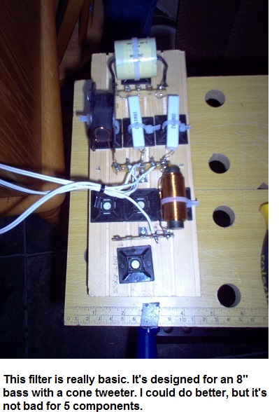

To me, it's saying second-order LC and CL filters with any appropriate attenuation on the tweeter, regardless of whether you think your Celestion 10 is particularly special and deserving of individual treatment.
1.8mH and 6.2uF shunt ought to do it on the bass filter. 3.3uF and 0.33mH ought to do it on the tweeter filter. And some attenuation. If this sort of thing below is too difficult for you, find another hobby. 😀
