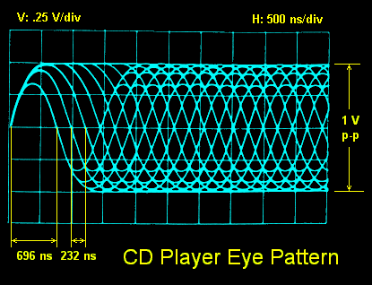

What does the Eye Pattern look like as it stops playing?

Btw, what is the eye pattern? The CD still spin but the sound is garbled
