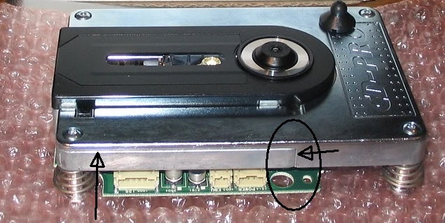

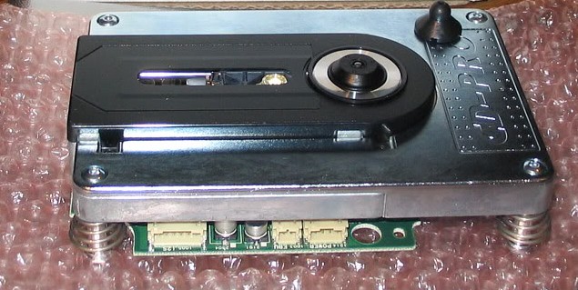

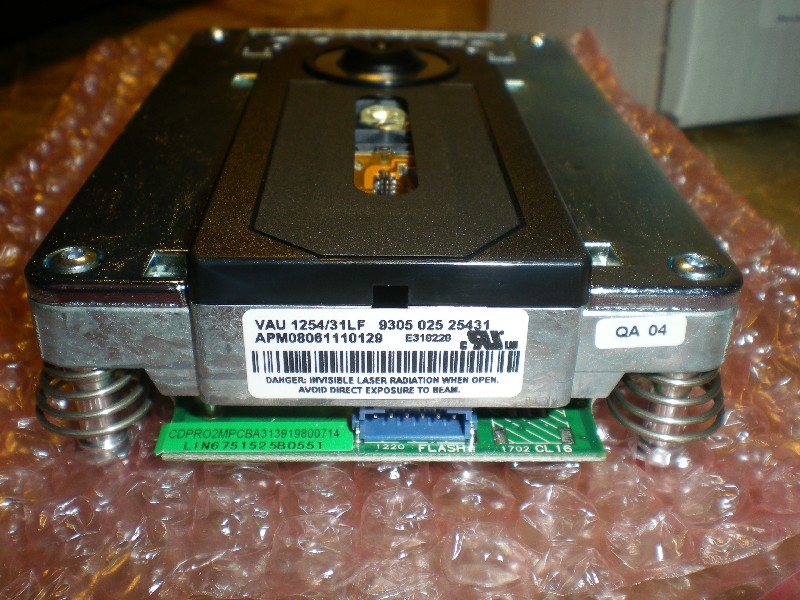

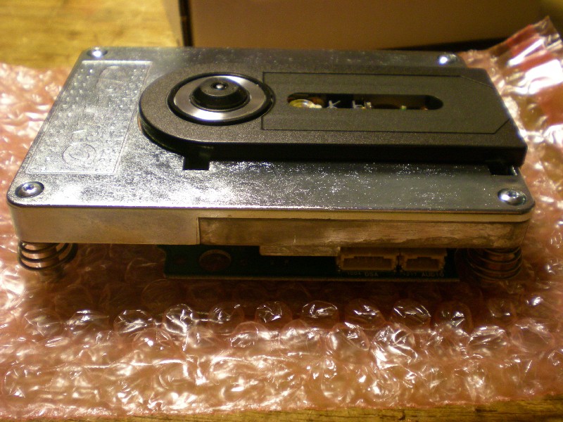

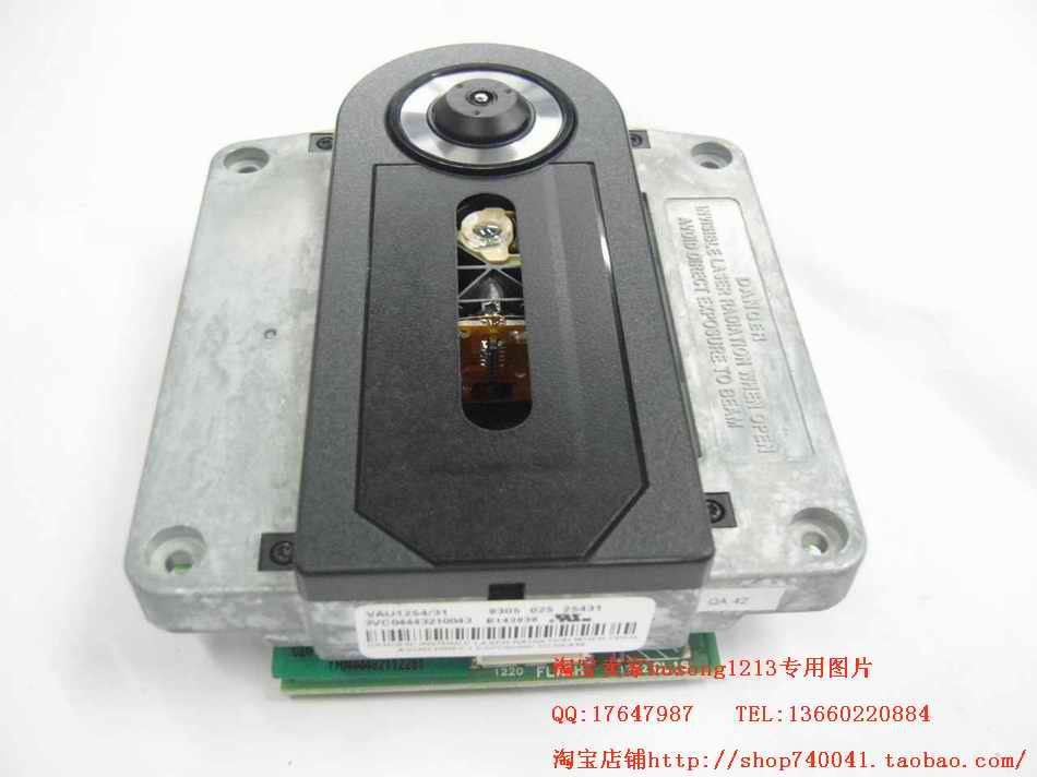

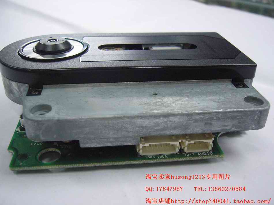

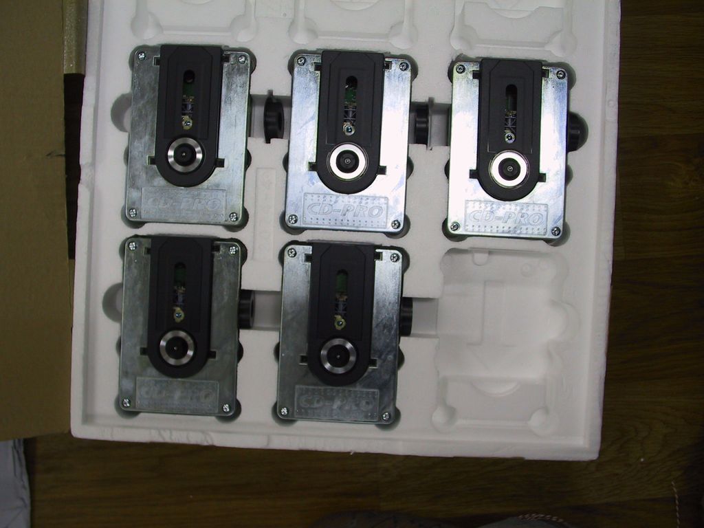

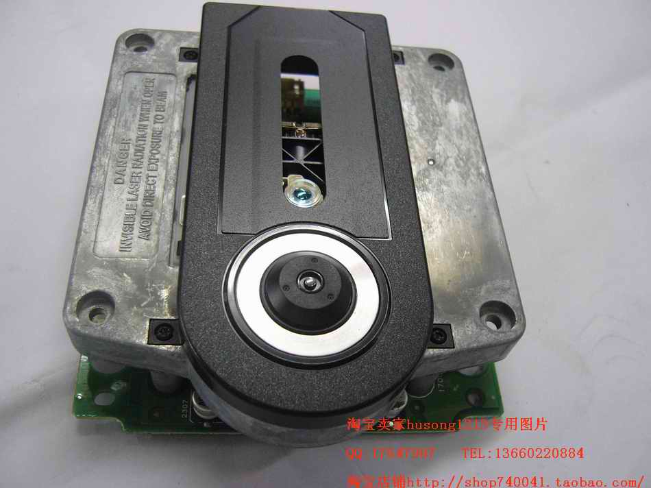

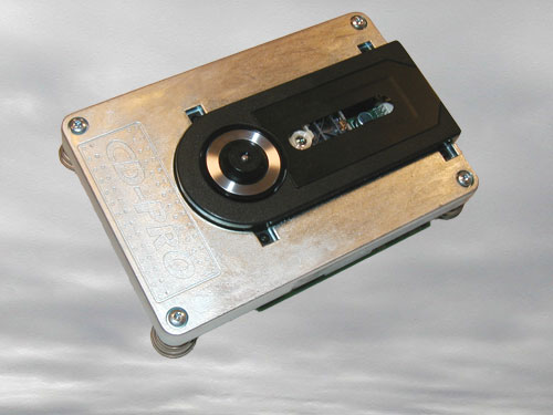

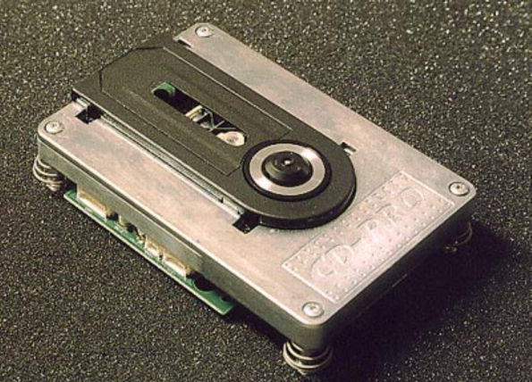

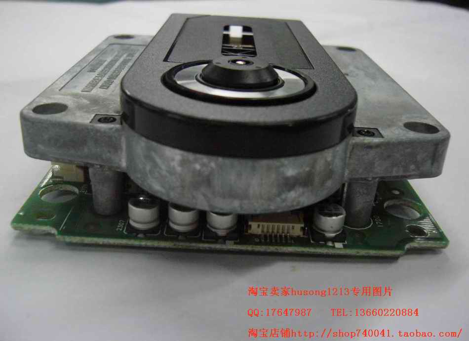

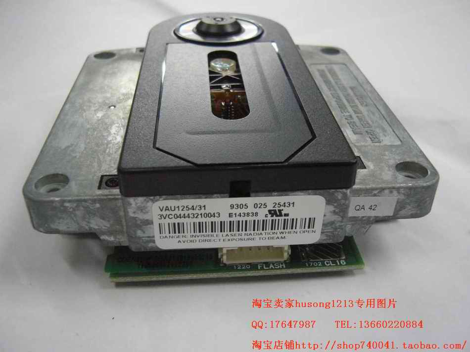

Here two picture series of two different aluminum die casting metal frame for the same mechanism VAM VAU 1254 / 31 LF (lead free) resp. CDpro-2LF. The frame of first picture series looks exactly like the first generation professional mechanism from Philips, the CDM12IND (CDM12 IND, CDM 12 IND, CDM 12IND, CDM12PRO).

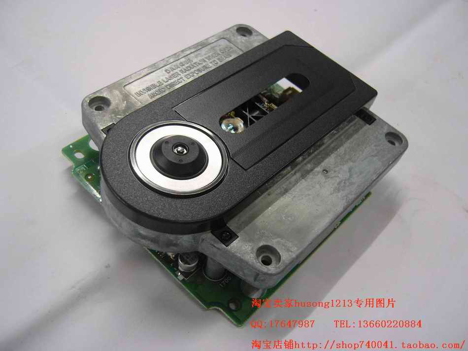

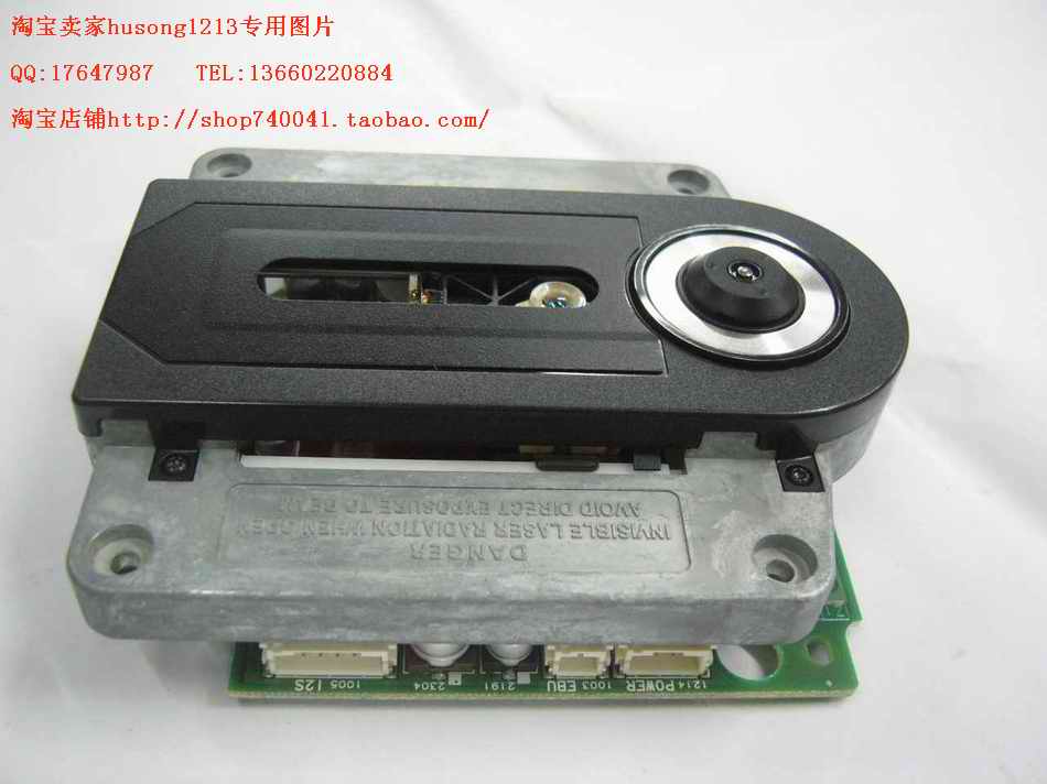

Now the second picture series of the frame from CD pro2LF (CDpro CD pro). Stickers from both designs show model number VAU1254/31

As far as I know all CD-Pro's are back-compatible, because their used in juke-boxes among other things, as poynton said....
If you unscrew the two piece cast from the second set of photos you get something similar to the ones shown in the first post. They kept the same sizes and positions for the relevant pcb and mounting holes and almost the same for the connectors. I notice that the newer ones can be (re)flashed....but that connector is not normally needed (I guess).
