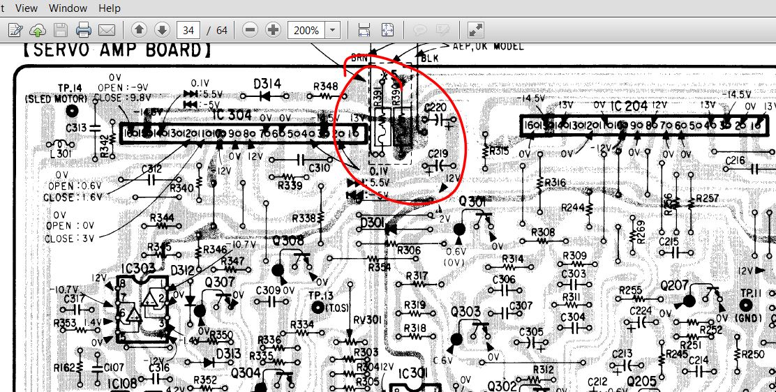

If you trace the -10 volt rail down it come to a fusible resistor R391. Is the -10 voltage OK and constant on the other side of that resistor ?

I can't seem to find that resistor. The top PCB seems to have numbers in the 300 range R315 seems to be a bit corroded by the adhesive so that'll need replaced. Not sure it's related though. The motor components don't seem to be getting hot.. slightly warm but not hot. I'll keep looking for that resistor.
Here 🙂 next to the STK's

I think I found the resistors, There are 2 in place of 2 jump wires which aren't marked on my PCB as resistors. They seem to have the value indicated in the service manual though. Voltage is ok on both sides and the supply into the motor is stable DC. hmmm...
