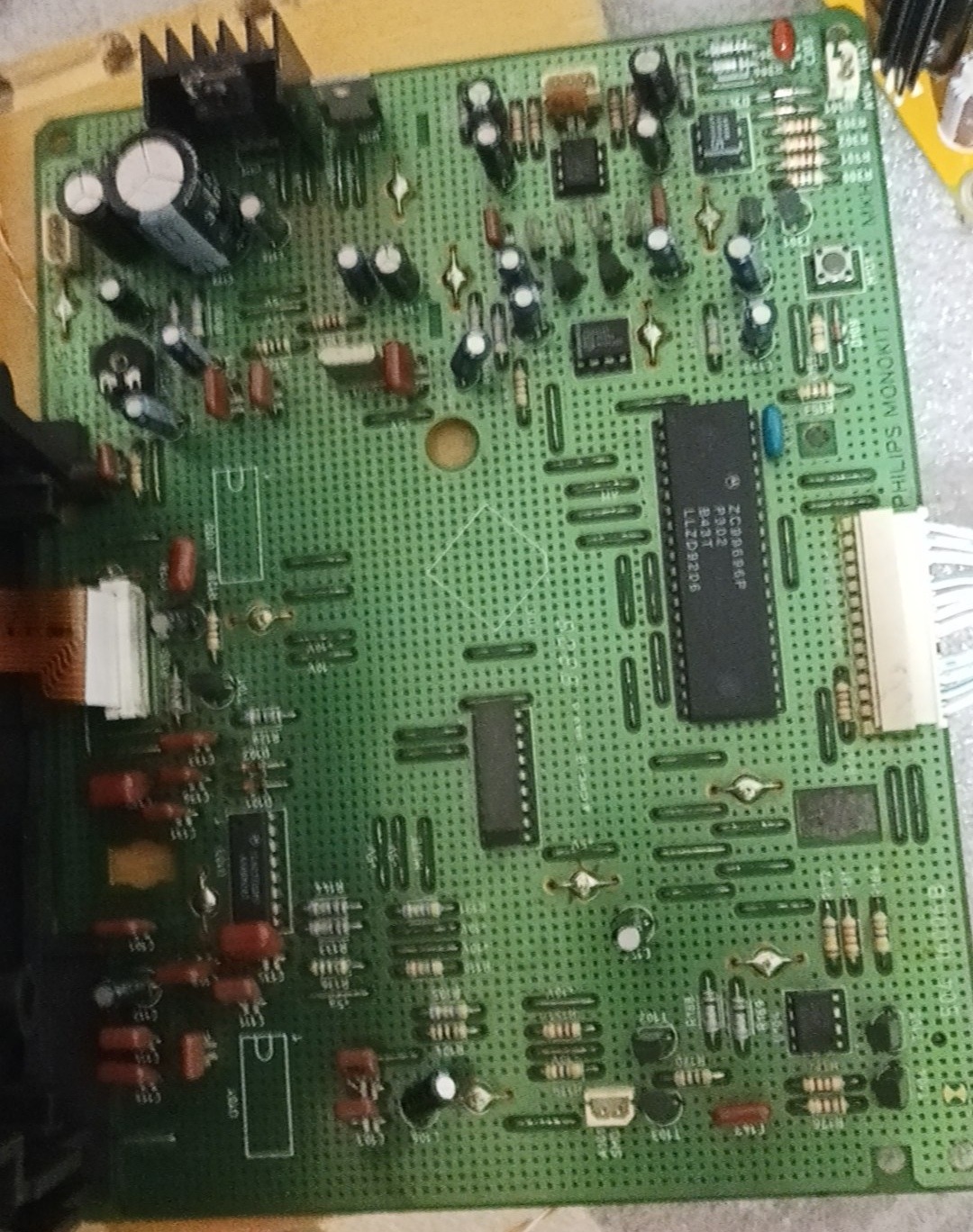

I have technics sl-pg200a, bought it just to take cdm4/19 out of it. Also bought used Philips monokit board based on saa7310 and zc99696p which I thought should be better than mn6626 (which is used in technics). But after testing the Philips board with the mechanism I noticed that seeking between tracks is much slower than in technics and also a bit noisier. Is that normal behaviour or should I look for some issues on that board?

What is the origin of your philips card?
Yes, it's too slow and noisy
Have you revised (electrolytic capacitors and soldering) your servo card?
Origin unknown.
No i haven't yet, just wanted someone to confirm that's too slow before doing it, i don't want to be frustrated after recapping etc )
tested most of the e-caps (a lot of 33uF), esr < 2 Ohms, voltage loss <2%, capacitance more that written on them, not sure if they can cause such issues
I guess I accidentally fried something on the board, it doesn't read the disk anymore... I was testing different power supplies and once there was a voltage skew and -20v appeared instead of -10v, but the +10v was ok
it was not working because my transformer doesn't output exactly 9v AC but about 8.5v AC and in the evening voltage dropped in the gird so the output from transformer was even less than 8.5v. Connected to switching psu from dvd player and it was working again.
I also decided to connect the board to external dac via i²s and on the last tracks of the same cd noticeable audible cracks and pops appeared, what is not happening in Technics player. Maybe it is also related to slow seeking or saa7310 just requires an external filter like saa7220
Maybe a tracking problem or the spindle motor is tired/dirty/not lubricated/underpowered (delete as appropriate)
power - now it is in spec or at least really close but problems persist (even seeking is not any faster)
lubrication - checked swing arm - enough oil, moves freely, works fine in Technics (at least no audible cracks and pops)
spindle motor - looks fine to me and also works fine in Technics
if it is a tracking problem, how to deal with it?
Only one idea left - use servo board from Technics (tda8808t, tda8809t, tca0372dp2) and connnect it to saa7310 & zc99696p, but it requires some additional soldering/desoldering work...
I stumbled upon a video on YouTube showing Philips cd 380 operation, there is the same mechanism and almost same processor and seeking there is also slow and noisy, looks like this is normal operation for those processors.
