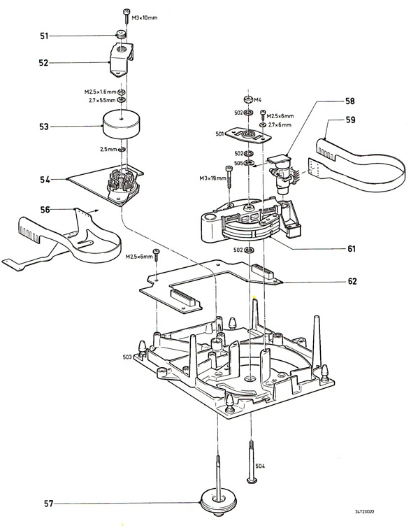

CDM1: help please: removal of spindle motor shaft
Hi Steerpike,
Turntable and shaft are inseparable. They come out from the top. See attached exploded view from the service manual.
Lourens

Thanks Lourens! That diagram is exactly what i needed!
Whats the problem with the CDM-1 Steerpike?
It's in a ReVox B226.
The spindle is a little "stiff" or feels heavily damped. No audio problems yet, but the disc stops immediately the power is shut off - there is no inertial run-on. I imagine there should be some free-wheeling of the spindle and disc, although the motor does not yet seem to be struggling to overcome the load. What prompted me to investigate this is that the transport has become a little noisier than I remember it being.

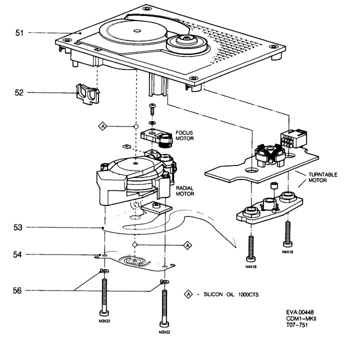

AFAIK there is no dedicated sm for Philips CDM1 mkII (the one you're looking for?). I found this exploded view of it in the Philips CDD882 manual.
For complete servicing information of the CDM1 mkII you need to have the Philips CD880 manual as well.... Both, and many others on one cd, obtainable from http://ultranalog.com/

I had a similar problem (Revox B226) which seems to be quite common with CDM1. The motor spindle runs on a teflon plate (part#51 in the posted drawing). This plate is some kind of screw and can be used to adjust the laser focus by adjusting the height of the CD platter.
Over the years the motor spindle digs a little "hole" in the teflon plate and as a result the distance between laser and CD decreases and at some point the laser has difficulties to focus. Then the playes starts to have problems with reading some CDs or with the last tracks on a CD.
The cure is to replace the teflon screw or make one or two turns of the screw to compensate for the "loss of height" and lift the CD platter up a bit to its original position. As the hole in the teflon screw is most likely off center you can only make full turns. One or two should do the job. :att'n: When replacing the screw measure the height of the CD platter BEFORE you remove the old screw to have a starting point for the reassembly of the new screw.
I never bought a new telfon screw but I've heard that they are still available from Philips and Revox. If somebody has a service manual for CDM-1 could you please look up the service part number of the screw and post it here? It's part 51 in the drawing posted by Lourens.
Cheers
joe

I have noted that problem; every few years I turn in that screw to bring the focus servo back to the 'centre' of its range (best done while watching the focus error signal on an oscilloscope).
The current problem is the stiffness of the shaft. I figured it just needs some lubrication, but i'm not keen to just ADD oil, and would prefer to clean first, then re-oil.
