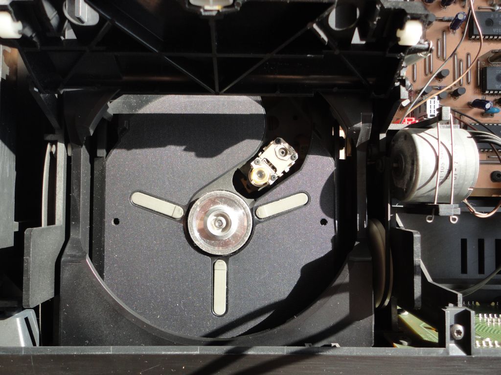

I think the CDM4/25 is older than CDM4/19, even older than CDM4/11. It has just different laser head than CDM2 or CDM4/11, the rest seems equal. Re the bearing, is there a reversible way to take away the platter from shaft? This would allow a bronze bushing or the like and new life for these plastic chassis, better than new.

I modified the white Glass filled Resin CDM-2 base (where laser-arm is assembled on) whith a lead and rubber sheets, glued them on. The resonance freq. of it substantially dropped then too. I replaced foam dampers in springs, they were'nt elastic anymore. The whole bounces very good now, and is rests still fairly quick then after.

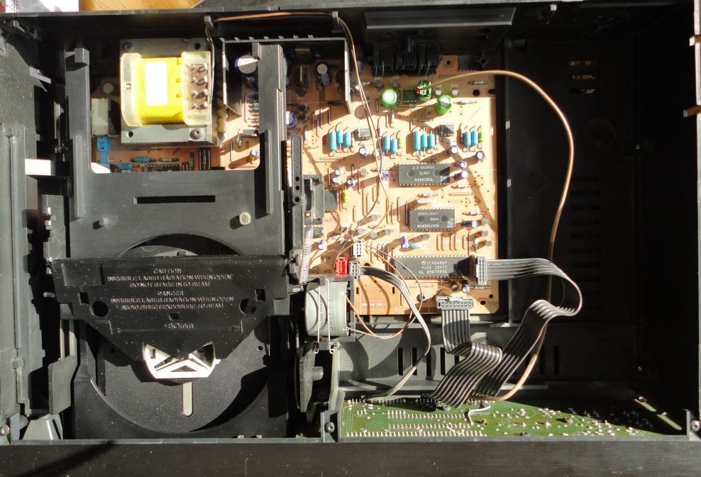

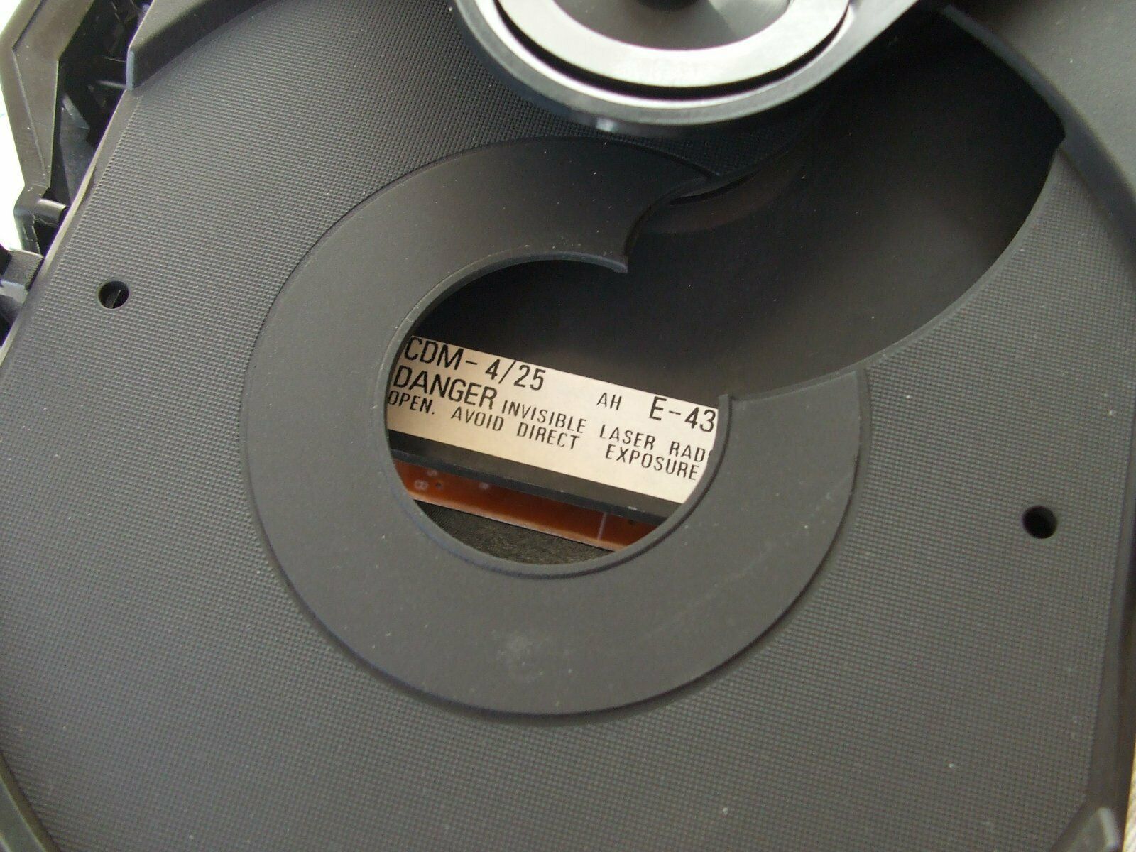

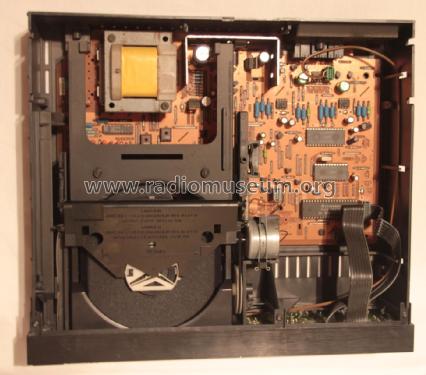

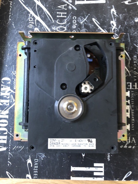

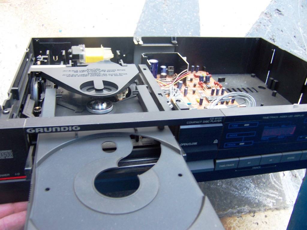

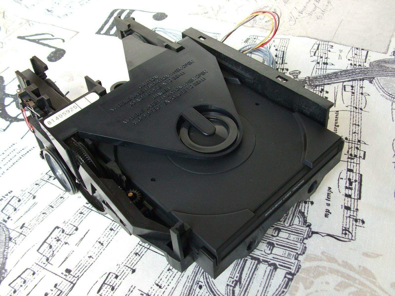

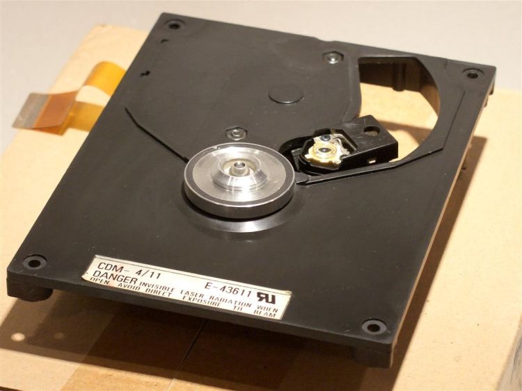

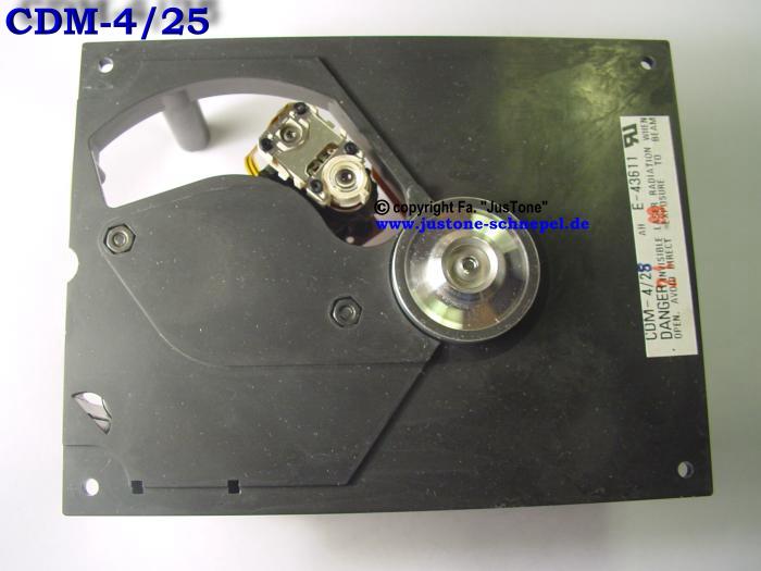

Great problems I have to find out differences in detail between the exist CDM-4 versions. Easy to find out are the versions without brushless motors like CDM-4/19 and CDM-4/31 with integrated servo board. Even Justone Schnepel seems to be to fight with this problem - go to
http://www.ersatzteil.justone-schnepel.de/html/philips_cdm-4-25_cdm425.html.
In the moment I want to know the differences between the version CDM-4/11 and CDM-4/25 and CDM-4/27.
According the attached images the only difference between CDM-4/11 and CDM-4/25 I note on the turntable resp. disc pulley (due different centering units of the pressure unit resp. clamp unit from loader). But the CDM-4/27 (used in Revox B-126) uses the same servo board - thus here also only a different disc motor pulley from the brushless spindle motor.
Are my estimates right ?
Thanks for any advice.
difference between CDM4-25 and CDM-4/11 seems to be only the legs.
under
https://www.diyaudio.com/community/threads/what-dacs-and-mechanics.29889/
I read this:
cdm4/11 = 4822 691 20464
cdm4/25 = 4822 691 30211 ~691.20464
and under
https://www.fixya.com/tags/691
I read:
4822 691 20464 A1 CDM4 short leg
4822 691 30211 A1 CDM4 long leg
According the associated RAFOC unit is the same.

CDM-4 mechanism to replace two different CDM-2 versions
In the attachment are the associated instructions so as the description of differences.
Code "4822 691 20464" is for CDM-4/11 (turntable for mechanical disc hold down, for replace CDM-2/0501)
But to which CDM-4 version does the code "4822 691 30205" belong (turntable for magnetic disc hold down for replace CDM-2/0503) ?
