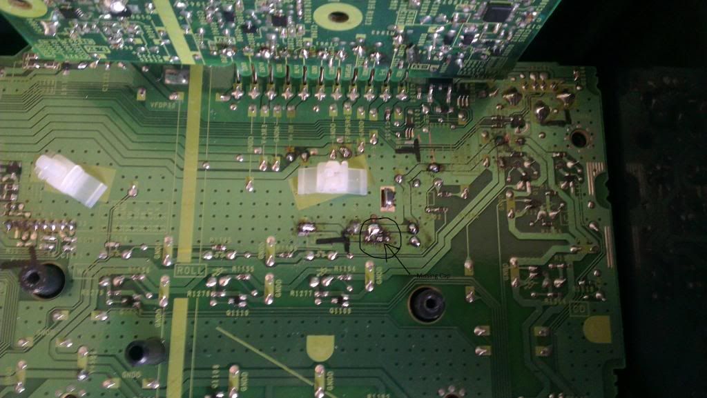

ok the capacitor that is missing is a decoupling capacitor, could this effect the audio by making it quiet and muffled? it is on a different PCB to the DSP and DAC.
im guessing the problem now is a lack of power to the PCB with the DSP and DAC on it, at least i have a start, gonna have a propper test over the weekend when i get chance.

Missing cap is here -> http://i279.photobucket.com/albums/kk145/dazzler222/missingcap.jpg

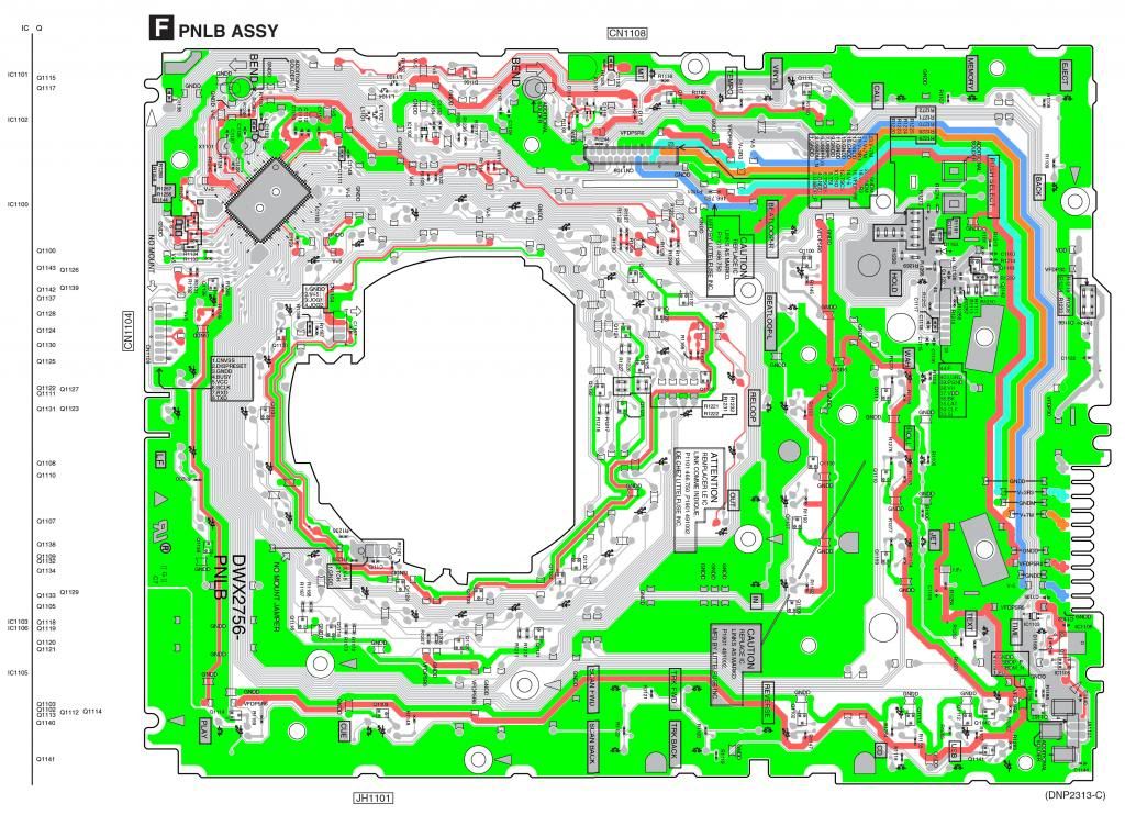

Main PCB Diagram -> http://i279.photobucket.com/albums/kk145/dazzler222/MainPCBUndersideCircuitsHighlighted.jpg

IM thinking maybe this should be in the analogue line level forum now!
so i have swapped parts with a known working unit and the problem is on the main pcb. it is difficult to test the voltages getting to the DSP board because of the way it all plugs together.
but the continuity all checks out to the point where it plugs in and i know the board is good already.
so the sound output is really distorted almost is if the gain is turned up too high but yet the output is really quiet. (I have to turn the gain right up on the mixer to hear the muffled distorted sound)
kind of at a loss as to what to test next now...

From your description, I would check the mute circuit as if it is muted, it will produce a tinny and distorted sound.
Looks like this could be the issue, the -5v output from the power board is coming out at .1v as opposed to -5v
as far as i can see the -5v is essential to the mute circuit...
any further ideas welcome!
