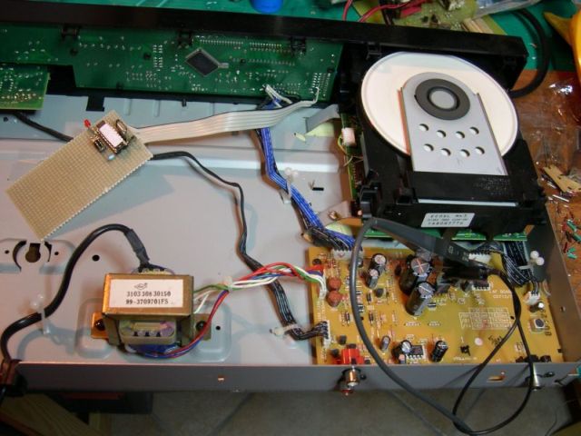

Great news!
A few days after my las post on this thread Robinet replied me and sent me the file with all the info needed.
Today I got my Atmel chips and, after finding that at my workplace we have a programmer that supports it.. I quickly assembled the board and tried it: success!! It worked a charm.
Here is a piccy of the hacker in action:
tschrama said:
How much did you spend for this project? Could you eleaborate a bit... seems like an interesting project..
As my signature suggests I like to be cheap ;-)
The CD723 was about ˆ40 (ebay)
The Atmel chip is very cheap and the circuit uses 5-6 components
The most costly thing is Thorsten's designed output stage for TDA1545A, that can cost up to 100 or more ˆ depending on the components you use. I already had almost everything in stock (including some beautiful Mullard E88CC NOS) so I didn't break the balance.
A description of Thorsten's original modification is here: http://www.ptsoundlab.com/sources/lectcd/philips723/phil723.htm , be warned that for NON-OS you have to change some values as T. discussed in a earlier thread. http://www.diyaudio.com/forums/showthread.php?s=&threadid=48718&perpage=10&highlight=&pagenumber=2
BTW I actually found a credit for T. in this webpage, but it is hidden by its crazy layout.
The hacker allows you to use the TDA1545A in NON-OS mode, but also to throw in a TDA1541A (it programs the SAAxxx chip to output IIS !!), so you only have to choose what to do!
Another thing to do is to tweak the PS as suggested in many places (Nuuk's site and others)
Hope it is enough!
