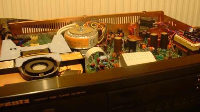

Just in case you're interested, here is a pic from yesterday, just before the display fault occured.
You can see the CAT5 lead, input cap, rearranged Elna caps, Audiocom DVC-1 clock and power input with black gate, changed output caps, ic shielding with blu-tac 😉 etc etc. Its so much fun, isn't it? (apart from when it goes wrong...)

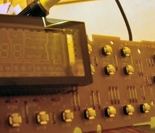

So, 1.5 years has gone and I feel like trying to fix my cd player display again, lol
Today I actually removed the display/control board from it's plastic surroundings (the player's fascia). The display tube has a sort of stained, dark area in one corner - could it be burnt/broken?
I plucked up the courage to measure the voltage going in to the display/control umbelical socket - this was 5v as it's meant to be, so I've narrowed the problem down now.
Perhaps a photo of the display will help, I'll go and take one...
