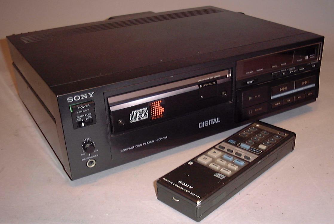

I'm not too sure about being a Sony, it was in a Sony system, but it was this odd 14 bit chipset. The machine was a conventional case, nothing like this amazing CD100

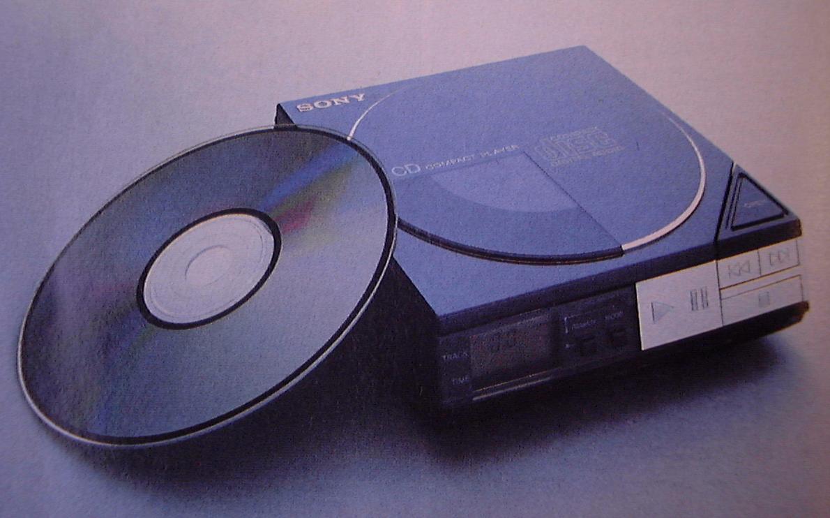

I think you mean the CDP-101 with very thick remote control RM-101 - about
Filmi Sangeet - Film Songs and the year 1982
and attachement.
In the attachement additional the first sony portable compact disc player, the D-5

.............I think you mean the CDP-101.......................
But the CDP-101 uses a CX20017 16bit D/A converter see here
http://www.datasheetcatalog.org/datasheets/120/495279_DS.pdf
As far as i know it was only Philips and Philips clones of thier early machines which had 14 bit DACs.
Percy.
