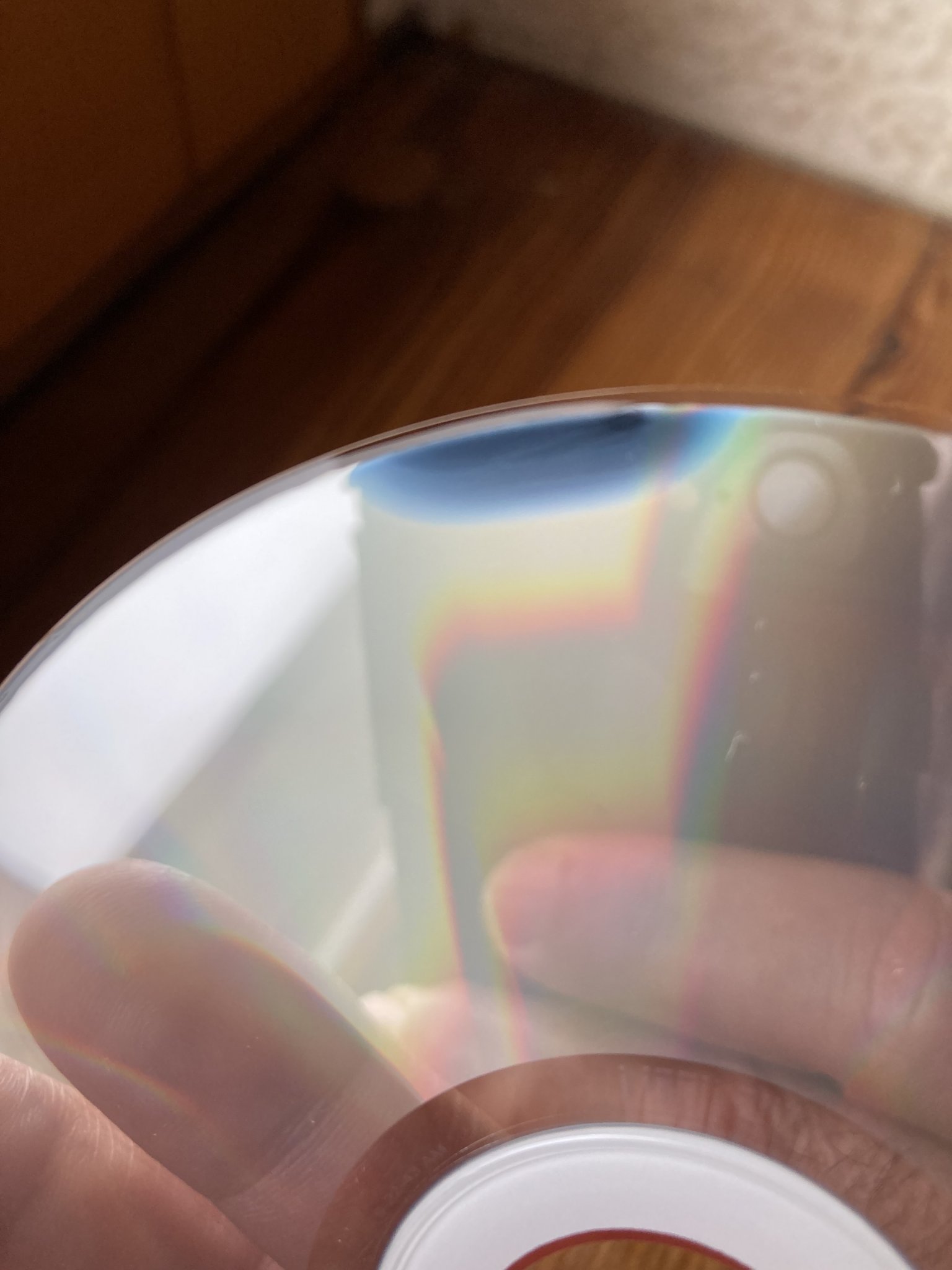

Two days ago I stumbled over a CD that had a clear pressing defect:
A mirror like spot (dark on the photo but in fact reflective), where the pits were missing.
Very likely a defective stamp.
A pity, as the 2019 recording is relatively rare, "Seven Limbs" by Douglas J. Cuomo - see photo
