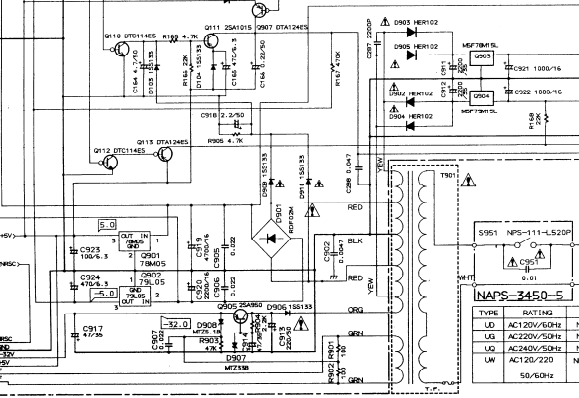

After its replacement I would measure the voltages on the steering and ground lines of the ribbon cables - motors share a common ground (according to the schematic) and you need to know if the tray motor spins because its drive chip is powering it up or because stalled spindle motor is lifting the ground track (voltage wise):

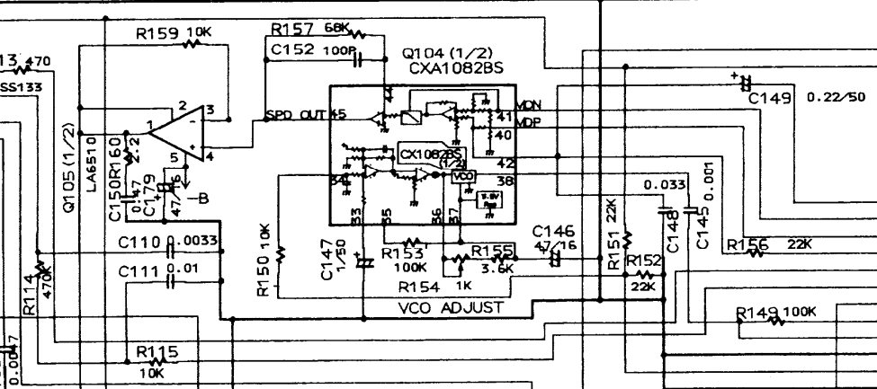

With the spindle/sled motor connected (P103) only, LA6510 (Q105) , the tray motor driver gets really hot. Then when I connect P104 (tray motor cable), Q105 remains hot, and the tray motor spins incessantly, and at a much higher speed.

@madis64 do you mind walking me through how to do that? I tried looking at youtube "testing CD player voltages" but didn't come up with anything useful. I would appreciate it very much. I know enough to get a multimeter and switch to the DC mode but that's it:
1. where should I attach ground? anywhere on the chassis or any ground point at P103 or P104?
2. i should attach the other probe to SPD on P103? and probe pin 5 of LA6510 (spindle / tray motor driver)?
3. Should I probe the outputs of the +5v and -5v outputs on the regulators as well? (79L05, 78M05)
4. When checking IC protector QF101 and QF102, I should check for continuity?
What should I be looking for in all the above instances?
I had assumed that the servo circuit operates on the 5V rails, but looking at the LA6510, it mentioned 15V supplies. I did change the 4700uf and 2200uf at the 5V regulators already, but not the 2200ufs at the 15V.
Thank you very much.
Ok, I managed to figure it out without blowing up stuff. Outputs of pos and neg regs are correct, +5 and -5V. The IC protectors are not open.
Voltages of LA6510 when the tray and spindle motor are connected :
Pin 1: -11
Pin 2: -11
Pin 3 : -11
Pin 4 : 0
Pin 5 : -14
Pin 6 : 2
Pin 7: 2
Pin 8 : 4
Pin 9 : -6
Pin 10 : 14
Voltages of Q104 CXA1082BS
Pin 1 : 5
Pin 43 : 5
Pin 44 :0
Pin 45 : 0
Oh, I mean I managed to check the voltages without shorting anything. I haven't been able to reach any conclusion, other than there are outputs from the regulated 5Vs and that the IC protectors are not blown. I appreciate help deciphering the voltages.
I think that the CXA pins 44 and 45 control the spindle motor and there is no voltages at both. On the motor driver itself, pin 3 (spindle negative input?) reads -11? And pin 4 (spindle positive input reads 0, which is expected as it connects directly with CXA pin 45. Where does pin 3 get the -11 from? Hmmm.
Ok, I will try my best:
At around 15V supply, LA6510 can output around 13V. Which, I think, is correct for the spindle motor, if Vout is the difference between V+ and V-. I still can't figure out where the 11V comes from in pin 3 though.
But , in this case, the tray motor Vout would be wrong as difference between V+ and V- should be 0. Unless I missed out a -2V somewhere, in this case 2 - (-2) would give 4V, which would then be correct.
I apologize if my answers are too amateurish as I have no formal training in electronics. I am a biology lecturer by trade. Thank you!
I changed the opamp LA6510 and the spindle motor stopped spinning! Putting it back together , the drawer is working properly, the CD load sequence is ok up until spindle spin.
