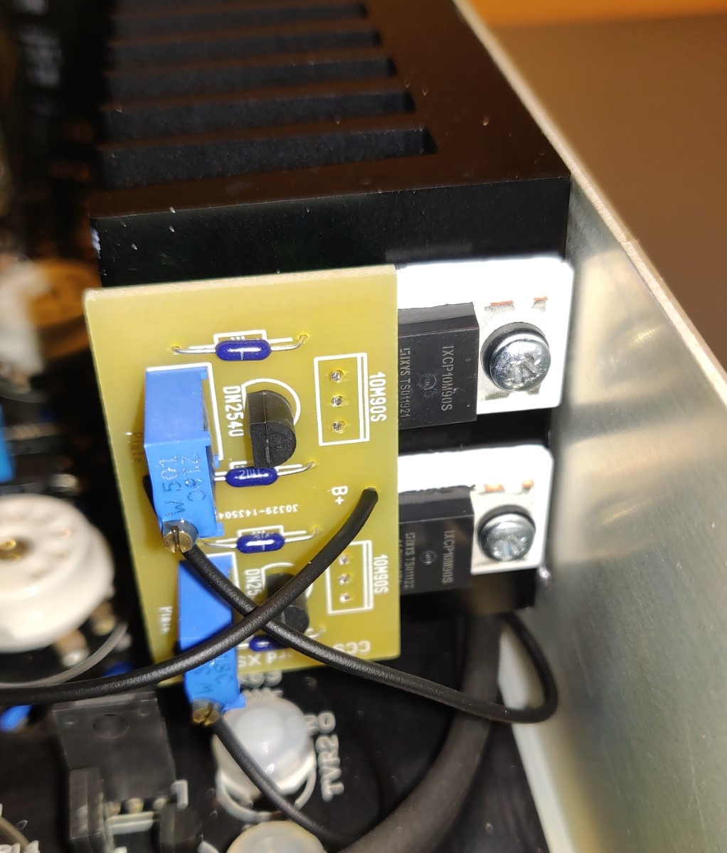

Do you have some pictures of how your CCS are built? Also I recommend 1K gate stopper for the DN2540 - I have had oscillation problems with that part in some instances. Are the stopper resistors mounted right at the gate? How are the devices mounted to the heat sinks?
I have been using a very similar circuit for over a decade without any failures in lots of stuff. If you are using a trim pot in the source of the DN2540 make sure it is a sturdy one that can dissipate the required power., I would recommend shunting it with another resistor so that if the pot goes open your mosfet does not blow up.

Thanks for approving my first thread and for your quick reply, Kevin.

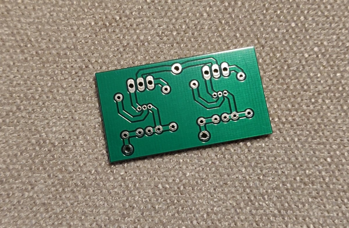

I took some pictures of the CCS in the amp, the back of the PCB and my hand drawn schematic as requested. Please excuse the rather low quality.... the 500R pot is rated at 500mW.
Of course I adjusted and tested the CCS at about 30V DC prior to integrating it into the amp.

Are you sure the heatsinks are isolated? I see the insulation hardware, but very easy for a metal screw to contact both the metal tab and the heatsink. Is anything else mounted to that heatsink?
D
Deleted member 548388
I'm using HV insulation bushings between the screw and the tap of the 10M90S. Certainly, isolation is given for both units per heatsink. The heatsink is somewhat connected to GND of the amp case, nothing else.

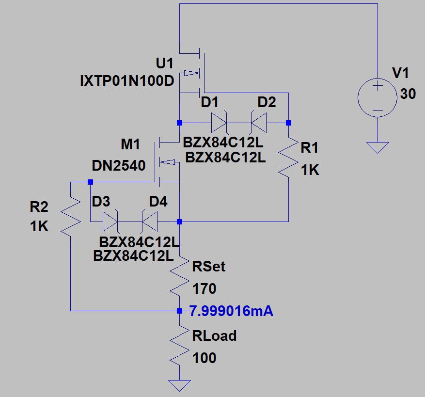

I lost about a bunch of DN2540 in several PSUs around 300..350V, usually at power up.
It was "upper" device of cascode CCS on appropriate heatsink.
Since then I started using in HV CCS 1kV Ixys depletion FETs (mainly IXTP01N100) in this position and none of them destroyed.
Nowadays I use DN2540 as "lower" and IXTP (01N100 .. 08N100) as upper FET (see #3 post).

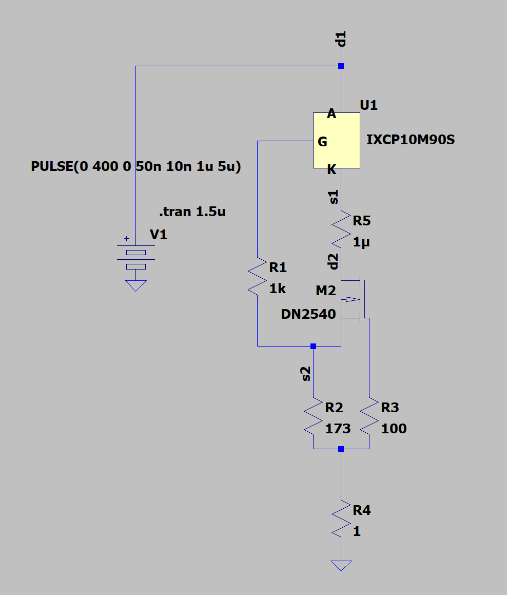

In SY's "ImPasse" balanced preamplifier I have used a pair of DN2540's -- the TO-220 flavor. You have two different devices with two different gate capacitances so it may be that they are charging at different rates.
FWIW, I have had the Ixys devices fail in a Pete Millett "Engineers Amp"

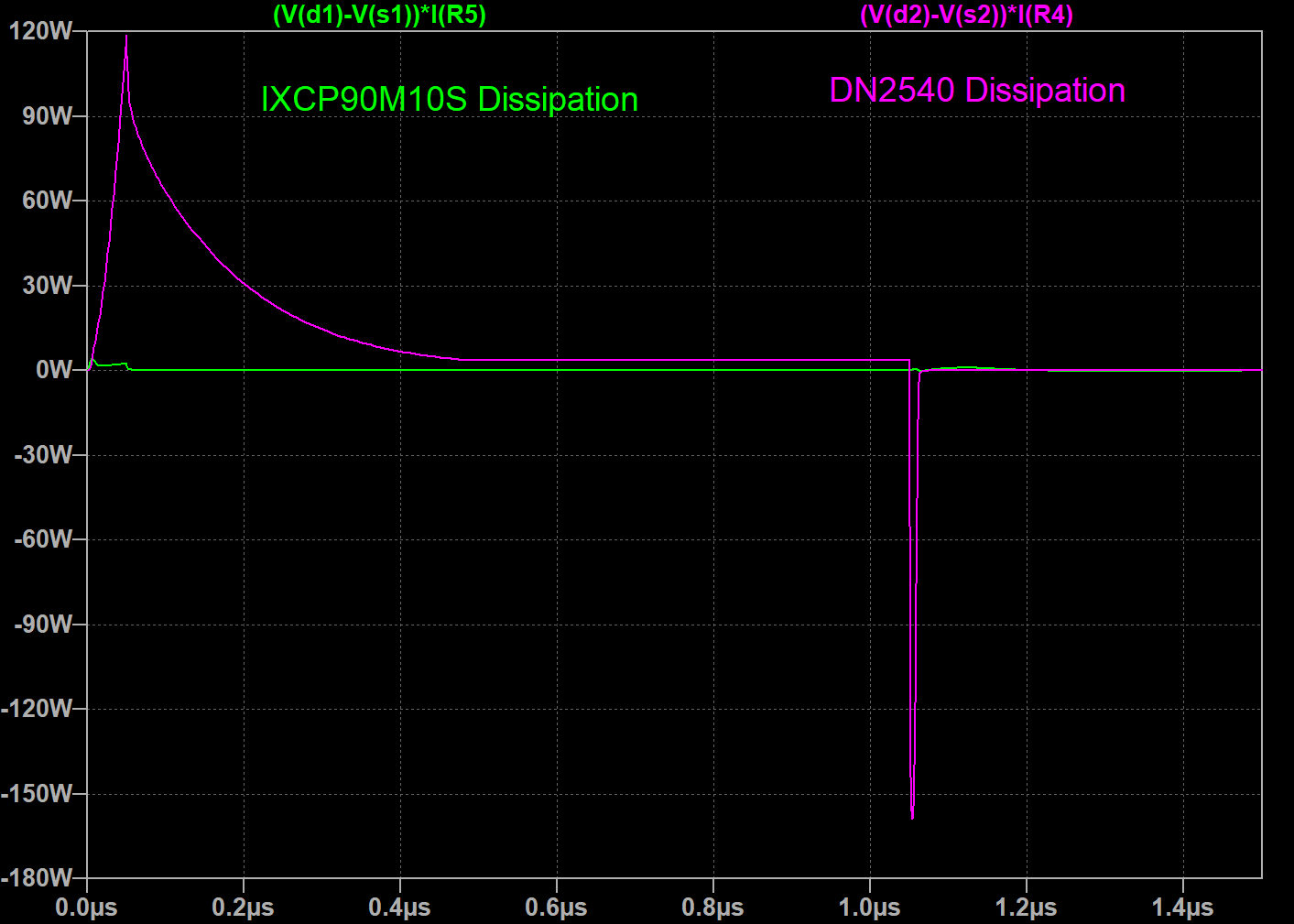

Here's a little simulation of the dissipation in each device at turn-on:

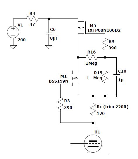

It is strange that the DN2540 often burns out. I have been using them for more than 10 years without zener diodes and none of them have burned out even with 5W dissipation (250V voltage drop, 20mA). Two DN2540 should be rock solid, but I'm not sure about the 10M90S and DN2540.
I would perhaps opt for another CCS because it is obvious that the combination of 10M90S and DN2540 has some problem.
Below is the schematic of the CCS I used in my tube DAC, it is much better than other combinations and has one useful addition, a voltage multiplier for the lower mosfet.
It's a turn-on pulse to see how much energy is being dissipated by both devices. The TO-92 version of the DN2540 can only sustain milliwatts of energy.@jackinnj: What scenario are the dissipation graphs reflecting?
