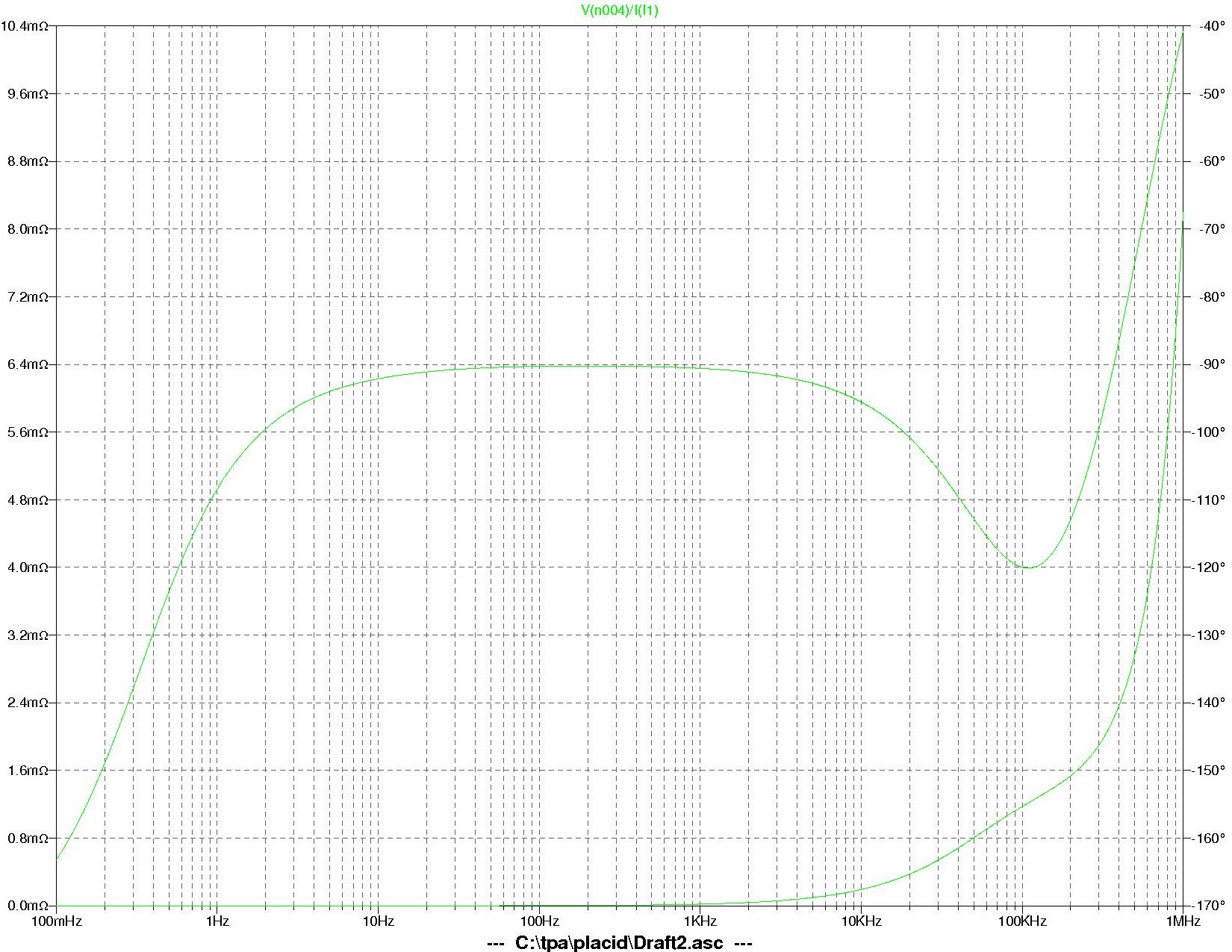

Just for the record here is the simulated output Z of the placid. The real thing is not far off.

Interesting discussion, even if it is well over my head 🙂
Paul: just wondering if you have any specific thoughts on the Placid after seeing the simulated output impedance?
Somehow I missed those plots. Where are they?

I do not use simulators but prefer realtime measurement and testing as well as listening to the results in any trials I do. As Russ mentioned, simulations can be a little optomistic compared to actual measurements because actual layout, wiring etc can have profound influence on the final result.

Everything is fine. No worries. As long as the conversation remains constructive and respectful I am happy to continue it.
I did actually test the real output Z of the Placid using a power amplifier to create 20ma peak sine and square wave loads. I then used an instrumentation amp with 30db gain to look at the error voltage. It was virtually undetectable until about 20khz.
based on my calculations the output Z is very close to the plot posted. Still I would be more than happy if someone with more skill and better gear then I have wanted to measure the thing.
