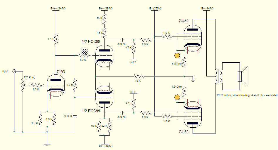

I have an amp using a long tail phase splitter. I am terribly unhaapy with the performance.
I want to use a ccs.
The circuit is half a 6sn7, directly coupled to an ecc99 ltp with a 10k tail
I am not very good with ss design, so i decided to copy the a css
How do i manage to get the gorrect voltage at the kathodes to keep the direct coupling?
Or should i decouple with a cap?
I am not unwilling to do some calcs, i just need a few pointers

You don't need to worry about the cathode voltage, the CCS will sort that out automatically. Once you add the CCS, you will need to balance the anode load resistors of the phase splitter.

Balance the anode loads. Match them if you like.
You will have to make a CCS from scratch because it must withstand 100V or so. Unless AD have changed their policy, they don't make valve support circuitry...

IXYS makes a CCS that is rated at 450V. IXYS 10M45. Sold at Digikey etc.
Texas Instruments makes a linear regulator that can be used as a CCS and will tolerate up to 125V between in and out if you need alot of current. TL783.

The simplest CCS by far is the IXYS 10M45 chip. It works good too. Get the amp working with it, then you can upgrade if you want.
You need two resistors and the chip. The resistor from the "K" pin to ground sets the current, and you need a 1K resistor in series with the "G" lead to supress oscillations. The "stopper" resistor is not shown on the data sheet, but bad things happen if you don't use it.

Although that is not going to be a perfect splitter, your problem may be elsewhere: your 330nF coupling cap and 47k grid leak frot he GU50 make a 64Hz highpass filter. This REALLY needs to be MUCH lower. Although seeing that you use pentode mode with no NFB or even local FB, are you maybe attempting to equalize the resonant peak of your speaker?
Quite easy actually, just set your CCS to the same current that passes through the 10k tail resistor now. That way the DC conditions remain unchanged.

ARGH my bad - it's not 64Hz but 10.2Hz, sorry.
Still, maybe there is a mispring with the values - 47k as grid leak does sound a bit low, even for large tubes. Was it maybe 470k?
The frequency is easy to calculate - 1/(2*PI*Rleak*Ccouple). Still, even 10Hz sounds a bit on the low side if you intend to use NFB, unless it is taken as plate-to-plate from power tubes to splitter. You are adding phase shift where you already start getting some from the OPT, so you could get in trouble - but this depends greatly on OPT.

I knoe few things obout the opt, they are excepionally BIG. C-core. They came from a beard kt88ppp 100watt amp.
I'm not sure what that means in terms of phase shift, but i know that it doesn't require the feedback because i starts to drop too early in the bass. If feedback is implemented it must be to lower Zo because my speakers might like that.
The original circuit has 39K resistors going to bias supply.
I am totally in the dark here, but would 470k be better?

Looking at mu curves and bias power supply, it is obvious that my power supply can't deliver much current, and as far as i ca see, the grid current is not very high...

Measuring with my tone generator and a scope, i don't see any early dropoff. I even remember it dropping below -6db at 8Hz

I am burning up about 105 volts in a resistor. Penthodes make good ccs's....i have a few penthodes...LTP with penhode ccs?

It's doable and can work quite well. Pay attention to maximum compliance and heater-cathode ratings.

Take a look at Morgan Jones's "Valve Amplifiers" for some specific examples, and Langford-Smith's "Radiotron Designers Handbook 4th edition" for detailed info.

This thread shows a pentode CCS in the cathodes of a 6SL7 long-tail pair splitter in my amp. The key is to use the pentode at an operating point where the plate curve is essentially flat, i.e. the plate current doesn't vary singnificantly over a wide range of plate voltage. In this case, plate current in the 6AU6 is a bit less than 2 mA, screen-cathode voltage is a little under 100v and plate-cathode a little over 110v.
thanks! I'll go and have a look at my penthodes!
one thing that strikes me that i might have to lower the current through the ecc99, or us e avery beefy penthode....
