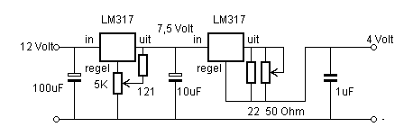

Hello dsavitsk,
You can try this.

dsavitsk said:
I am looking for a CCS design for a 5V/250mA filament (71A). Does anyone have any suggestions? I'll be using a 6.3V/3A winding with a voltage doubler to get the raw DC supply.
Hi Doug,
I'm just using a single LTC1086 per channel configured as a CCS at 250mA. (w/71A) Current setting resistor is right around 5 ohms. (Trim as necessary to get 5V across filament when warm.) Schottky rectifiers and a 10000uF cap up front, and a 100uF across the output. (Optional - many claim this is not a good thing.) The transformer has 8V secondaries IIRC, and the raw dc supply voltage is around 11V. No audible hum, IMO sounds as good as anything I have heard for dc filament heating..
I no longer use CMC either, but it might provide benefit if placed before the CCS - maybe even between the transformer and rectifiers, particularly if you are using toroids. (I assume you are not using toroids, but thought I would mention this in case you wanted to experiment anyway.)

kevinkr said:
Hi Doug,
Sounds reasonably simple. Since I have a little extra voltage due to the doubler, do you think it is worth pre regulating? This will be (another) headphone amp, so hum needs to be pretty close to 0.
No toroids here -- EP throughout (PT and input choke), except for the outputs which are from Dave Slagle.
Hi Doug,
I'm not using any filament pre-regulation in my 71A based headphone amplifier, and the noise floor (without any output attenuation) is so far down I can't reliably measure it with either my Amber 3501A or my pc based fft analyzer.
This is used with a pair of 5842 choke loaded driving a pair of 71A. Dead silent at the outputs. (No hiss, hum or buzz at all.) PSU is tube rectified CLC and is located in a separate chassis.
A pre-regulator won't hurt provided you have enough voltage headroom which I suspect you might be marginal on. You need at least 4.25V across the LTC1086 including the 1.25 across the current sense resistor for really good performance, and slightly more is even better. To work effectively you need about 12.5Vdc under load at low line, regulate down to a hair over 9.25V - if you can provide this then you are golden. A single pre-regulator ought to be fine with a pair of CCS..
