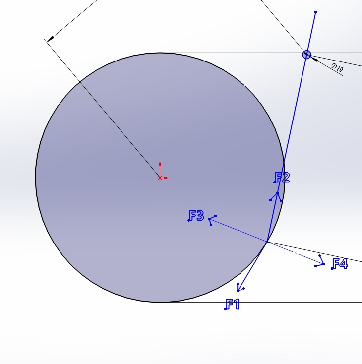

To make the explanation easier to understand, I drew a simple force analysis diagram.
Since the largest number of players use fulcrum tonearms with fixed rotation points, the analysis in this article only focuses on this type of tonearm.
The cause of the side skating force is shown in Figure 1. When the record rotates, it rubs the needle tip of the record to generate friction. This force is the tensile force F1 acting on the tone arm in the tangential direction of the arc of the record due to the design of the tone arm compensation angle. The tangential pulling force F1 and the tone arm pulling force F2 are not on the same straight line, so the resultant force F3 of F1 and F2 is generated, which we call the side skating force for short. (The accompanying pictures are drawn at random, for demonstration purposes only, and the sizes and angles are not completely standard)
Based on the physical law that the greater the pressure, the greater the friction. The greater the needle pressure, the greater F1, the greater the tone arm pulling force F2 back, and the greater the side skating force F3.
