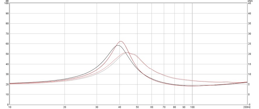

The latter, so personally would cut/pull it apart into pieces to damp the bottom, one side and back panels to 'taste'.
Thanks GM. These sealed cabinets are fully stuffed, but some of the stuffing is flattened enough to leave voids in the upper cavity above the bracing. I'll add some stuffing when time permits, but in the meanwhile here are some measurements.

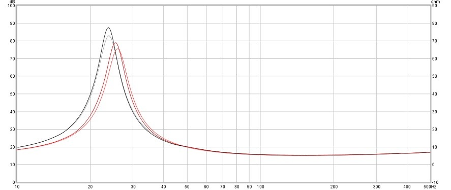

Black is the left woofer in 2021, 23Hz, 87 Ohms free air.
Grey is the left woofer in 2024, 23.8Hz, 83 Ohms free air.
Red is the right woofer in 2021, 25.5Hz, 79 Ohms free air.
Pale Red is the right woofer in 2024, 26Hz, 75 Ohms free air.
Below, the woofers compared when loaded into the same enclosure, 2021 vs 2024. This is where something seems off, as the impedance peak is 45Hz, rounded and flattened. The acoustic output suffers as a result.
