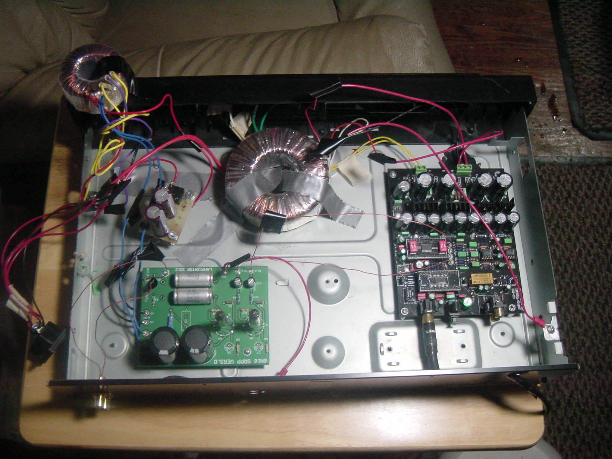

In any case, I have included a picture of my DAC (remember I warned you - it will be ugly!). You will notice two toroidal transformers: the big one powers the original DAC with 2 voltages, the second powers the Lampinzator. The input comes from the DAC port on my CD63 into the original DAC.
I built the DAC before I built the Simple SSE. During the build of the amp, I heard of having a common ground point. I just noticed that the DAC grounds are all to the chassis, but at three different point. Is this a problem?
Being my first non-kit build, I also noticed that I didn't twist any of the wires. Maybe that could help.
Also, the wire that connects the output of the original DAC to the Lampizator is over 9 inches long. Could that be a problem?
Someone with much more experience could just look at my "project" (I use the term loosely) and see ways to improve it. I am open to suggestions.

The wires that goes directly from the dac output (please confirm) should at least have a return path in very close proximity, preferably twisted pair or co-ax.
I presume they are the two thin brown wires?
Is there any filtering on the output of the DAC or have you bypassed it to go straight to the add on board?
Make a test with a sine wave signal, for example generate 1kHz, burn it to a CD and check if you still get the oscillations.
Your audio signal wires are single core wires. You need coaxial wires with the shielding of the wire connected to the grounds of the DAC and your tube stage. The wires that go from the output of the tube stage to the RCA connectors needs to be coaxial as well. I also notice that you are connecting the ground wires from the secondaries of your transformers to the chassis in 3 points but cannot make out a grounding scheme from the picture. Are your grounds connected correctly ? You might have floating grounds .
How are the tubes fixed and connected to the PCB? I do not see tube sockets. Perhaps you are getting microphony here.
They're miniatures and soldered in directly.

The original (unmodified) DAC board did not require a ground. When I added the Lampizator, I got a ground loop. Once I grounded out both to the chassis, most of the hum went away. Possibly, I still have a ground issue/floating ground. I could use a common ground point (as opposed to the 3 chassis grounds points I am using). Would this be the “correct ground scheme” that you refer to rrremus (BTW, you can’t see it from the picture, but I have a wire directly from the mains ground to the chassis)?
Burning a CD with a 1kHz signal sounds like a great idea! I will try that if other ideas don’t work as well as hoped. My electronics friend may help me here with his knowledge of the O-scope.
I don’t believe that there is any filtering of the output from the DAC. The brown wires from the original DAC are the signal wires. They come from the L- and R- points on the board. There is no provision (per the above instructions) to use the L+ or the R+ points, assuming that is what you mean. This whole Lampizator idea is very non-conventional. But I like the sound.
The signal wires from the tube stage to the RCA outputs are unshielded. The RCA grounds are connected directly to the chassis. Maybe a common ground point will help here.

The link gives two 'Lampizator' circuits: a poorly designed cathode follower, and a cathode degenerated amplifier. The former will add distortion, and the latter will have too much gain. Which one have you built? Neither has any HF filtering, so I hope the DAC board does that.
A poorly-wired cathode follower can suffer from parasitic oscillation. Adding grid stoppers or cathode stopper resistors may help.
