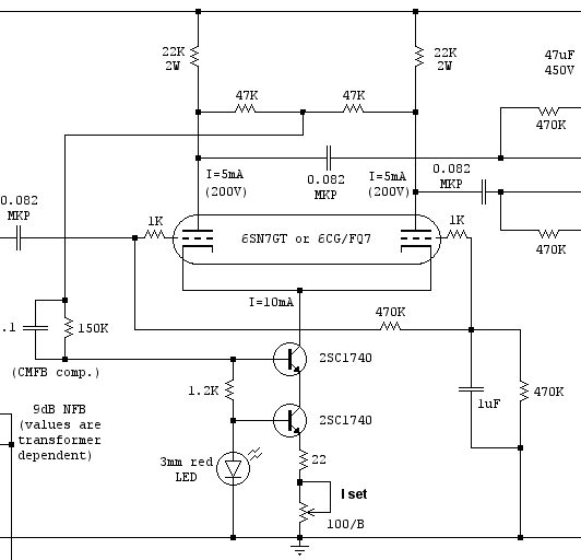

If you want a CCS to help give you perfect balance, you'll probably need to change the topology and include it in a common-mode feedback loop.
Imbalance in this circuit was 20mV P-P with a 60V P-P output. Tube sections weren't even matched.

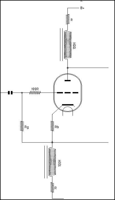

So to phrase it another way. I think I'm looking for a method of providing a high AC resistance while still getting power to the tube. That should keep it stable at DC but allow the advantages of a big plate load.
So as an alternative, what's wrong with using a couple of chokes instead of (or to supplement) a resistor pair? OK. theres all the problems associated with choke loading and so on, You need a big (expensive) choke too, but could it work? Would it be beneficial?
On the other hand it is difficult to see how to 'beat' a couple of matched resistors. particularly for what might be very little improvement.

OK So CCS's are not a great idea here and I actually *think* I can see why... this is above and beyond the extra complexity they entail.

Chokes would have to match perfectly at all frequencies in the desired pass band or unbalance would result.
You have pretty much answered your own question.. 😀
Stick with resistors or choose a topology like the LTP with a CCS in the tail.

Geek said:If you want a CCS to help give you perfect balance, you'll probably need to change the topology and include it in a common-mode feedback loop.
Although I have theological misgivings about this differential topology (the inverting part gong through a second triode) The 20mv mismatch is not to be sniffed at. Would you care to explain how the the CMFB loop is working? Or point to where I might look for some more info.
Cheers
Andy
Fred Nachbaur's design is quite well explained. He used a pentode for his CCS but the principle is the same. I use a pentode without the CMFB bit and it works OK.
ray_moth said:Fred Nachbaur's design is quite well explained. He used a pentode for his CCS but the principle is the same. I use a pentode without the CMFB bit and it works OK.
That's the one I derived the SS CCS LTP from 🙂

Now that you guys are talking about 'conflicting' CCS's, I have a question regarding a schematic by Morgan Jones (fig. 2.49 in the third edition) It is basically, for those who do not have the book, a double triode in LTP configuration, with a CCS on the tail and two CCS on top, one for each triode, the idea being that they achieve a high plate resistance, with just a small voltage drop from the B+.
My question is...won't the two CCS on top conflict with the CCS on the tail? I mean, the current thorugh both CCS at the top should be equal equal equal to the current drawn at the tail (Kirchhoff's law), and adjusting this, as many commented here, is almost impossible to accomplish. What am I missing?
