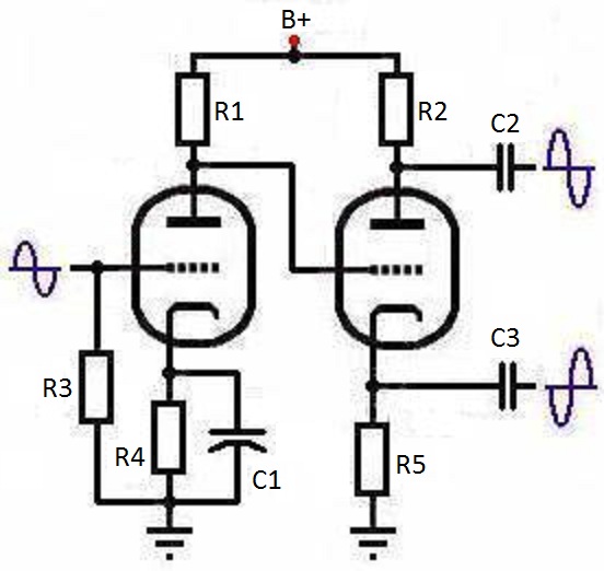

Hi !
Can someone please help me filling in the blanks ?
Looking for unity gain, or close to.
Tube = ECC81 or '82 or '83
B+ = 180V
R1 =
R2 =
R3 =
R4 =
R5 =
C1 =
C2 =
C3 =
I want to use this as a stand alone single ended-to-balanced line driver

The O/P impedance of that style of circuitry is likely to be too high. FWIW, I believe that line drivers should be "comfortable" working into the IHF "standard" 10 KOhm load.

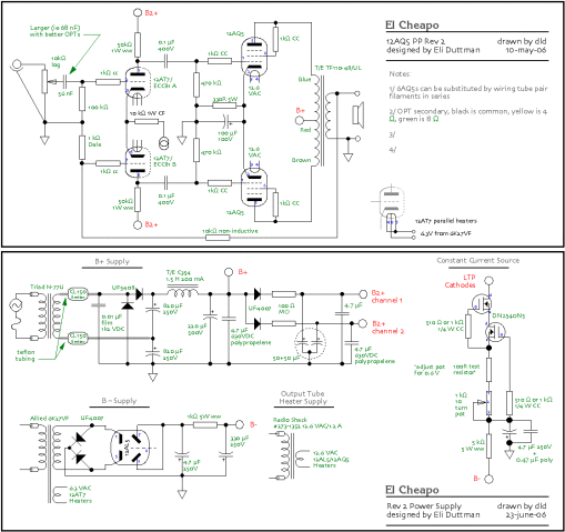

You want SE I/P, some gain, and "balanced" O/P. A differential gain block, AKA long tailed pair (LTP), will do the job for you. Snip out the small signal circuitry from the attached "El Cheapo" schematic. Ground the non-inverting grid. Buffer the LTP with ZVN0545A source followers DC coupled to the 12AT7/ECC81 anodes.

Two problems: 180V is way too low for an ECC81/82/83. ECC83 is not very suitable for a cathodyne- ECC82 is better but has questionable linearity. ECC81 would be OK. Your best choice here is an ECC88, and you still would want a higher B+.
If you can manage 250V, then for ECC88, 15k plate and resistor loads are optimum. Shoot for a grid voltage of ~80V- that will probably mean step network coupling from the voltage amp, but will get you 90V across the ECC88 which is adequate for good linearity. I'd recommend you check out the ImPasse article in AudioXpress and my recent article on cathodynes in "Linear Audio" where I show the effects of loading (the ECC88 as a cathodyne performs superbly even with a tough load). It would also be very worthwhile to work through the math in Morgan Jones's description of the Bevois Valley amplifier in his book "Valve Amplifiers."

ECC88 is definitely the way to go if you stick to B9a basing. I'm working on a similar project, but I'm using 6111 subminiature triodes, with cathode follower outputs, B+ 165 or so. Mine is mainly going to be for moderate to high impedance loads/experimenting with push-pull output stage experiments.

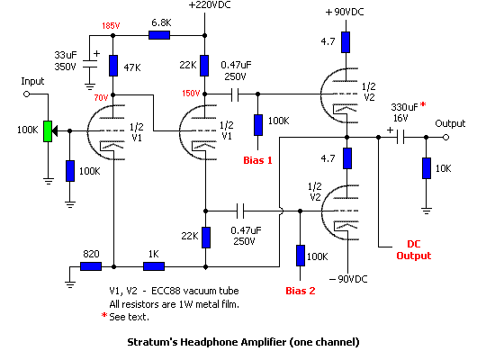

Meanwhile, i found this on HeadWize. I uses a ECC88 as a cathodyne !
but forgive me for this noob-question:
what is exactly a "gain of 25" ?
how does that relate to, say, 2 volts p-p on the input ?

I recently built this little EL84 PP amp...the front end is a nice cathodyne style. It sounds really good. Courtesy of Tubecad.com

A gain of 25 means that whatever is input is multiplied by 25 at the output. So 2V p-p would then be amplified to 50V p-p on the output. With 70V on the first stage plate of the circuit you showed, the distortion would be pretty high. Feedback to the cathode of the first stage can ameliorate that- with the values shown, the gain is closer to 2.
