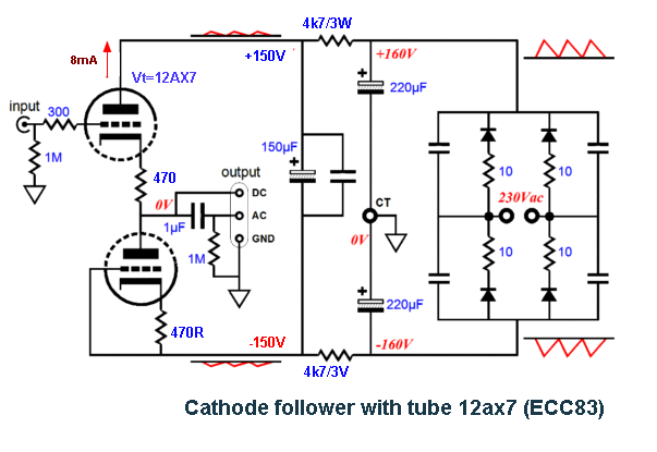

Cathode follower with 12ax7
Hello all!
This Cathode follower given in schematic (see schematic) I need concrete quality schemes a power supply heaters for tube12ax7.
Please give your suggestions.
