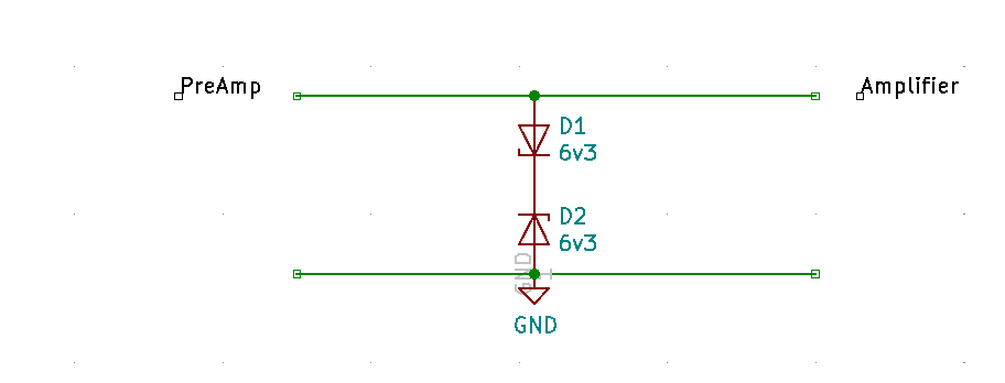

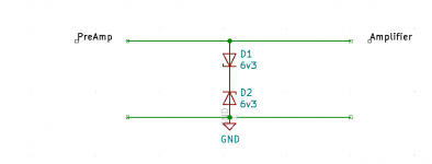

JonSnell,
Good way to do it.
One question to ask is how much transient voltage can the power amp take?
Some Zeners draw a fair amount of current, long before they get to the specified Zener voltage.
That can be a problem for a 12AX7 cathode follower that tries to drive the Zener leakage current (the 12AX7 cathode is not a very low impedance out).
But often a little third harmonic distortion that may produce is OK.
This is a Guitar application.
For Hi Fi, the Zeners must be low leakage, low reverse capacitance (or use two steering diodes, one in series with each Zener, and a steering diode and Zener is connected across the signal, and the 2nd steering diode and Zener is connected across signal, but in the other polarity.
And that allows a low Ohm series resistor before the steering diodes and Zener pairs, to limit the transient current of the cap charging and or discharging.
These are always System problems, not isolated simple circuits.
Good way to do it.

Hi Merlin, why 16 Volt zeners (according to your book). What make you choose this value?

Only because that's what I had in my drawer, and most SS preamps run off +/-15 to +/-18V. You could use whatever voltage suits your application.Hi Merlin, why 16 Volt zeners (according to your book). What make you choose this value?
