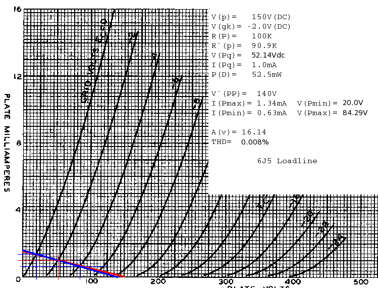

ray_moth said:The 6SN7 is an annoying tube, in that it ideally likes a plate-cathode voltage of 250 V or more, a plate current of 8 mA or more and a load of 47k. This means that to get the most out of it, you would need B+ of around 600 V!
Direct coupling,especially, demands significant compromise in the operating point (not your situation, I realise). Most designers, such as Williamson, have tended to choose a far from ideal operating point because of this.
If the 6J5 is actually half of a 6SN7 (and it would appear that it is) then this isn't true. I did a design using a 6J5 that set a Q-Point current of 1.0mA, with a Vpk~= 52Vdc. With Vgk= -2.0Vdc, and Rp= 100K, it worked just great. That allowed DC coupling without busting any heater/cathode ratings.
The estimated THD is quite low, and the gain a bit on the high side for my purpose. So I figured that an unbypassed cathode resistor would be better, and that gets the THD down even farther. Actual performance was almost exactly as predicted.
Yes a 6J5 is half a 6SN7 and they should react the same in circuit. 🙂
