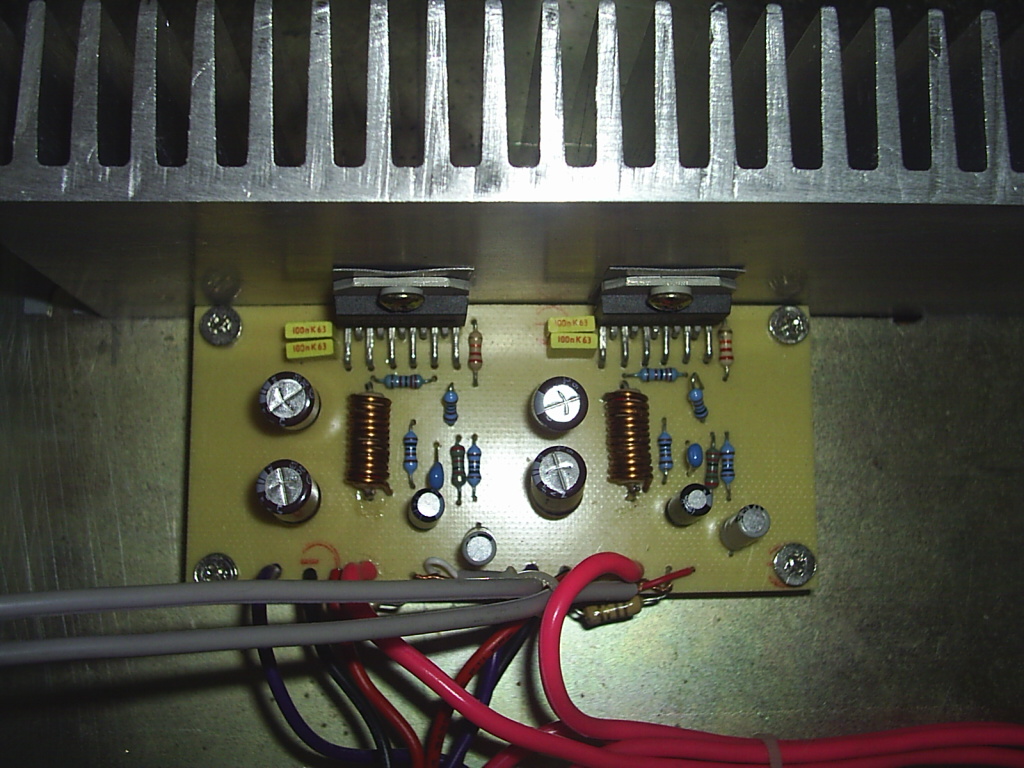

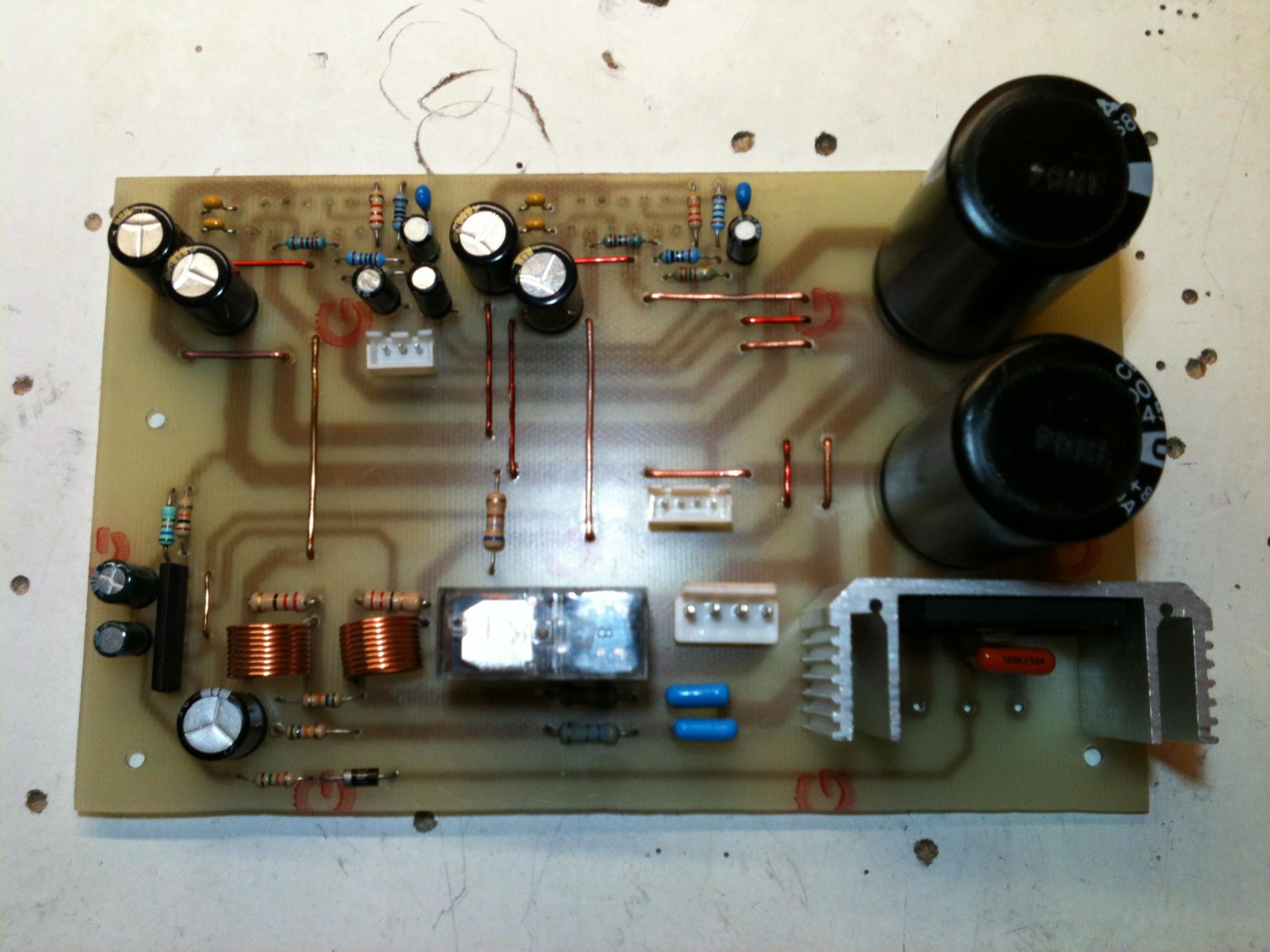

Personally can't recommend a kit, as I designed my own PCB's for the LM3886 based amps i built

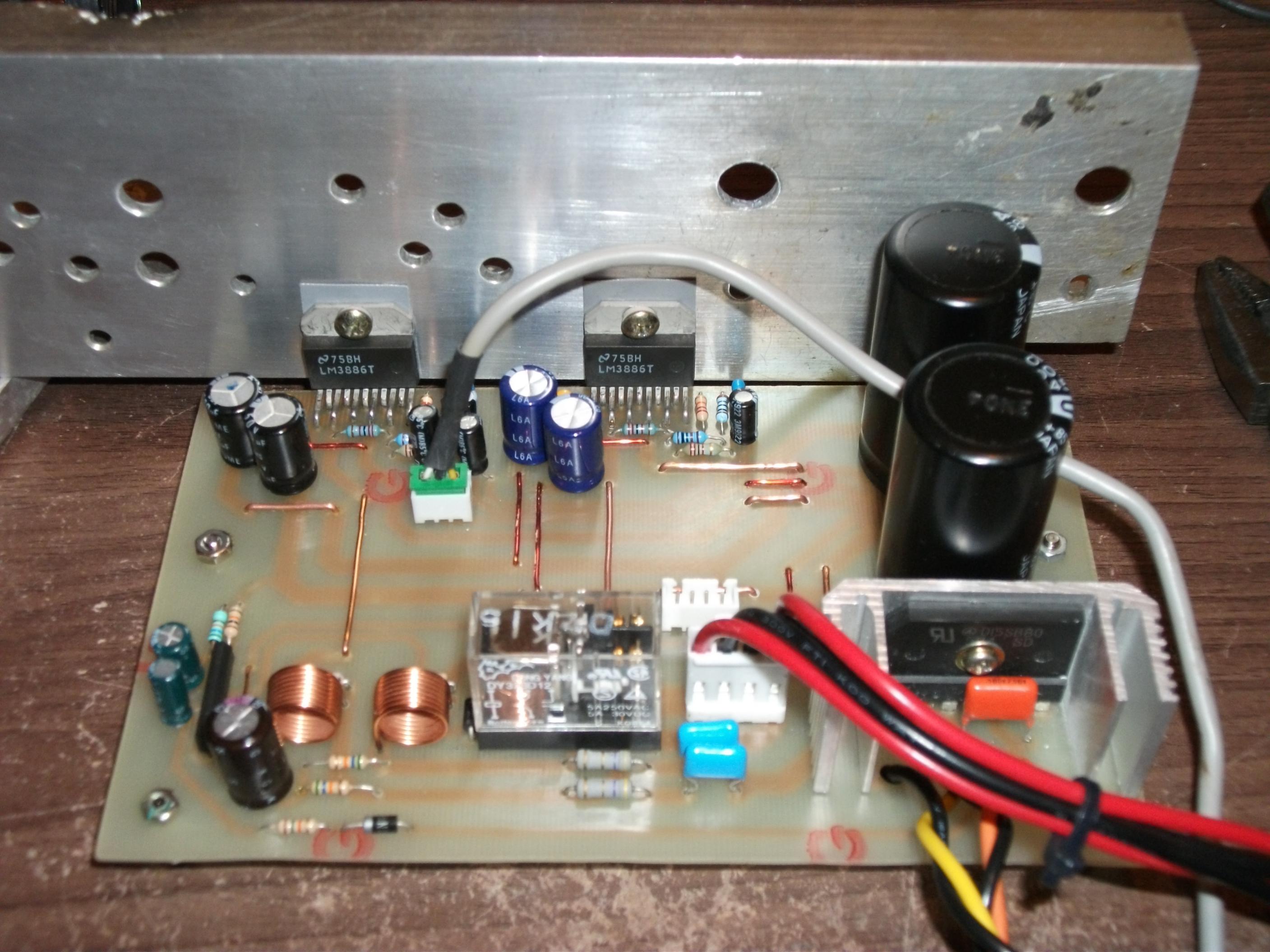

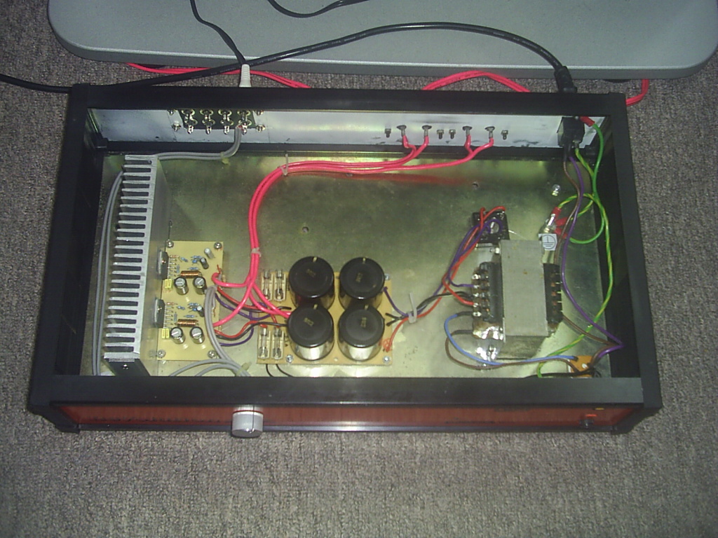

No links as such. The first one I made was a simple smallish PCB just intended to test the chips themselves. Later on I designed a "one PCB" stereo amp with speaker protection, that I built into the chassis of an otherwise-dead Cambridge Audio A1Mk3SE amplifier
