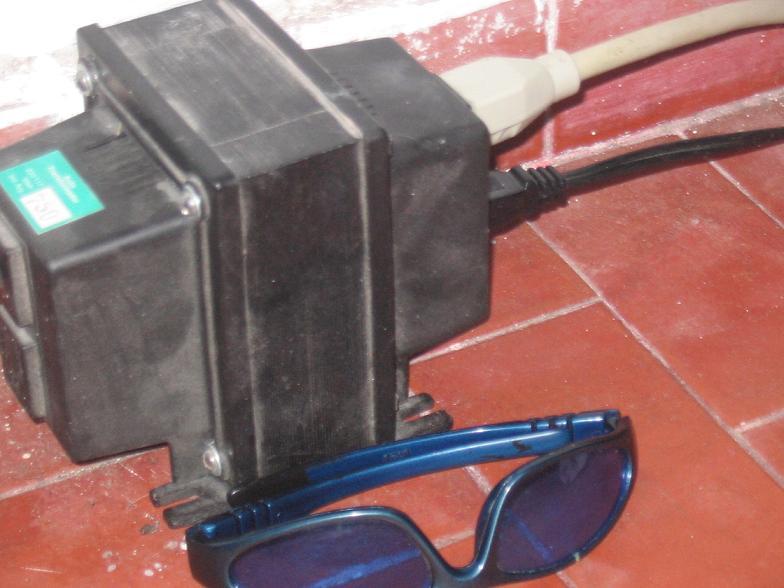

I think someones' confused..I think Lino has 220 VAC wall voltage and his device is a 110 VAC powered...so that would be a step-down transformer.
Here in Argentina we have 220 VAC wall voltage & some of my audio gear is 110 VAC only (Some will 'self switch to 220).
So you'll need one of these! It's rated at 750 Watts more than enough to drive it all (Add up wattages to two thirds peak rating for a buffer) I.E. 525 Watts total, get one rated for 750 Watts.
____________________________________Rick..............
