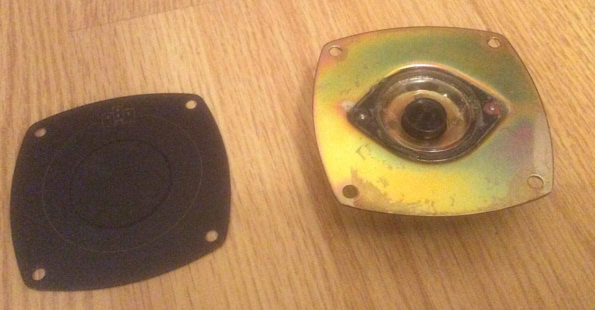

I've found an image of an 'unclothed' Trent II tweeter.
I don't think ferrofluid replacement is an option - replacement tweeters would be the best option.

I found the 'naked' picture on this previous thread where the Monacors were found to be good replacements for the Trent tweeters: Castle Trent 2 Tweeter
Note the final outcome in post #24 where attenuating resistors of value 1.0 ohm and 39 ohm were added to reduce the output of the Monacor slightly.

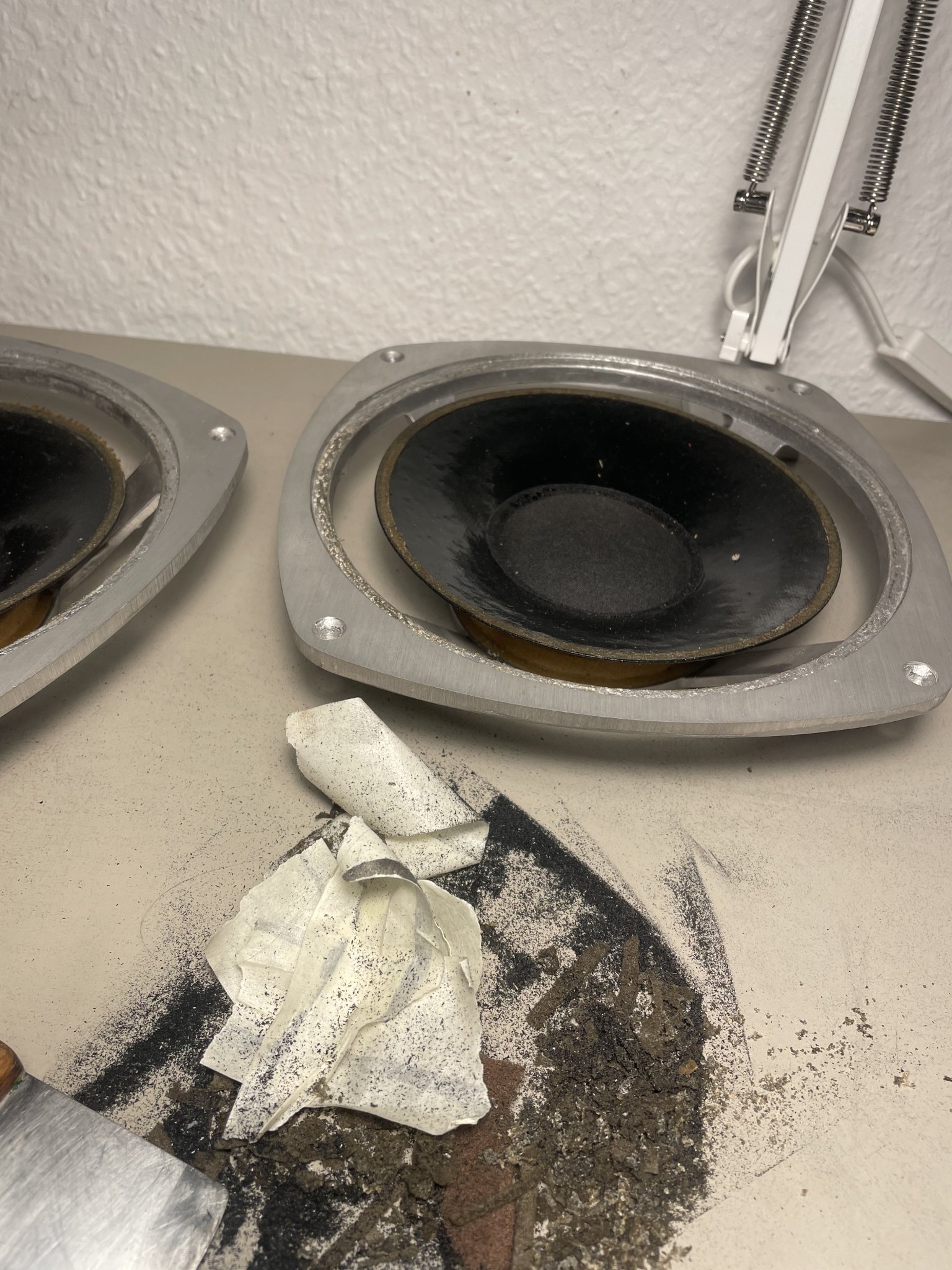

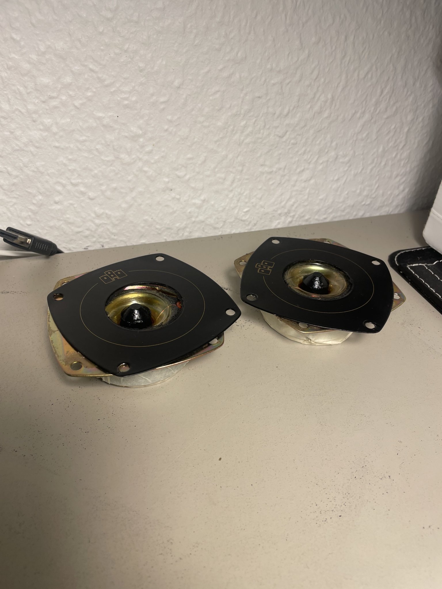

I just cleaned of ”all” ferrofluid from my identical tweeters for Dover. Ordering new ferrofluid and will se.STOP PRESS!
Thanks @Urlocksoim!
Could you describe, perhaps by referring to the image in post #8, how you dismantled the plastic cone tweeter in order to clean out the ferrofluid?

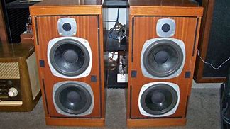

P.S. I hope your Castle Dover loudspeakers (stock image shown below) will start singing again for you soon!
Unfortunately I didn’t see the gap and possibility to divide them, so I cut the fabric🫣. Then you use pieces of paper to suck up the old ferrofluid. Don’t go to deep, the coil.
