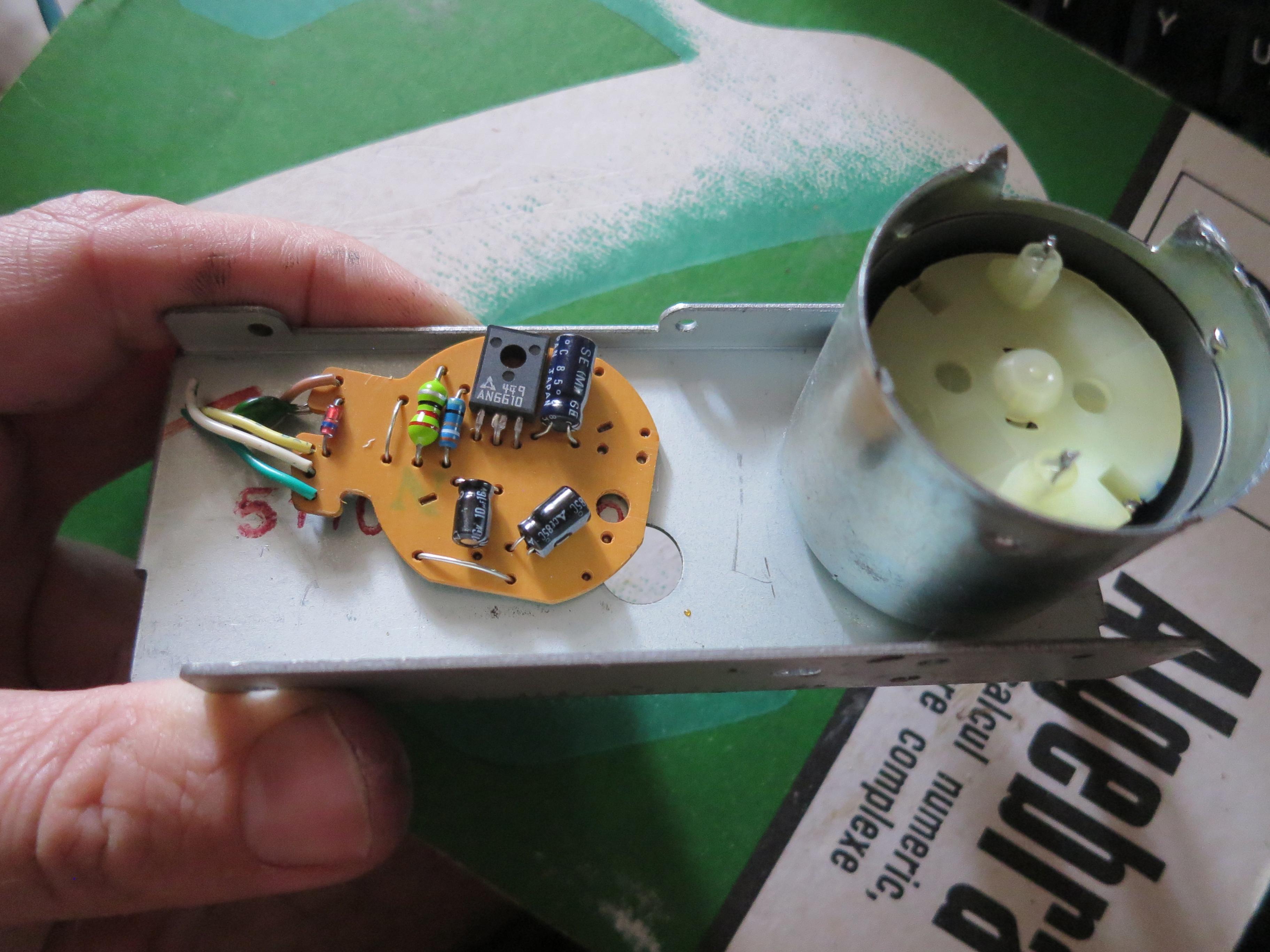

I tried to identify which casette player is but no succes yet.I have other mitsubishi motors from the same series with only two wires, but that can't help too much unless i open them all which isn't really the best option right now. The LKWG series seem to be of better make mechanically.
It's actually a 4 wire motor where the orange wire is in series with a 20nf cap, a diode and the red wire which may actually mean it' a 3 wire motor, the fourth being used for monitoring something
I thought that was weird until i found another two motors (Mitubishi mxmi-6b2hwa) with 4 wires , an external transistor attached to the case and two trimming pots for 2 speed , but at least for that one i have the manual as i know from which deck they are, yet i need the motors in the title for an experiment as they look like high quality ones.

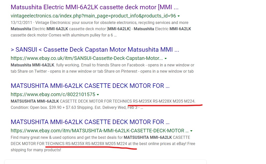

I wouldn't like to guess but you could try powering it up with a current limited supply set to about 30 milliamps. I've replaced countless motors over the years and they were normally just a 12 volt supply with presets added between two of the leads for speed control.
There may or may not be a preset behind that hole as the motor case and back were common to many versions.
Try and find a service manual for one of those Technics decks and see what they show.

I need to make some use of two identical motors from some unidentified yet double deck cassette player and i don't know the wiring.Can anyone help with some information?
May this can help you. it seems to be similar to yours..
Motor Wiring MMI-6h2lwk - Google Search
jut realized one is the H version, mine is a version and it's not exactly the same thing but i'll try figure out what they are.
As i had 2 of them and needed just one, i opened one...it proved to have a smaller fully encased motor inside...so an6610, but now that i know the motor is smaller i'm thinking of some more modern ones...

Yes, i know that.Thank you!AN6610 Application Circuit under Other Circuits -58970- : Next.gr
AN6610 is a speed controller
The motors had no problem until i took the decision to open one of them and ruin it completely to see how it's made just to evaluate how good the other one will be for my experiments.I'll be using a direct drive one recovered from a sony deck instead.Can you tell me what the problem is with the Motor. doesn't it start or ???
