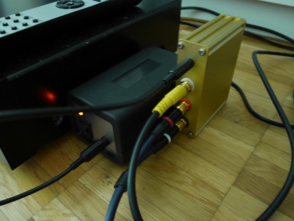

it was put to one side for a year or so, finally finished..
part numbers are for farnell.
5v power lead
1218587 NEXANS MC5023 BLK (30cm)
1568398 LUMBERG - 1633 02 HOHLSTECKER 2.1X5.5X9.5MM (qty 2x)
5v PSU
1876460 1210BK ENCLOSURE, ABS, BLACK
2080477 6160.0004 INLET, IEC, C8, 2571, 2.5A
1695858 A8MD-1162 OMRON SWITCH, ROCKER, DPST
1105238 MC19021008 LED INDIKATOR, 3MM ORANGE;
1243246 LUMBERG - 1614 09 - CHASSIS BUCHSE, PSU EINBAU-MOUNT 2MM
DAC
1418582 B2-080GD GOLD, 109X30X80MM
(EBAY) neutrik rca sockets red, white and black
