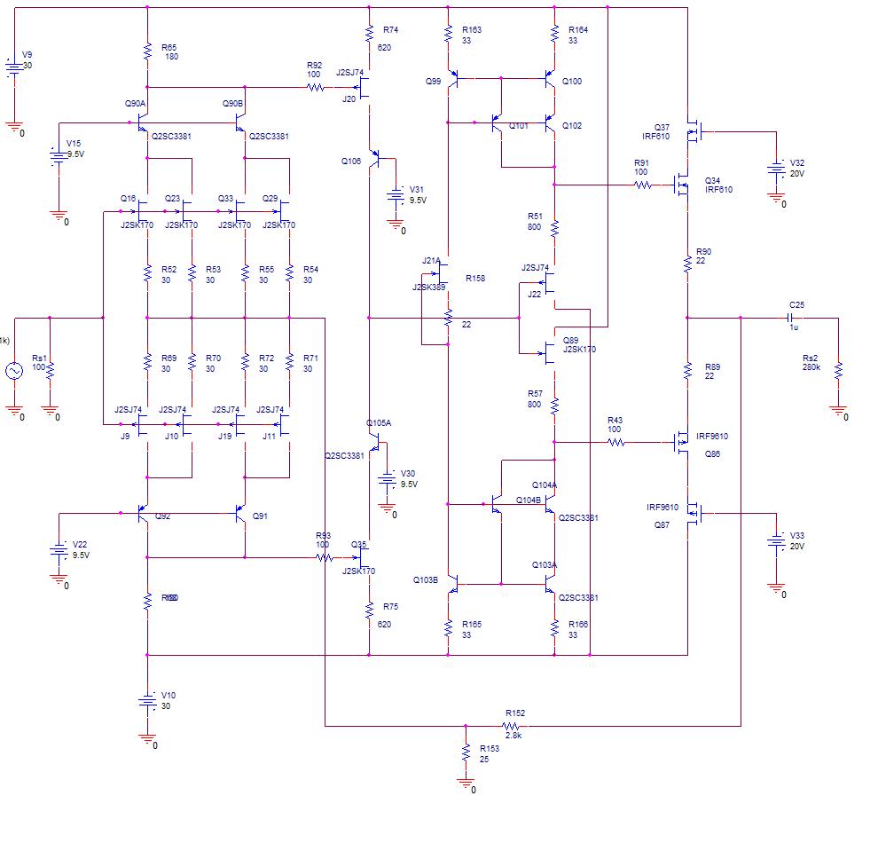

Anyways, the circuit attached is the the MC front i am working on.
With such values i can get 0,00125% THD @1KHz @2V.
Gain is 39dB.
Frequency response: 0.1Hz-820KHz.
DC offset after coupling cap is 0.3mV.
(all the results above has to be intended with matched pars as wihtout them it really differs form that)
Anybody, please feel free to comment on it, if there is any advice on how to improve it,please go ahead.
For the current mirror that biases the output stage i am still playing around and i have changed it a little bit from this schematic as i am still evaulate which one fits the application best.
I have one question: where do you guys think i can control the DC offset?
With the current circuit, before the LP filter i have 3.5V.
Stupidly, but i don't know where an elegant way of zero the output be 🙂
Gain is 39dB.

Or maybe they are completely overwhelmed by your very nice design (wich by the way looks very much like what I am working on right now).
Here is my suggestion:
The obvious non-trimmer solution would be a servo.
And if you don't want it to disturb your feedback path, you could just make it control the current in your CCS' in Q100 and Q103.
(I have never tried something like that - it was just an idea.)
You could even just replace R164 or 166 with a trimmer, leaving your R74 and R75 to your calculated value, but a servo would also take care of temperature drift.
By the way : Why did you quadrouble you input jfets, instead the VAS or driver jfets? I would say that if any of these needed to be paralleled it would be the driver jfets Q89 and J22. The IRF fets has heavy Ciss and therefore needs heavy current. I recall that they need something like 17mA driver Idle current to be happy. ( most japaneese consumer electronics uses something like 3-5 mA but thats just not enough for high-end sound)
Besides: You should also cascode the drivers, or at least do something to lower their drain voltage. 2SJ74 only does 25volt Drain-gate-voltage, and 2sk170 40v. At maximum voltage swing you have something like 50V peak to peak.

Hi thanks for your post.
I am glad you find the schematic interesting.
1) the inpute jfet are paralleled to achieve lower noise.
The cascode will re-balance the increased input capacitance
--> with regard to this aspect, i don't know if you ever tried this solution: is it better to have just one global cascode for all 4 devices or 4 cascodes (i.e. one for each device)?
2) Why do you suggest it would be better to parallel the drivers? what would the benefit be by doing that?
3) I just don't like the idea of servos. they affect the sound and whenever it is possible to avoid them by just trimming...that would be the way to go for me. As i said DC offset is lower thatn 0.4mV without casing.
I haven't connected the other 25dB of gain stage of the phono stage so 0.4mV might still be an issue at the global output....i will evaluate it.
4) i see what you are saying for cascoding the drivers.
I was planning on doing that.
For maximum swing/optimal performance what voltage would you set DS of the drivers at?
--> do you think the voltages i have set for the cascoding shown on the circuit are ok? or shoud i review something?
5) I know, undortunatelly IRFs have high Capacitance. the bias for the output stage is 20mA although i have notices that at higher bias there is high freq issues on the square wave response, but honestly.....and...stupidly i haven't set the VDS of the drivers at lower values. thus they are working on a not optimal point.
Thank you for your inputs.
why the need to cascode the 610/9610 output devices?
Is the dissipation (Pq) just 1% of max Pd?
and yes, j/q22 needs help!!
Why 389 for the mirror CCS? Have you paralleled it for doubled current?
Hi Andrew,
I actually didn't see any benefit by cascoding the output in terms of THD but some increase on bandwidth which is not bad.
The main reason i cascoded was itnended to reduce the input capacitance of the pair.
Sorry, where do you see the 389?
Do you mean the input complementary cathode follower at the front end? the 2 quads?
The main reason to parallel them is
1) achieve lower input noise.
If you want to use jfets to load an MC cartridge you have to do something to lower the noise.
As you know the noise of the 2sk/j at loads lower than 10K is not so low.
A way to go, beside using BJT, is to parallel them
2) paralleling offer higher OLG, still since i don't want it to be so high i have to play with the drain resistor a bit.
J21A with 22r in the source.Stefanoo said:Sorry, where do you see the 389?
Ahh.Frequency response: 0.1Hz-820KHz.
you want/require RF amplification from your recordings!
🙂 sorry, it's just a mistake on the schematic.
It is actually a 2sk170 or similar.
Well...i like to achieve wide bandwidth on my circuits. 🙂
surely there is a sensible limit?Stefanoo said:Well...i like to achieve wide bandwidth on my circuits. 🙂
I like a full decade at either end of the frequency spectrum, i.e. about 2Hz to 200kHz for a power amp and about one octave wider for everything before that, i.e. preamp 1Hz to 400kHz.
Do you need more than that?
Ofcourse - but is it really nescessary? Most amps that uses one pair of K170/J74 in the input still has very good s/n ratio.1) the input jfet are paralleled to achieve lower noise.
[/B]
I have not tried it. Maybe someone else has some experience on this topic....is it better to have just one global cascode for all 4 devices or 4 cascodes (i.e. one for each device)?[/B]
...for increasing the driver-stage Idle without the to92 getting2) Why do you suggest it would be better to parallel the drivers? what would the benefit be by doing that?[/B]
Or you could just cascode...
My point is: This is a more obvious place to parallel than in the input.
So you did actually buildt a real prototype? Nice.3) I just don't like the idea of servos. ...As i said DC offset is lower thatn 0.4mV without casing.[/B]
...I guess you wont be having problems then.
Just make sure your phonostage doesn't have any DC out.
Did you test for temperature and long term drifting? It could change after some hours you know.
Put them at the same ca. 9 volts as the other K170/J74.4) i see what you are saying for cascoding the drivers.
[/B]
I would still parallel at least two pairs for driver though.
5) I know, undortunatelly IRFs have high Capacitance. the bias for the output stage is 20mA ...[/B]
Everybody will say: Go for at least 100mA -150mA.
- cascode output stage what device?
