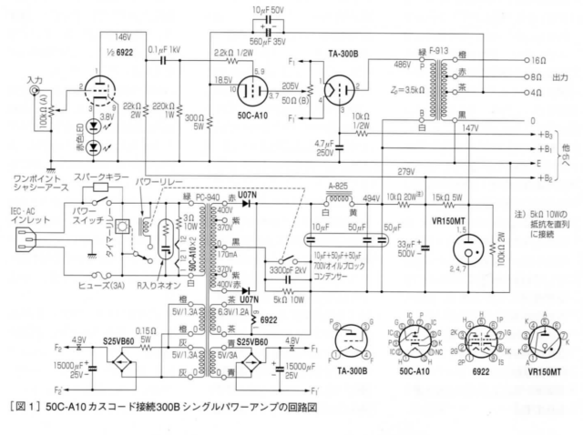

Found this in the "Goldmine" thread on this forum. If I interpret this correctly, it features a cascode output. Don't know many such amps. I can think of several disadvantages when using a cascoded power stage, like high output impedance or wasted power. But what could possibly be an advantage, other than rareness, novelty or can-do-it, so why not ... ?
I would try it, but sincerely I hate led biasing in the first stage. Also, the cathode resistor may return to the transformer's secondary, and discount some few AmperTurns from the primary.
Advantages?
1. Because the 50C has a lower bias voltage, the feedback capacitors are rated at a lower voltage rating than if you used only a 300B (by itself). 300B bias is much larger than 18V 50C.
2. Maybe the cascode has more gain, so there is a higher open loop to closed loop ratio.
3. Maybe the 50C has more transconductance than a 300B, so it is a better negative feedback match for the 4 Ohm tap.
I will not be trying this circuit.
A valid way to turn pretty expensive triode into a cheap power pentode. I do an opposite thing, use pentode stages with nested feedbacks to get the same results like Western Electric achieved crafting geometry of triodes. The result is more predictable, since selecting precision resistors is much cheaper and simple than crafting one tube with high precision tooling.
Should get a resulting triode with approx. Mu' = 3.9 x 8 = 31.2 with gm of the 50C-A10 of 14000 and approx. Rp'= Mu'/gm = 2229 Ohms
Distortion being the product of both tubes in series, would be a bit more than the individual sums of 5% + 7%.
Yeah, as Wavebourn said, $1000 tubes changed into a $5 pentode. And lots of extra heat.
As power triodes are expensive replacing them with triode connected cheap pentodes ... ah no, that's perverted ...
Sure. But pentode amps with nested feedbacks outperform amps with expensive triodes.
You know the classic answer to that of cause.... you don't listen properly 😱 (pun intended)

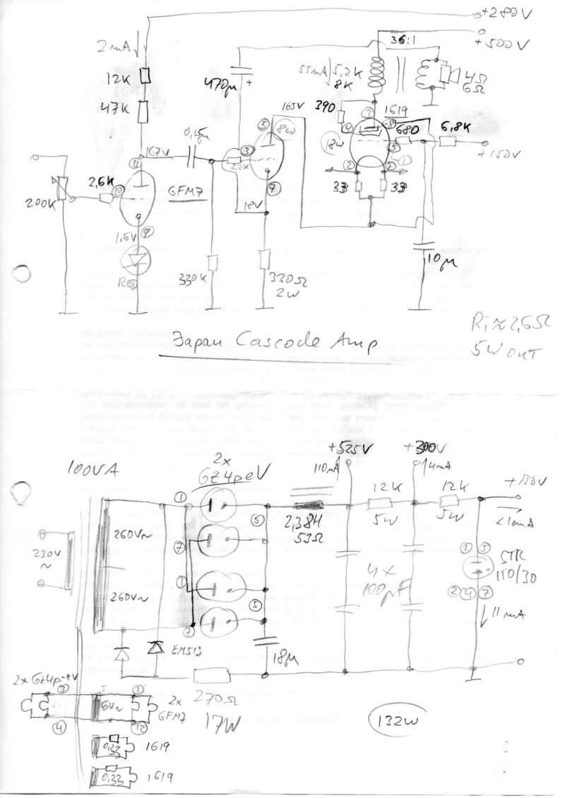

I prototyped it nontheless, but with much much cheaper tubes:
6FM7 dissimilar triode instead of 50C-A10
1619 DHT triode connected
6z4p hybrid rectifiers
And yes, it is kind of an effects box, THD 2.5% at 1W, 4.5% at 5W.
